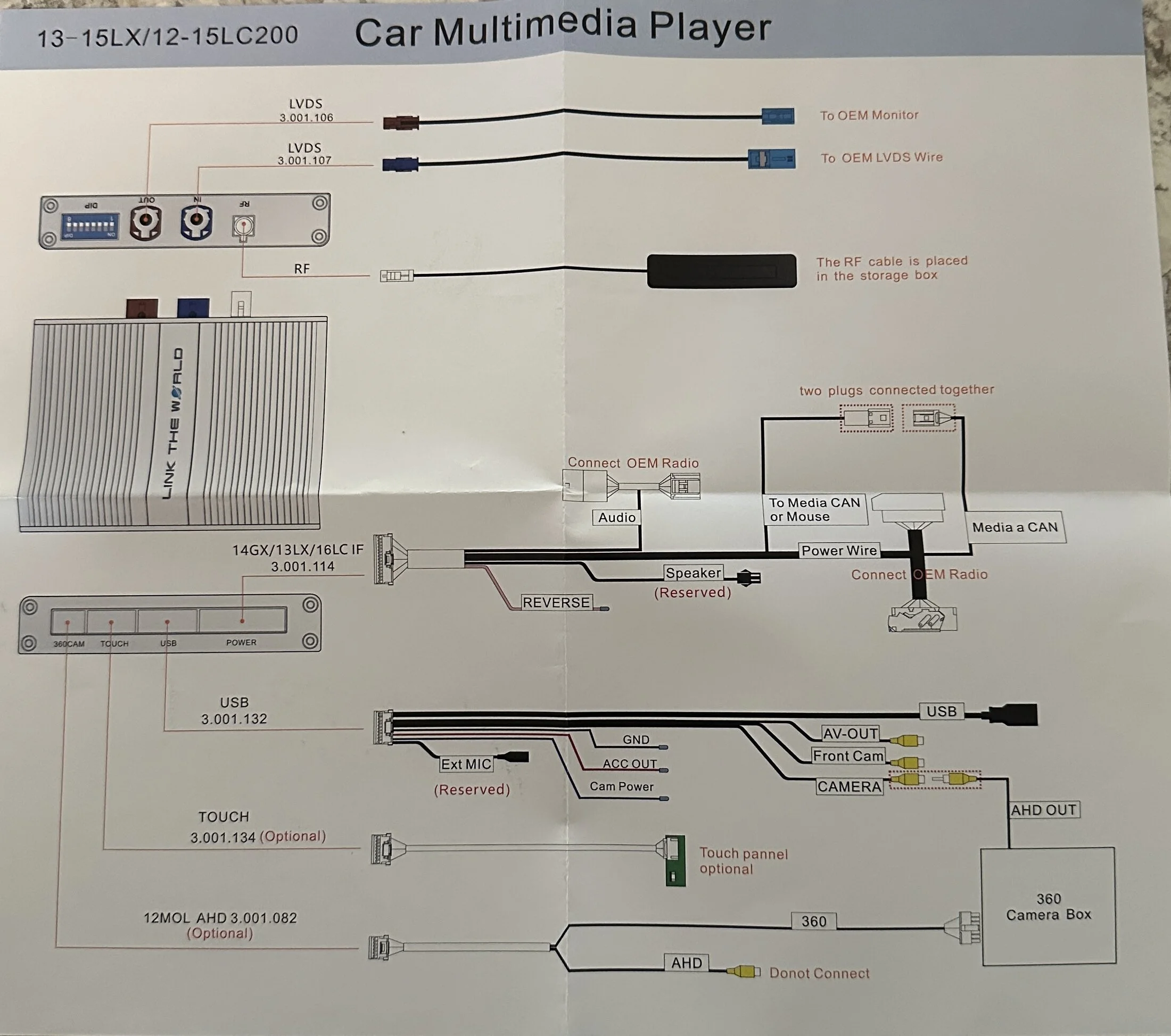

Here's a picture of the diagram included with this kit.
I watched the 16+ vid and perhaps I missed it, but did not see where they landed the Reverse wire. Perhaps it's not needed for this installation. Will be interested to see how it goes for you.
