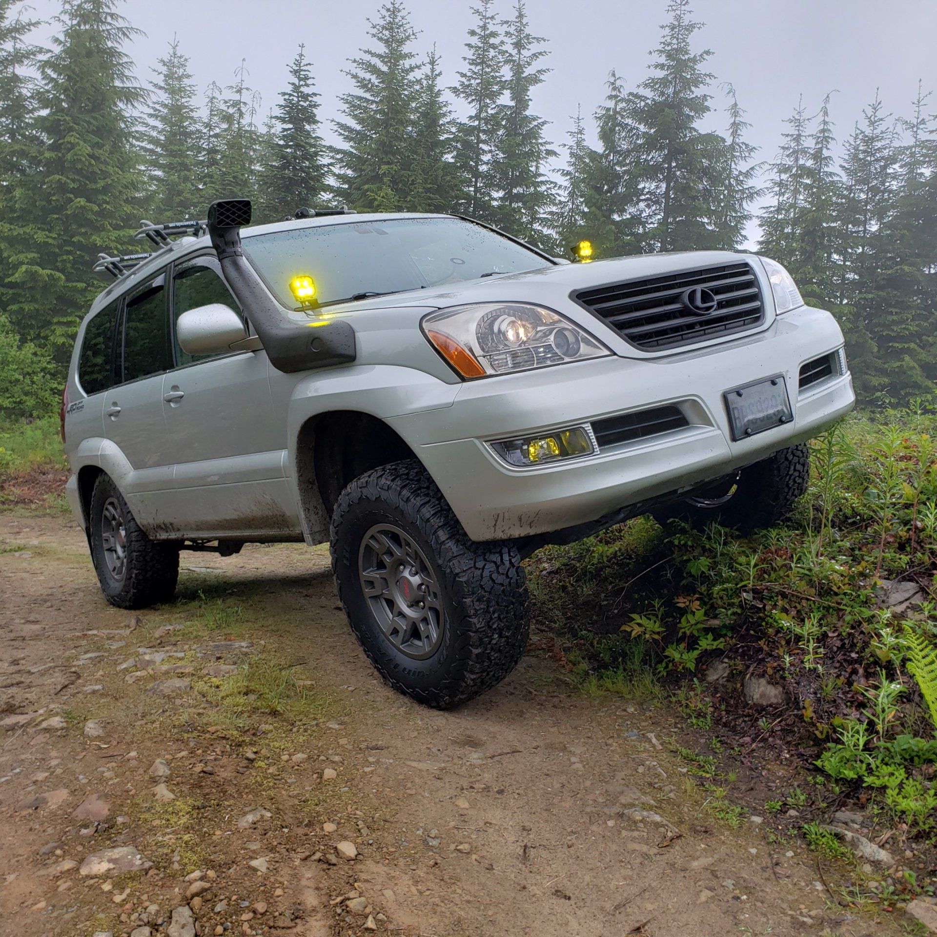

Been running All Dogs medium kit w/5100s and SPC uca's for a year now, great option.
Been running All Dogs medium kit w/5100s and SPC uca's for a year now, great option.View attachment 2648104
Any details like hub to fender before and after? What circlip you are on? Added weight? Ride quality? You know...the drill down if you have the info.
