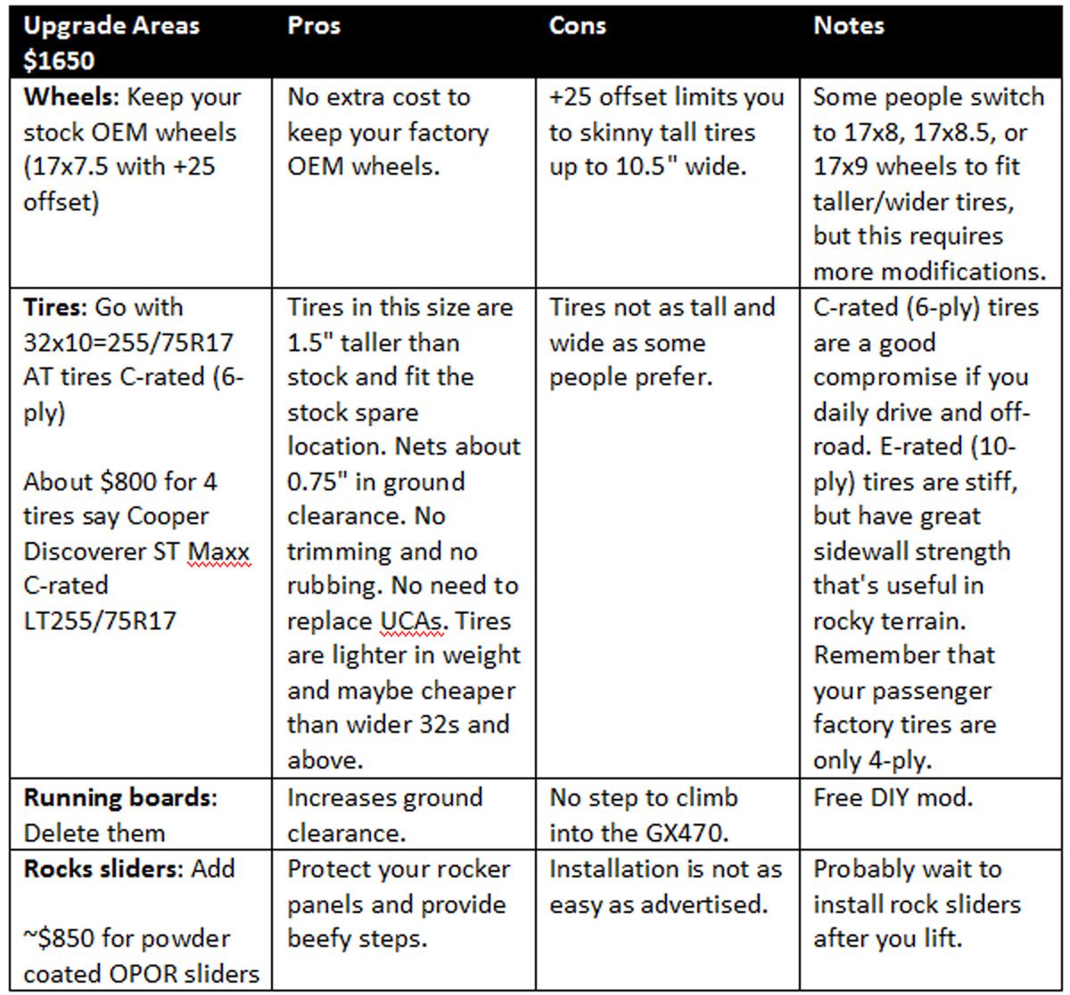

You just got your GX470 and want to do a mild build to improve looks and off-road capability. You want to stand out over the mall cruisers and soccer moms, but want to keep costs under control. This primer doesn't consider any other repairs or basic maintenance your GX470 needs.
First, lets take a look at the wheels, tires, and rocks sliders to start your ideal mild-build and keep costs down. The brands specified here are just examples of what you can get for those estimated prices as of 4/2018. You can always use your favorite brands and remember that prices continue to change over time.

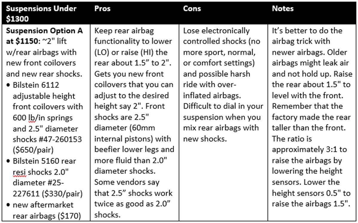

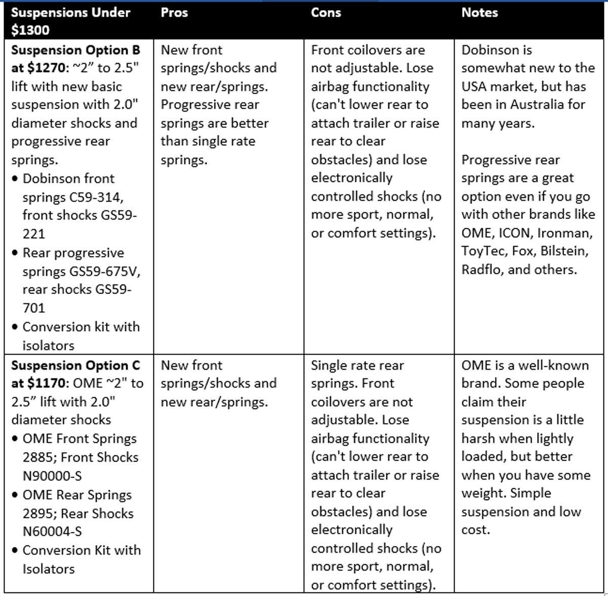

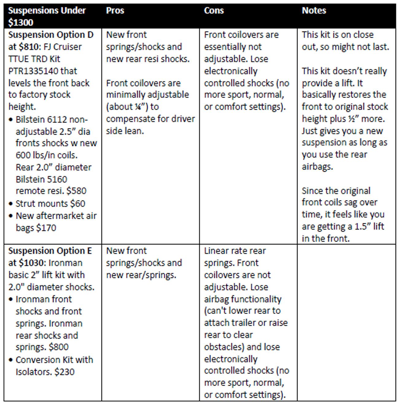

So far, you have only spent about $1650 (or less if you got cheaper tires and skipped the rock sliders), but you have no lift and you really want a lift.
Unfortunately, the suspension is the most difficult component to replace and satisfy your personal needs (like the weight you carry, the desired height of the lift, the softness or stiffness of the ride, the price, the brand, etc.).
Some key factors in the suspension components include the diameter of the shocks (2.0" vs 2.5"), the desired lift (say 2.0", 2.5", or 3.0"), the length of the shocks (standard or long/extended), and the spring rate (linear, variable/progressive, heavy load, etc).
Keep in mind that most low-cost options use the 2.0" diameter shocks which are considered not as good as the 2.5" diameter shocks. The difference is that the 2.5" diameter shocks have more fluid to prevent shock fade in serious washboard roads or long desert runs. They also have beefier lower legs (shafts) that make the shocks more sturdy.
Also, rear variable rate springs are considered better than single rate springs because they provide a better ride when lightly loaded and when fully loaded. Most people have reported great results with variable rate rear springs over single rate springs.
Here are some low-cost suspension options to consider. Again, the brands used in this table are to show options in these estimated price ranges. You can always use your favorite brands. Assuming no extra weight in the front or rear (no bumpers, winches, tire carriers, RTT, etc.). Consult with your favorite vendor to confirm the lift heights, part numbers, prices, etc.

@HomersCanyonero this is such a great resource! I have a question for you (or the thread). Your table mentions an alternative tire size of 255/75R17. I compared stock tire size (265/65R17) to this alternative and note there are some changes in dimensions by more than 3% from stock. Based on conversations with some tire shops near me, they suggest (some will flat-out say they can't install) not going beyond a 1% difference in tire size from stock.
How much will this affect handling and on-road safety? Has anyone installed this 255/75R17 on their (stock) GX470?
By no means am I argumentative; only a noob trying to understand the effect(s) of changing tire size.
Thanks for the feedback and education!
This is what I generated on a tire size comparison tool:
I think the intent is to offer a stockish size tire option that is taller, which improves off road capability. Things are improved such as ground clearance, and more flexibility in a side wall.
If you are concerned with on road handling and on road safety, then I think you would want to stick a LT passenger tire in the stock size.

@wrcfan is right. The idea of the 255/75R17 tire is to give you a skinny taller tire that’s more off-road capable without having to change your wheels, without rubbing, and allowing you fit a full spare in the stock location.
If you were to go with an AT 255/75R17 tire in “E” load rating = 10-ply, this tire would be great for rocky off-road dirt roads but it would be a stiff tire on city driving.
A compromise is to get a C rated tire which is equivalent to a 6-ply tire. Passenger tires are 4-ply.
So, there are other factors besides size that will impact how stiff the tire is (load rating), how noisy (mud terrains?), thus how off-road capable.
