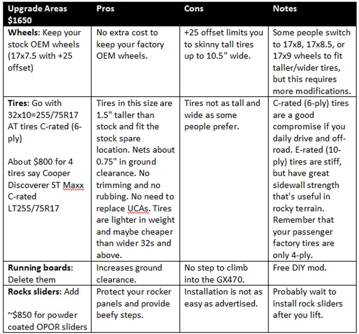

First, lets take a look at the wheels, tires, and rocks sliders to start your ideal mild-build and keep costs down. The brands specified here are just examples of what you can get for those estimated prices as of 4/2018. You can always use your favorite brands and remember that prices continue to change over time.
1676018
So far, you have only spent about $1650 (or less if you got cheaper tires and skipped the rock sliders), but you have no lift and you really want a lift.

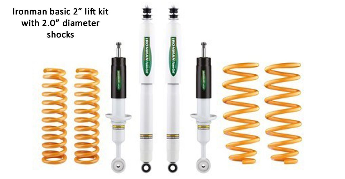

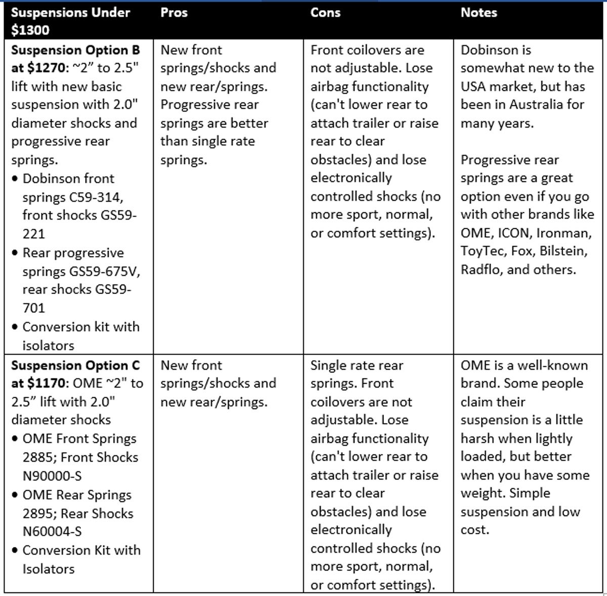

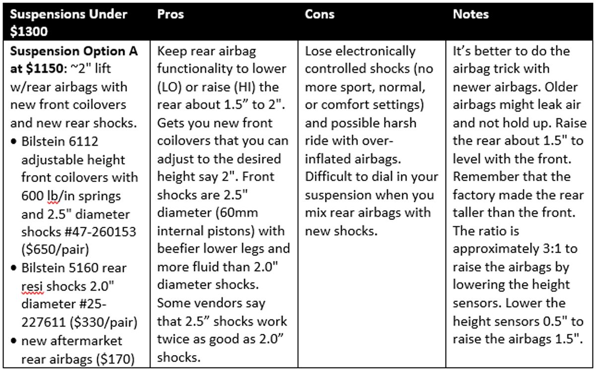

Here are some low-cost suspension options to consider. Again, the brands used in this table are to show options in these estimated price ranges. You can always use your favorite brands. Assuming no extra weight in the front or rear (no bumpers, winches, tire carriers, RTT, etc.). Consult with your favorite vendor to confirm the lift heights, part numbers, prices, etc.
1715167

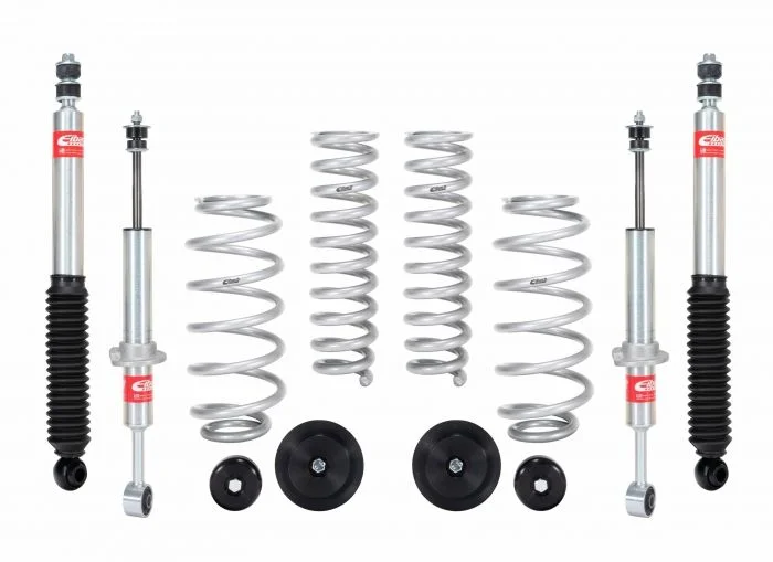

1677265
If anyone else wants to contribute alternate suspensions, please use this format and include brand, part numbers, estimated prices, pros, cons, and notes. Corrections and improvements are welcome.

Great info! Thanks for taking the time to do that. The factory wheels are +20 offset though, I believe. -25 would be a very deep dish wheel.
Arghh, yeah the factory wheels are +25 offset. Not negative 25.
Good idea on the Wiki. I'll do that soon. Let me just get some feedback here to correct the mistakes.

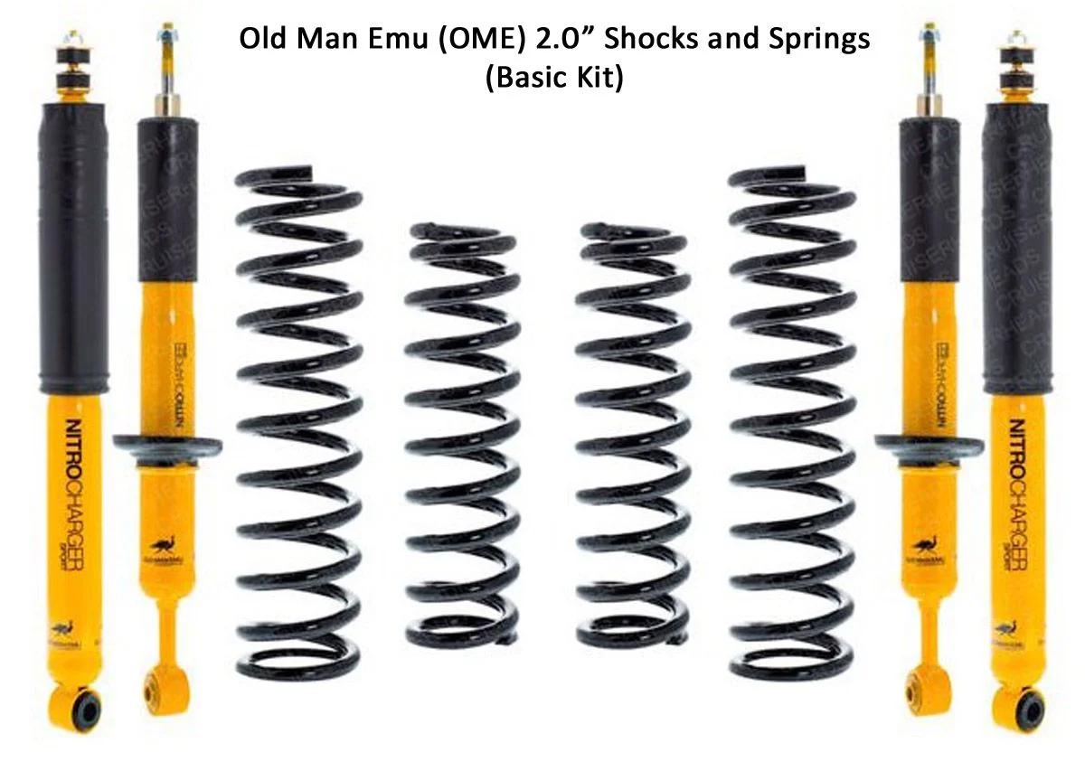

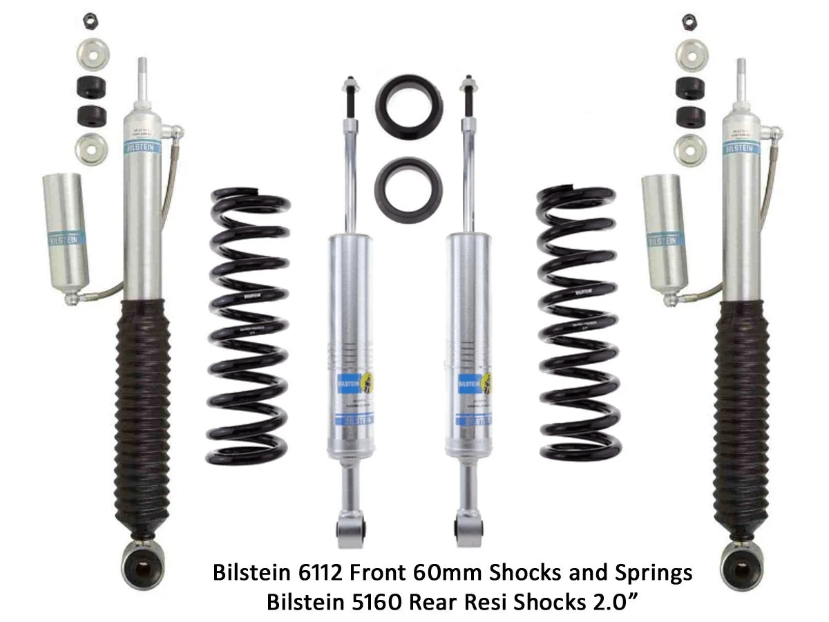

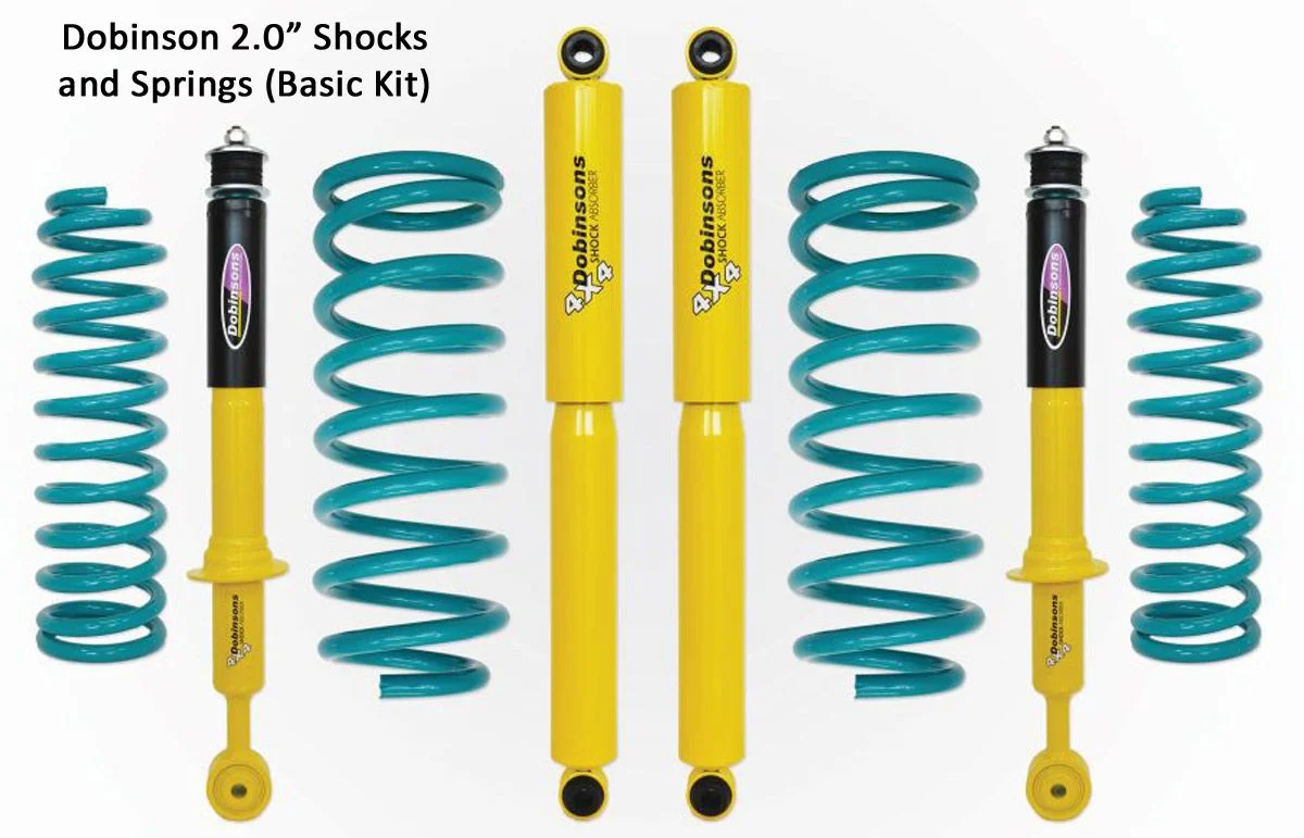

Visual aids for the low-cost suspensions.
Metaltech is having Foam Cell Pros kit on sale for $1044 with free shipping from 4/14 till 4/17. Too bad the individual kit are not on sale. I would like to get progressive spring in the rear.

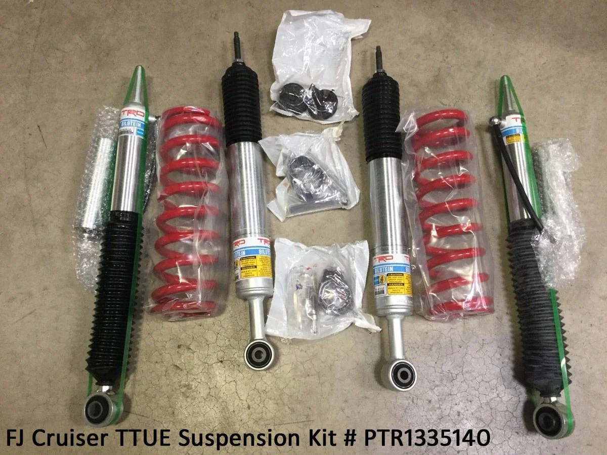

@pillguy some Toyota dealers are getting rid of their bilstein 6112 front 2.5” shocks non-adjustable with TRD springs and rear bilstein 5160 resi 2.0” shocks (no rear springs) for $700. Apparently Toyota is moving to Fox shocks for their TRD suspensions and putting the bilsteins on clearance

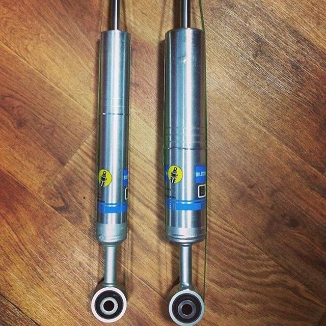

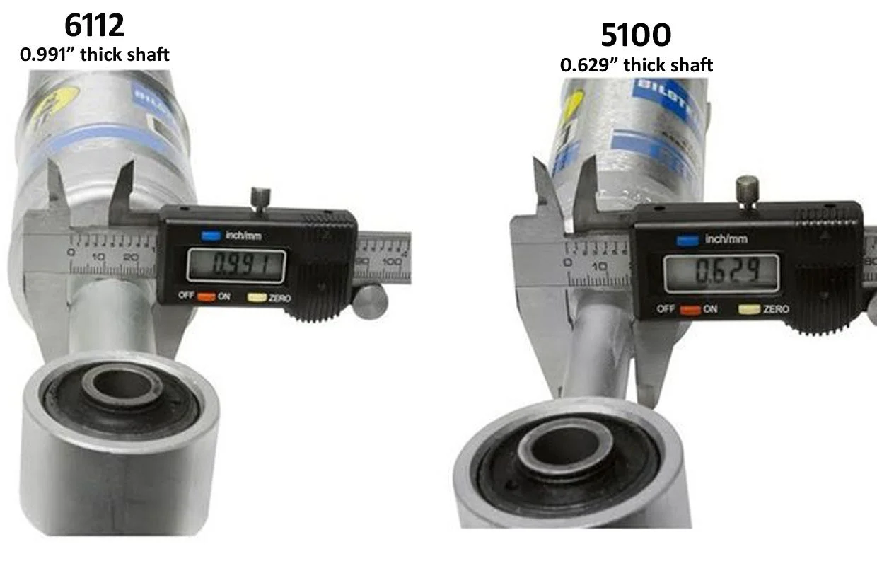

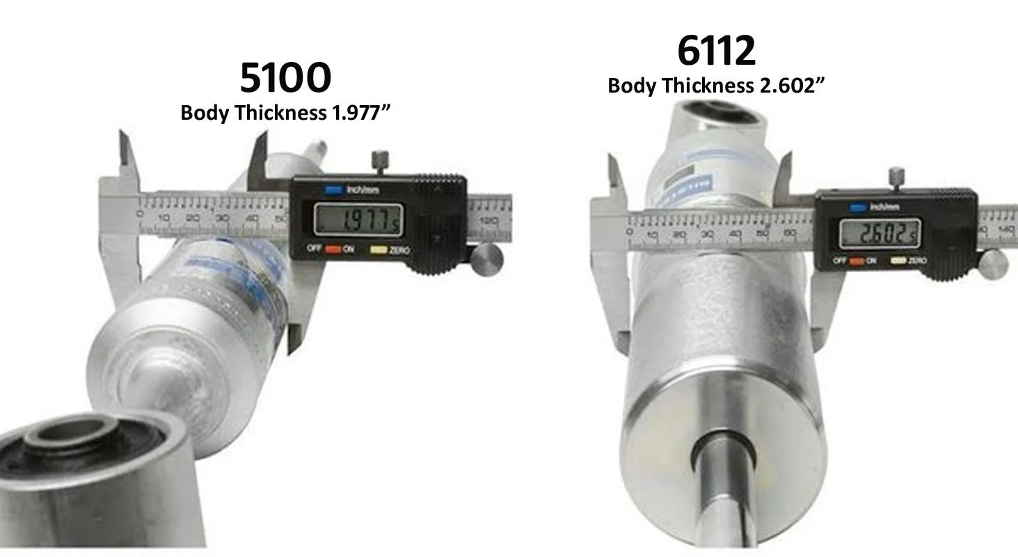

Here's a 2.5" diameter shock compared to a 2.0" diameter shock from Bilstein
Here are the two shocks compared side by side
@pillguy some Toyota dealers are getting rid of their bilstein 6112 front 2.5” shocks non-adjustable with TRD springs and rear bilstein 5160 resi 2.0” shocks (no rear springs) for $700. Apparently Toyota is moving to Fox shocks for their TRD suspensions and putting the bilsteins on clearance[/QUOTE]
Is there a part # for that kit? Know which dealers have that stuff on clearance? Thanks!
@Docwyte The first I heard about this clearance sale on this Bilstein/TRD spring kit was from @joabmc in this thread Coil over inquiries... toytek's specifically (for starters, but plz expand)
He posted a link to this kit, but it's no longer available at that site. I don't have any other info on dealers or vendors who have this kit on clearance: SUSPENSION KIT; Part Number: PTR1335140; TRD: TRD; Link: PTR1335140 - Suspension Kit. TRD, PSuspension, Chassis - Genuine Toyota Accessory
And @half k cruiser did more research and found this information on this kit:
"For those asking about the TTUE suspension that is currently on closeout, here's what I've managed to come up with.
1) These coils are designed to lift an FJ 1'' in the front to level it out
2) They are Eibach springs with 600lbs rate
3) The 6112 in this kit is only minimally adjustable to account for DS vs PS lean
So its hard to say what if any lift you get on a GX with these. If someone has the factory numbers for the GX front coils (free height, spring rate, wire diameter) we could compare them. Also, would an FJ rear coil, coupled with this kit, make for a level truck ? Hard to say as I don't believe any GX owners are running it yet."

Looks like the Trail Teams suspension is not available from many vendors, based on a google search on the part number. You may have some luck calling up your local dealers, though. Still on ebay for much less than you mentioned.
I can add to cart on this site- but don't know how much I trust it.
