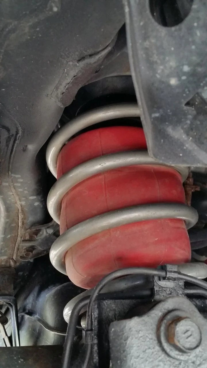

this is what iv got on mine ... you can hook them up to the original air system but is kinda tricky (have to trick the height sensor) or just run a line straight to the bag and fill them when you need them like most do on a pickup ... thats what ill do ... your bump stop needs to be trimmed a bit and some of the lower hardware needs to be mounted a lil different
How to you hook it up to the original compressor?
If you can disconnect the original system from the vehicle with out breaking it ... one of the "airlift" (brand name) hose connectors fits the original air line and you can splice that into the "airlift" bag so that the factory pump will fill the bags to level out the vehicle ... being that if your doing a conversion your probly also lifting the vehicle so you will have to trick the height sensor to make it think your still at factory height ... I bought this set up used from Kevin at SSS and thats how he had it set up before going with long travel ... only problem he found was when off road having air in the bags made the ride stiffer than he would have liked ... so i opted not to do that plus its easier to run direct lines to level the vehicle with an air pump ... oh and the air line can run down through the center hole of the bump stop ....hope this helps
