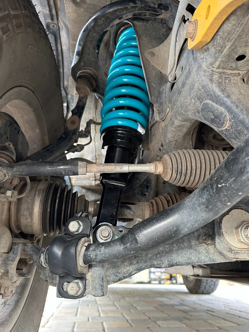

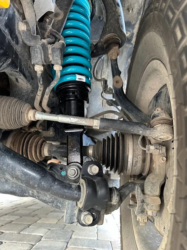

He makes slotted brackets that do alleviate some of the angle. I don't have the plates yet - but here are some pictures from when I installed them so you can compare. It's roughly a 2inch lift. I also have a slight clunk I'm trying to diagnose, but it was dead quiet when I first installed the suspension. Probably due to the few trips I had in between then and now.
View attachment 3695108View attachment 3695114
Yes ours was dead quiet when first installed lift too. Then some maybe 5k or 10k miles later started to notice the clunk sound. But I think it started to happen after one day where I went over a dip too fast and suspension maybe bottomed out. I don't know.
Yeah I would begin with the sway bar mounting points. I reset mine yesterday, by loosening all of the mounting bolts, and moving the suspension around. Make sure the front pistons are pushed all the way into the flanges on the swaybar, toward the center of the vehicle, and retightening everything to spec after you've gotten the vehicle level. That seems to have removed some of the noise for now. I would also consider the brackets and collars from Dr. KDSS.
