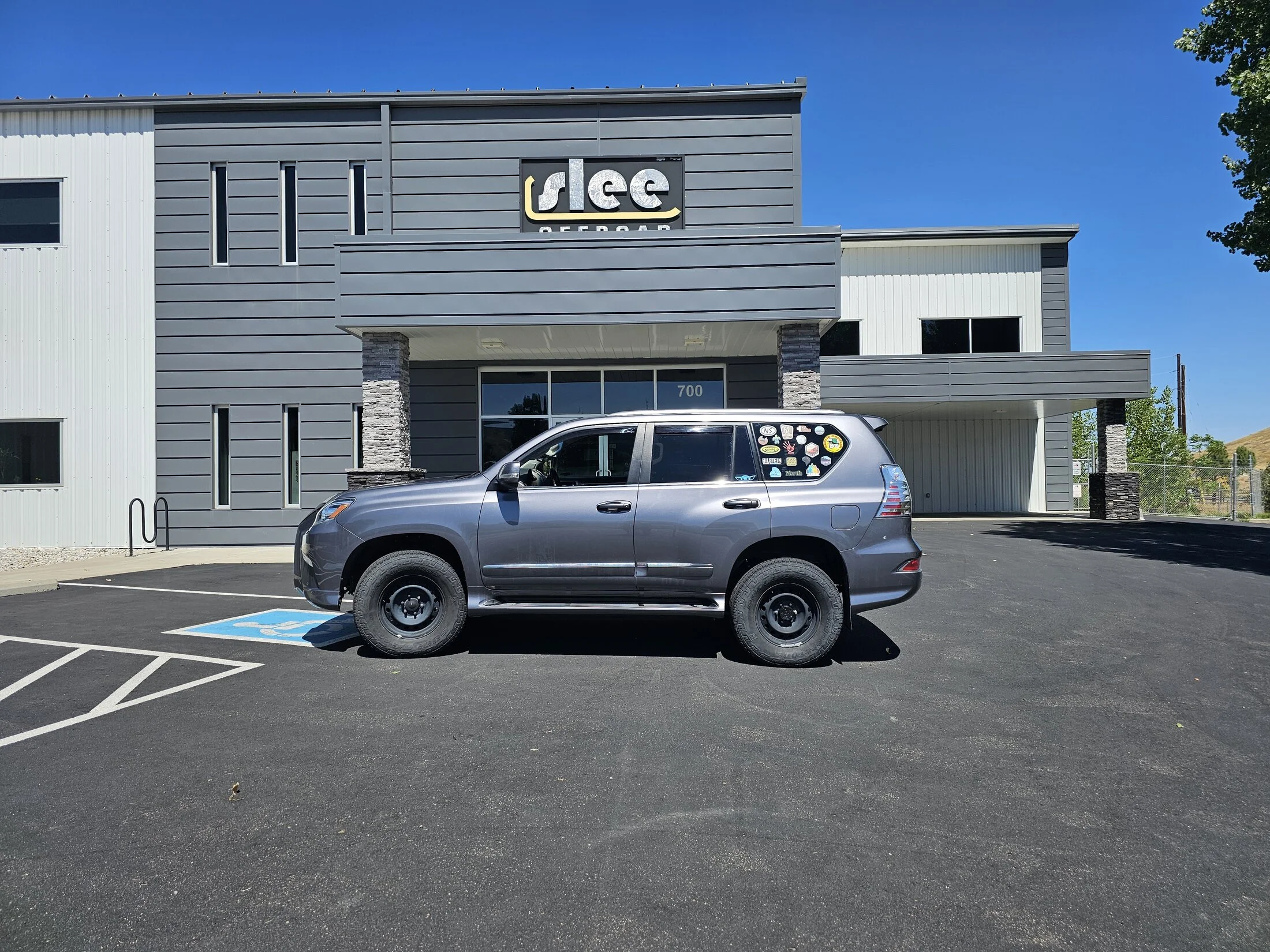

Update to the thread/build. I decided to go with the Fox Factory Series 2.5 Rear Shocks with a custom tune from AccuTune. Still undecided as to what setup to run in the front, mainly because there are so many UCA options out there, but will likely end up with the Fox 2.5 Coilovers up front, or something comparable from King or Icon, with 1 inch of lift to level the car out.
JBA upper control arms will look nice with the silver ICON shocks, since they are red. They are also USA-made, not terribly expensive, and use off-the-shelf bushings and ball joints so you can service them in the future.
I'd recommend them if you are piecing a lift together as opposed to buying a complete bundled kit.
I have the Fox PES 2.5 front and rear, tuned by AccuTune with Icon delta joint UCAs and Icon overland rear springs. I’m at 2.5” up front, 1” rear. It’s a little nose high, but I have some weight to add up front that should level it out.
Hello again - thought I would update as the build is progressing. The Fox Factory 2.5 w/ res. have been installed in the rear, and they feel amazing. Not sure if that's just because the shocks on it had 140k miles or because these shocks really are that great but I love them so far. The car no longer "shudders" for lack of better word when whacking potholes and feels very stable. I have decided to go with SPC UCA's and the Fox 2.5's up front, I just need to figure out exactly how much lift is needed in the front end to level the vehicle out. I do plan on putting a bumper on this eventually so I don't mind if it sits a little nose high for a while. I feel like 1.75 inch lift in the front paired with no lift in the rear should be a good starting point... If anyone knows the exact front lift amount needed to level these 1st gen GX460's please let me know :) Cheers!
I did 1.75 up front and 1.5 in back. It still flexs nice, no kdss lean. I can stuff every corner on a trail with 33s, hence why i am so eager to move up to gain a touch more clearance for my trucks fat ass.
Not totally sure, but your front coil overs should be adjustable and if you have a shop install them, they will level out the suspension, or as you mentioned, if you ask them, they'll leave a little lift in the front.
