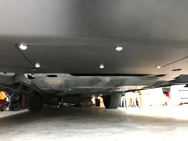

You can just pickup the front Budbuilt skid for $323. It will coexist with the factory mid but it leaves that gap as seen in my pictures.

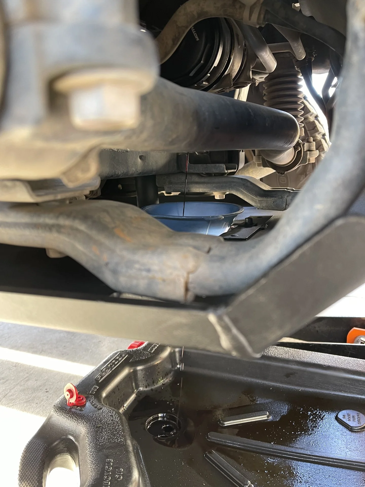

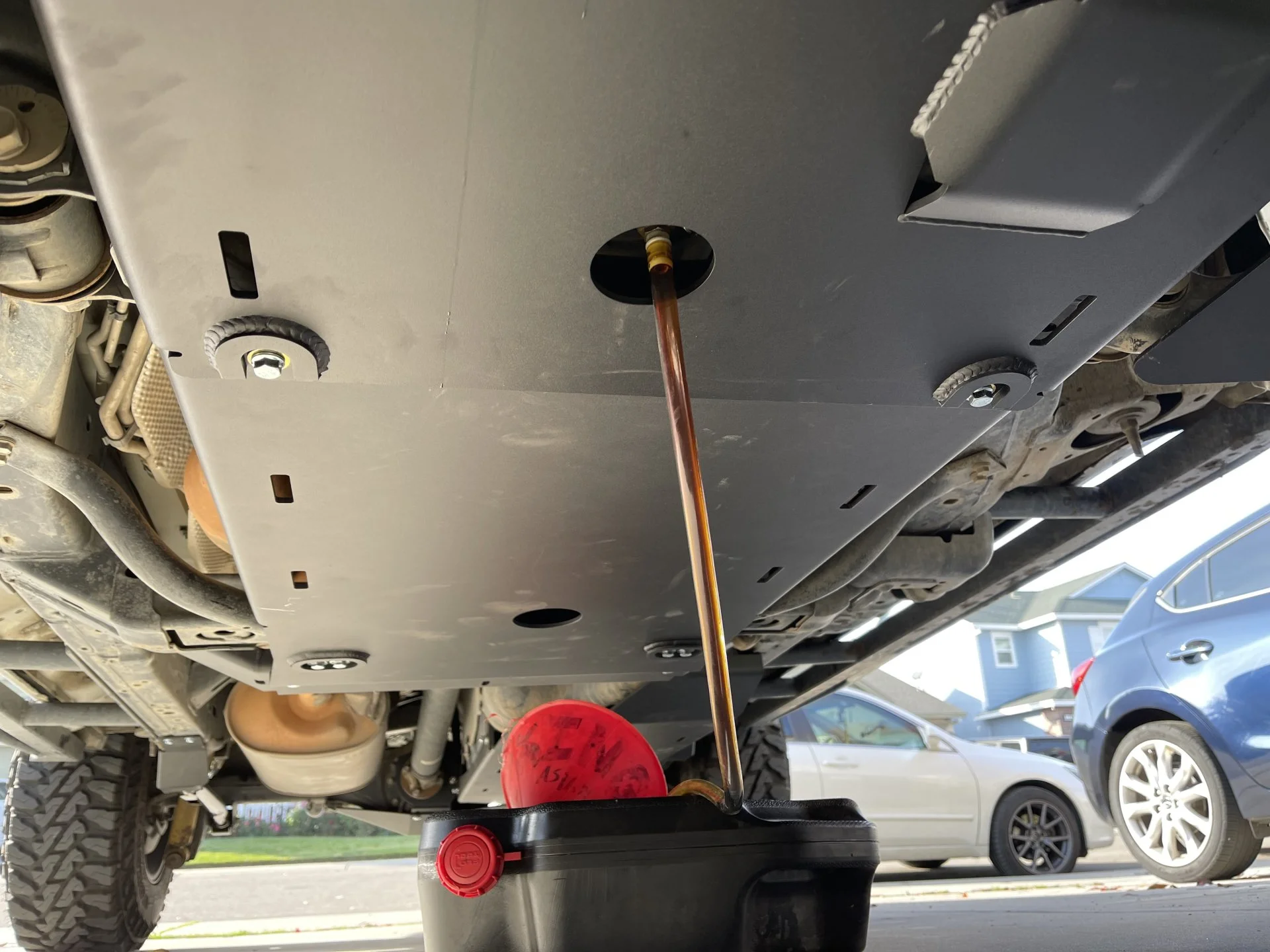

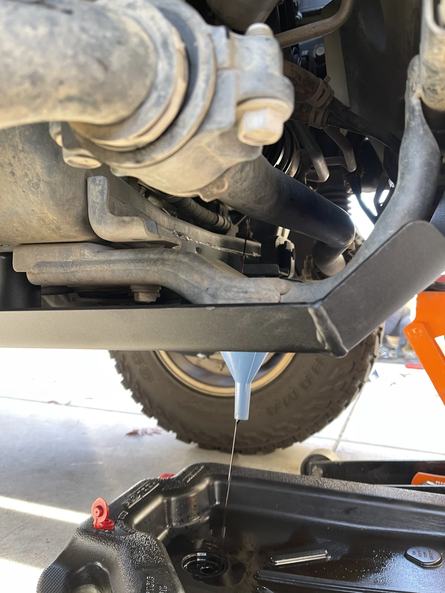

I find that oil changes on the RCI skids are doable without taking the skid off, but require the right tools and patience.
1. Enough 3/8" extensions to reach the Oil Filter removal tool from the passenger wheel side.
2. Small enough funnel to manipulate through the small removable panel on the skid.
3. Patience when opening the filter housing to slowly let out the oil to prevent a mess.
4. Fumoto valve for oil pan for ease of oil draining.

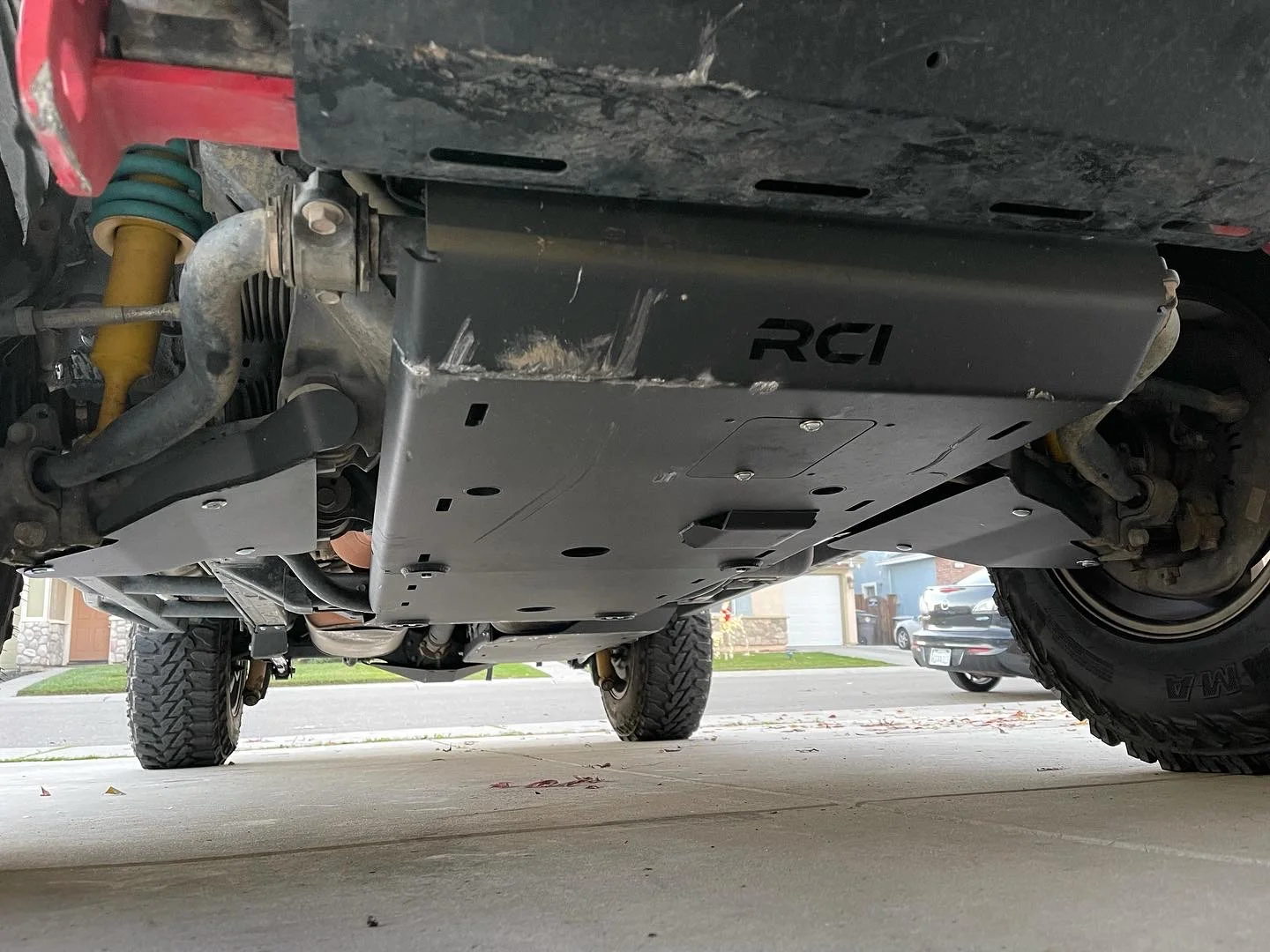

Nicely done! Question re your RCI front skid. What space do you have between the sway bar and the skid? Wondering if the install of a KDSS spacer (e.g. from Treaty Oak) would drop the bar low enough to make contact with the skid?
I'm going to be installing the same spacers. Looks like they'll fit without an issue.

This is why the forum rocks! For whatever reason, I probably wouldn't have thought of this process. But it's also only 6 bolts to drop the skid, which I did with the OEM one anyway.
