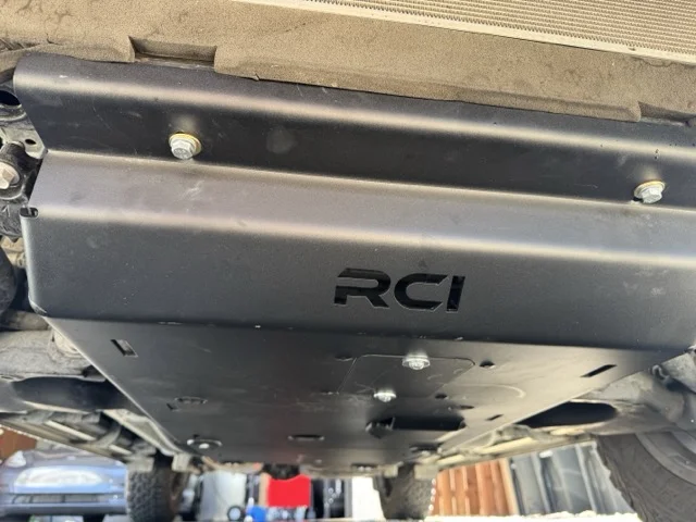

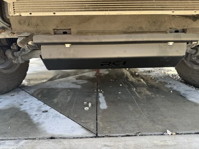

So I got my RCI engine skid on today, and don’t see how this would work with it. Do you have pics of the mounting surface? I may need to drill holes in the filler plate where the front of the RCI skid mounts….
View attachment 3893080View attachment 3893083

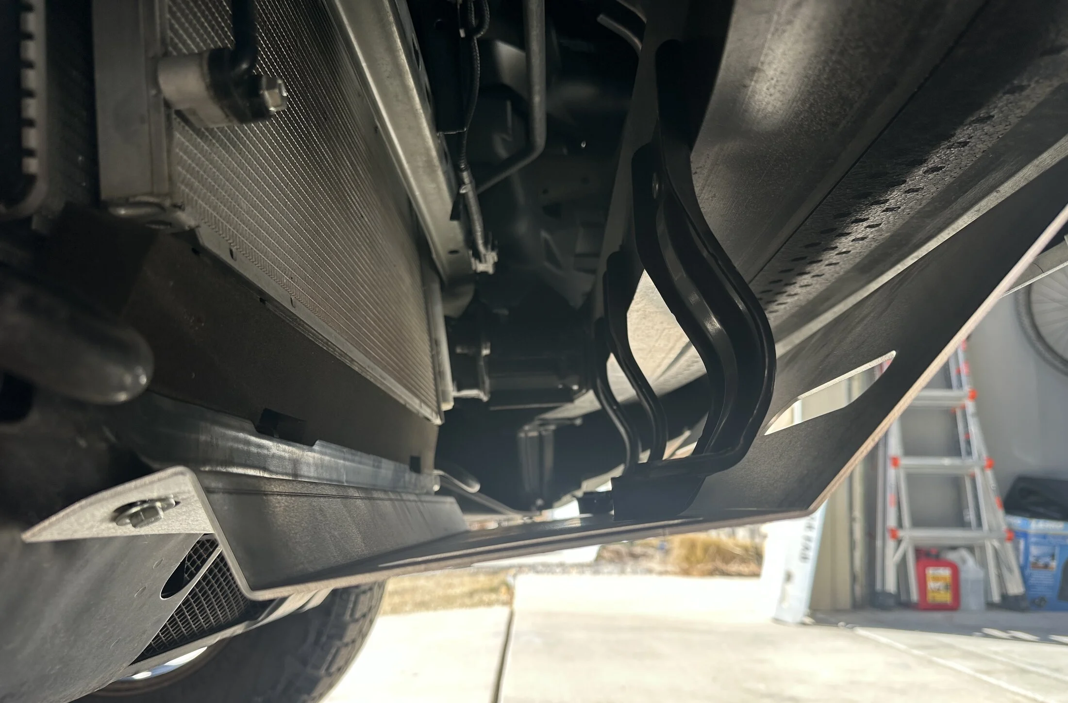

The skid extension was only tested with the stock skid plate.
On the stock skid setup, those 2 mounting points are not used therefore the skid extension can utilize them. It appears that RCI skid adds a lot of bulk to that area unfortunately.

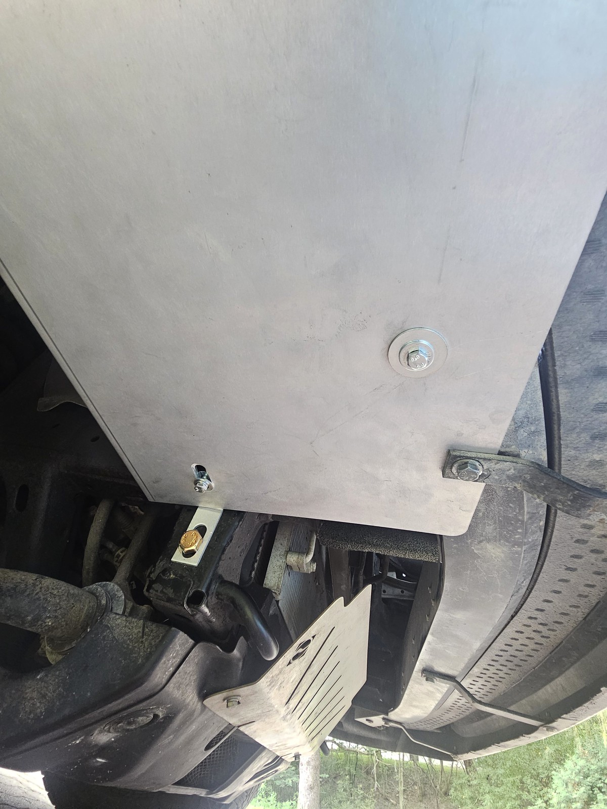

Bump for a great idea and execution. At first I thought the slots were overkill and a bit sloppy, bring some large washers with you LOL. But turns out they were perfect.
I have support brackets on the bumper after the cut so needed to drill a hole for the bracket bolt in the plate. Despite the great scribing job I did, hey I was a machinist mate (propulsion engineer) in the Navy for 20 years, but it wasn't perfect. However the way the slots allow for adjustment it worked out well.
3 point attachment as well now, it isn't going anywhere. In another month I'll be removing them to get undercoating done and depending on the weather then may paint them. Or not, no one is going to see them unless they climb underneath.
