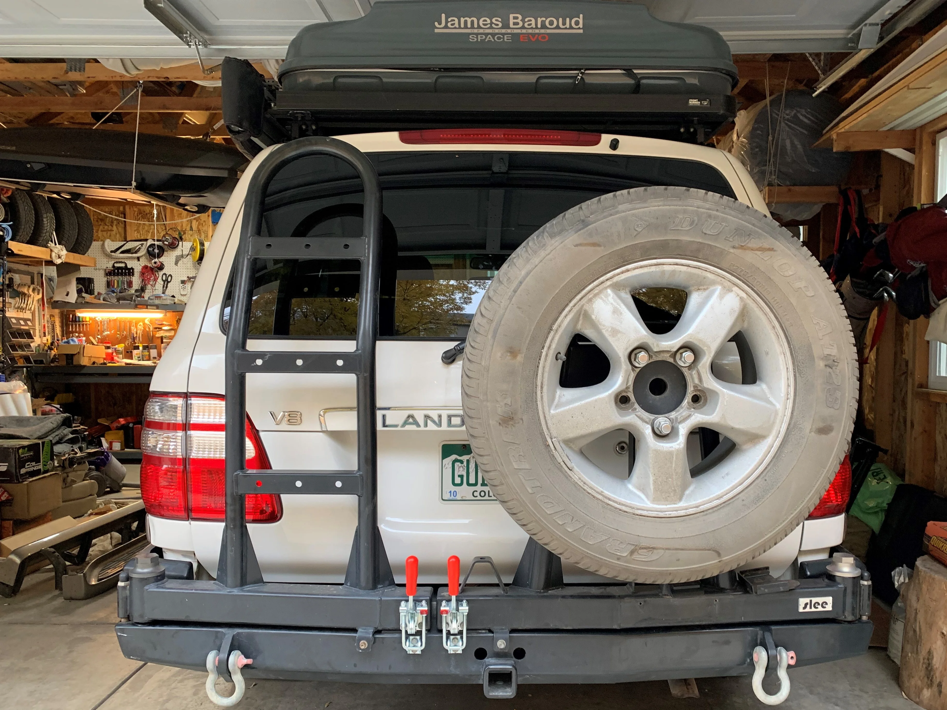

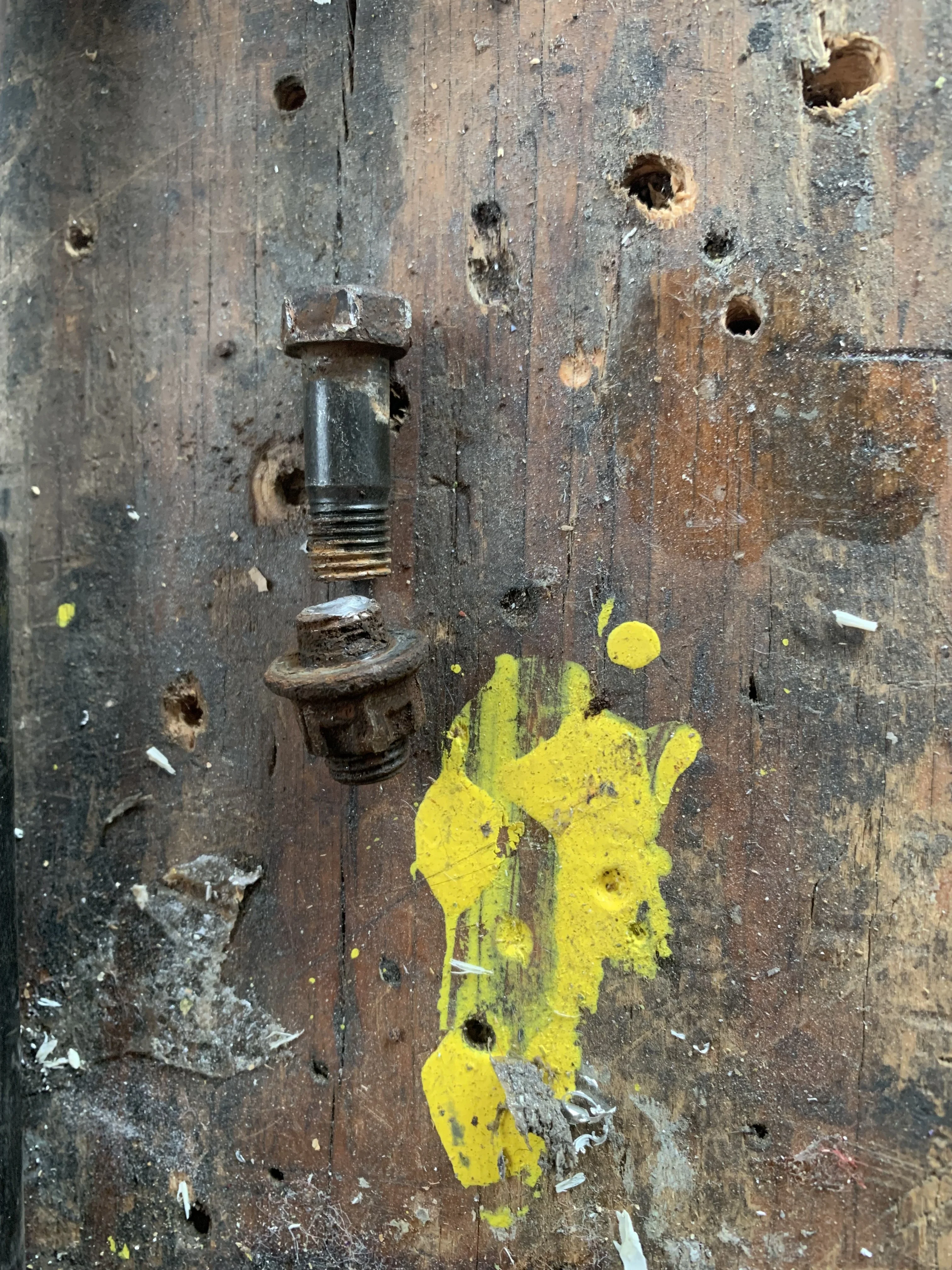

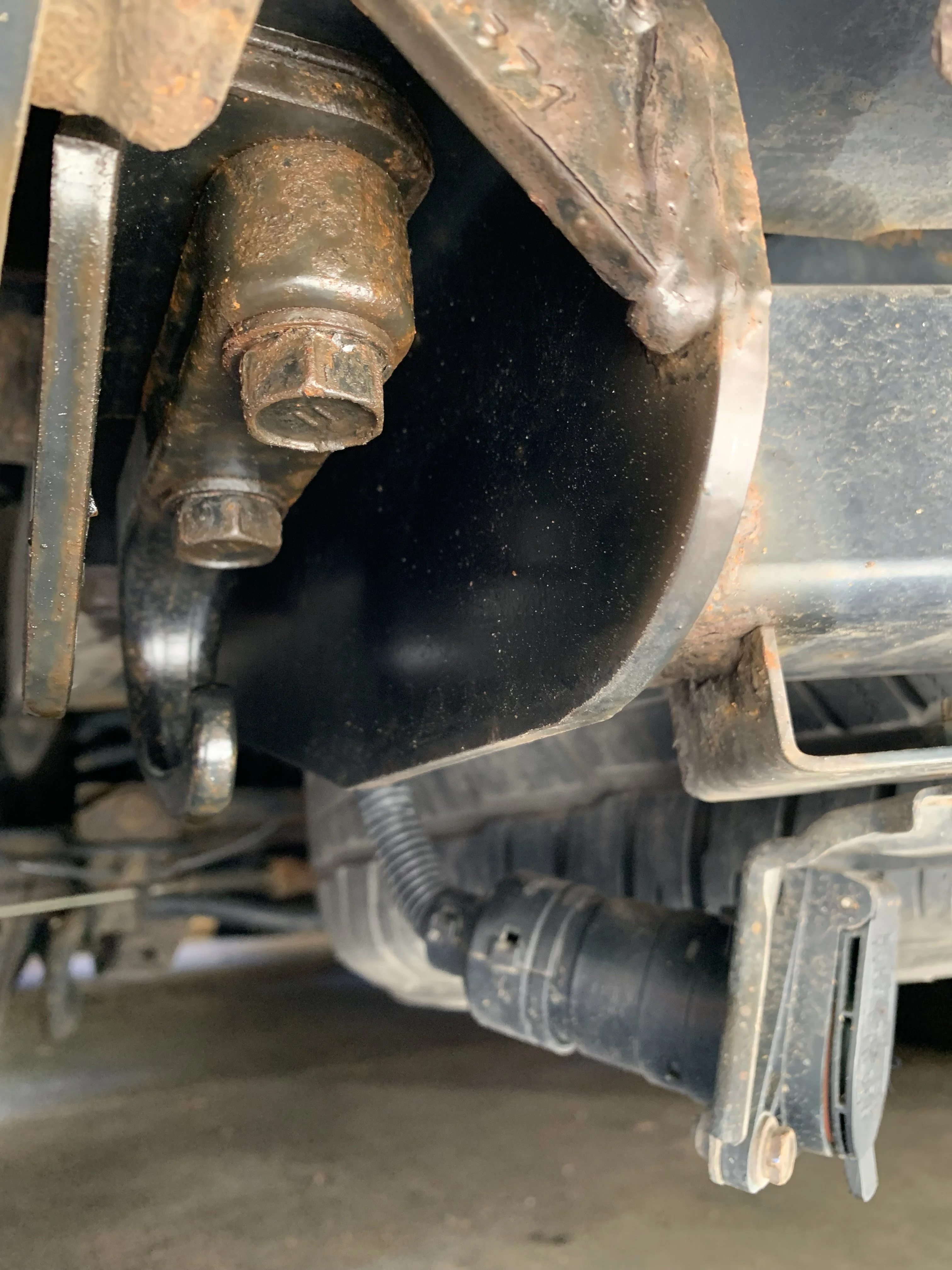

Finally got the Slee rear bumper from GUD2.0 put on. Installing it was a :banana: job. Getting the OEM trailer hitch was a pain. GUD3.0 lived its first few years in the Midwest so there is minor rusting on the underside. It is really hit or miss on which bolts gets stuck. The OEM trailer hitch is held on with 6 x 14mm bolts. Three came off with just a few days soaking in PB Blaster. Next two took a week of spraying with PB Blaster every day and hitting it a few times with a hammer. Last one took a month to get off. Last thing I wanted to do was shear off the bolt or to break the frame weld nut. Wasn't the easiest to access the inside of the frame since the bumper cover can't come off until the trailer hitch is off.
full

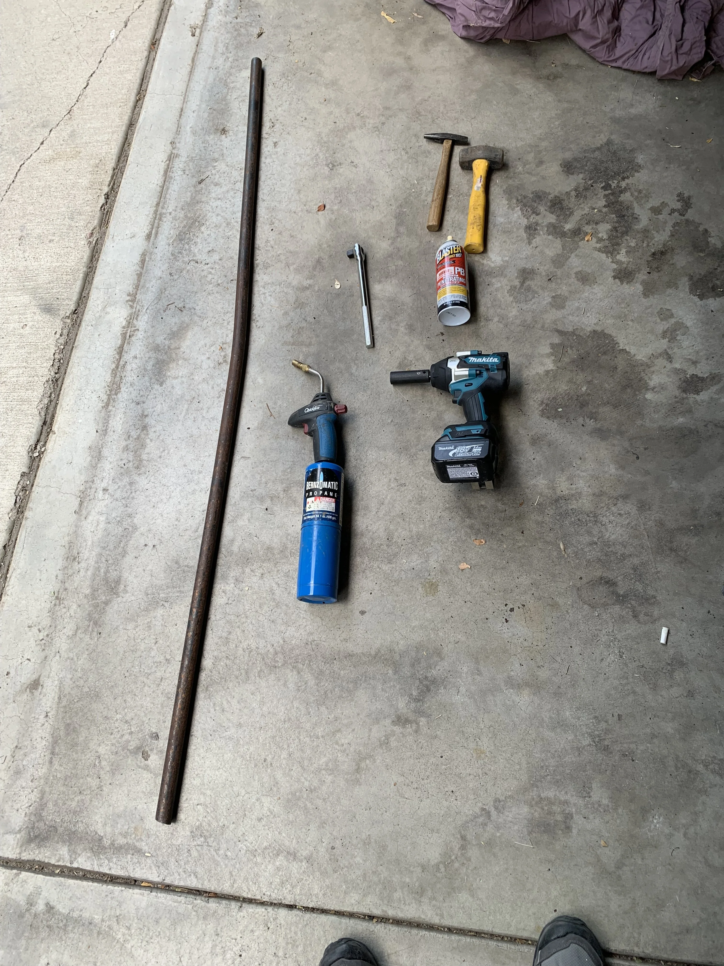

So the process every few days on the last bolt:
- Spray all angle and into the frame holes with PB Blaster
- Wack the head of the bolt a few times with a pin hammer and sledge
- Wack the frame a few times to try and break the rust bond
- Hit it with an impact wrench a few times
- Heat up the bolt with a propane torch for a few minutes and let it cool overnight
- Try a breaker bar with a 5 ft extension
Even bent the extension a bit. With the length of extension you could easily shear the bolt, so actually had to be pretty gentle with it.
full
After a few weeks it finally moved the slightest with the breaker bar. Once everything was off followed all the holes with a tap to be on the safe side. Don't have any pictures of the bumper install. Was actually really easy once everything was off. Slide it on, bolt it up. Replaced all the hardware with new zinc coated Class 10.9. Final step was to install new catch release handles. Old ones were getting a bit nasty.

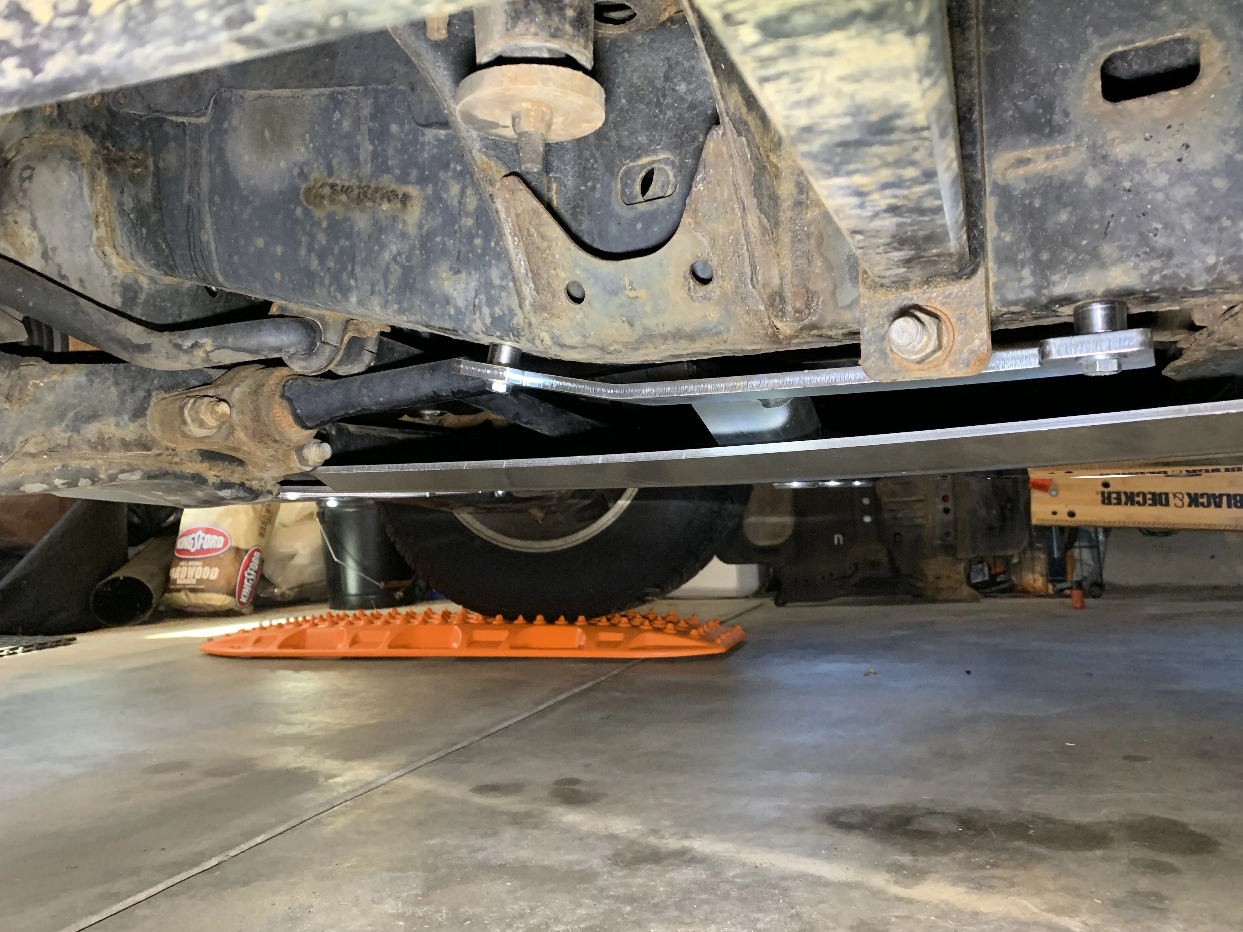

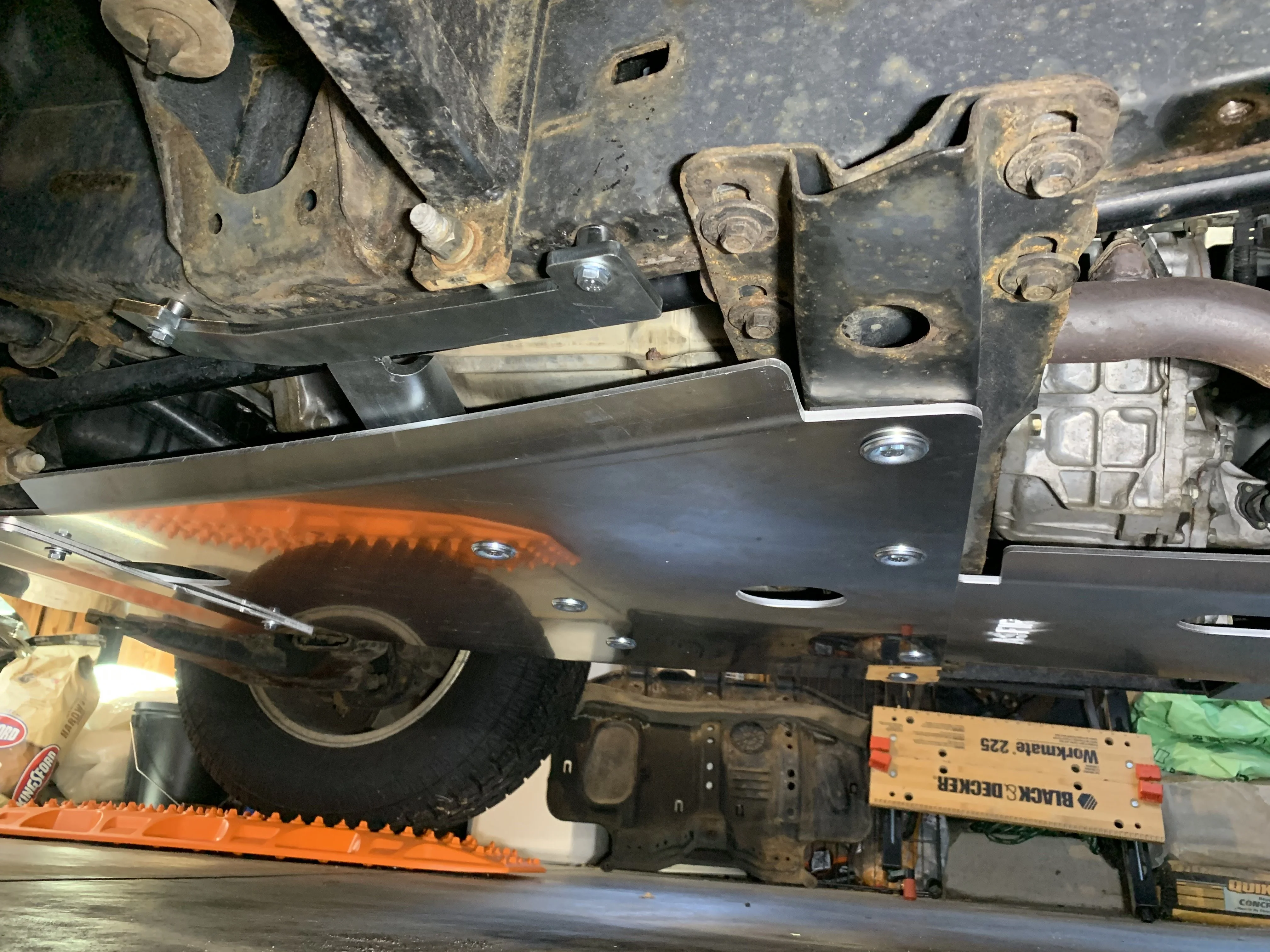

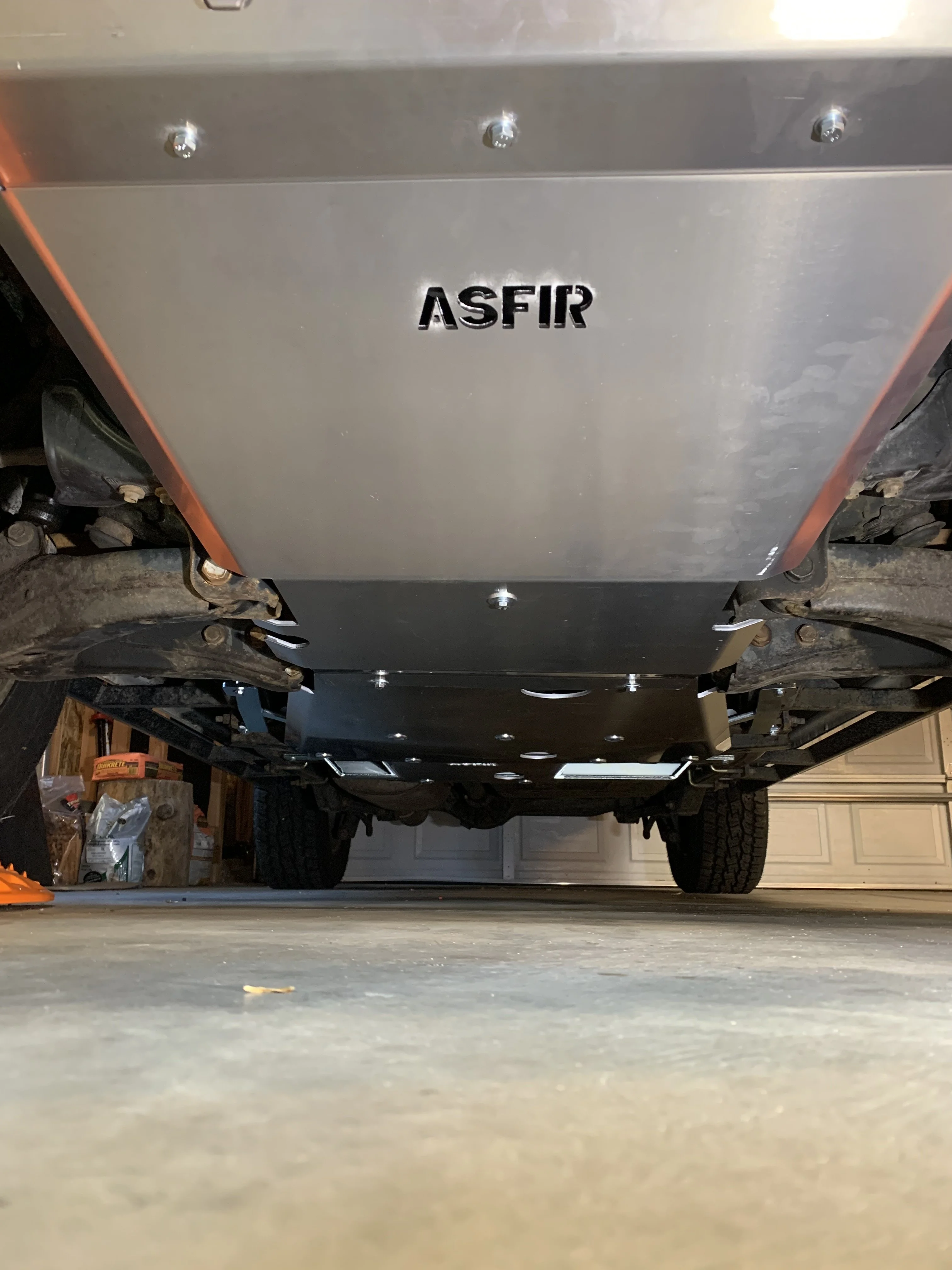

Finally got around to installing a full set of ASFIR aluminum skids on GUD3.0.
The actually install of the skids was pretty easy and I did it as a one person job. Didn't have any of the alignment issues some people are reporting.
ASFIR Skid plates and front bumper - https://forum.ih8mud.com/threads/asfir-skid-plates-and-front-bumper.1101938/

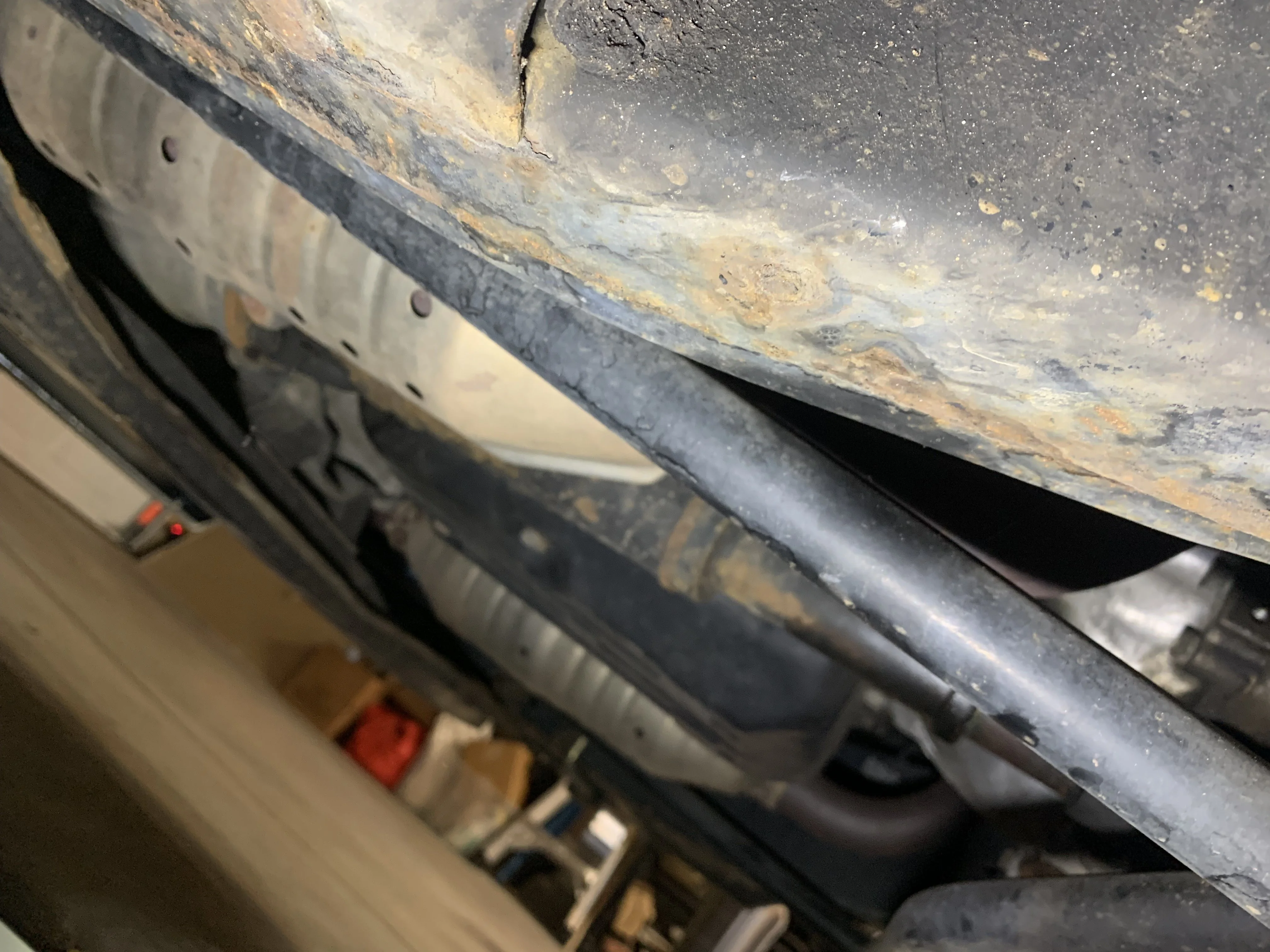

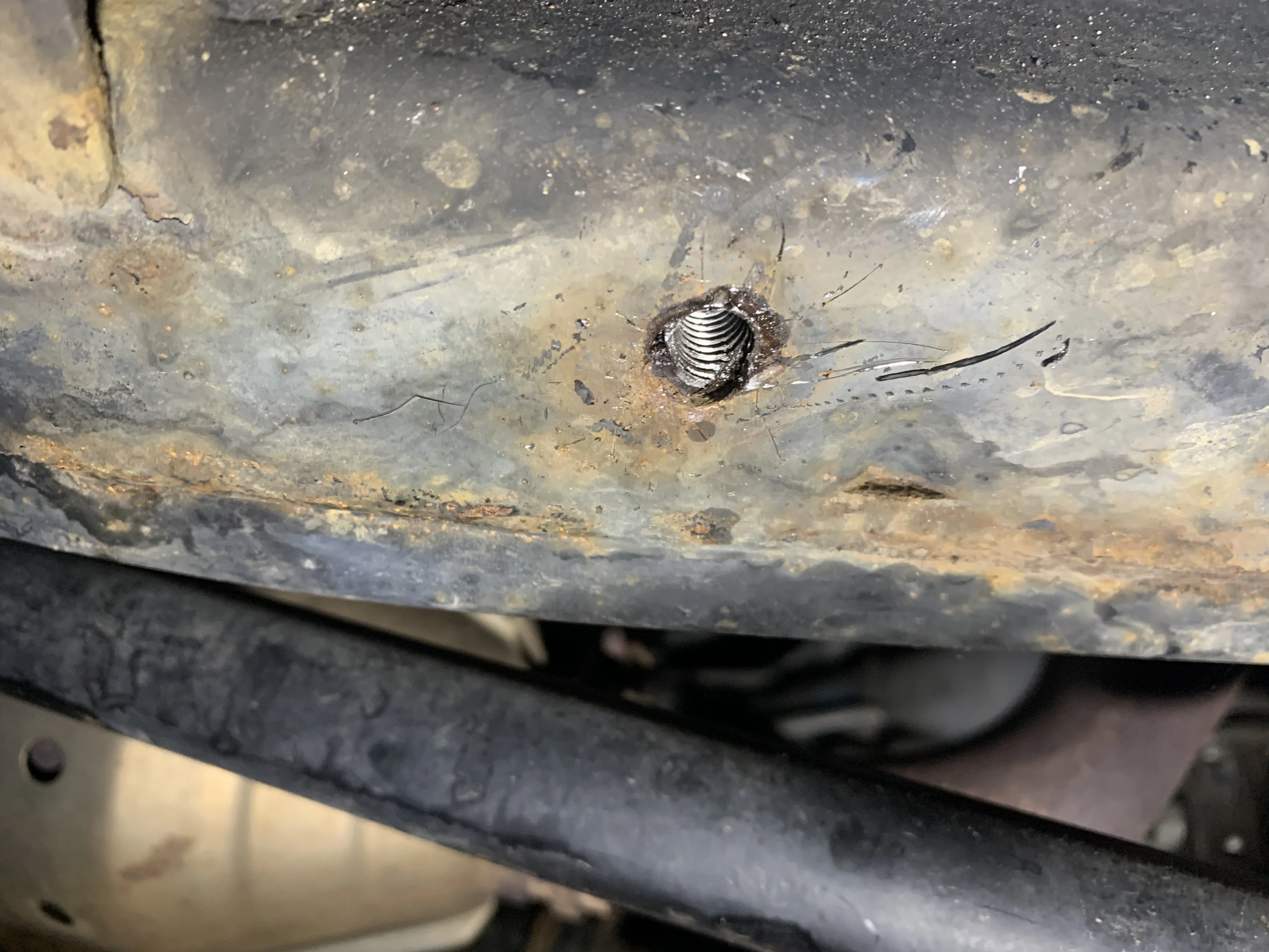

Bigger issue was 3 frame bolts that had sheared off a long time ago and were rusted in. Had to drill those out and re-tap.
full
full
full
full
full
Used some spacers I found at Home Depot on the ASFIR cross member to clear the U-bolts from the WKOR sliders.
full
full

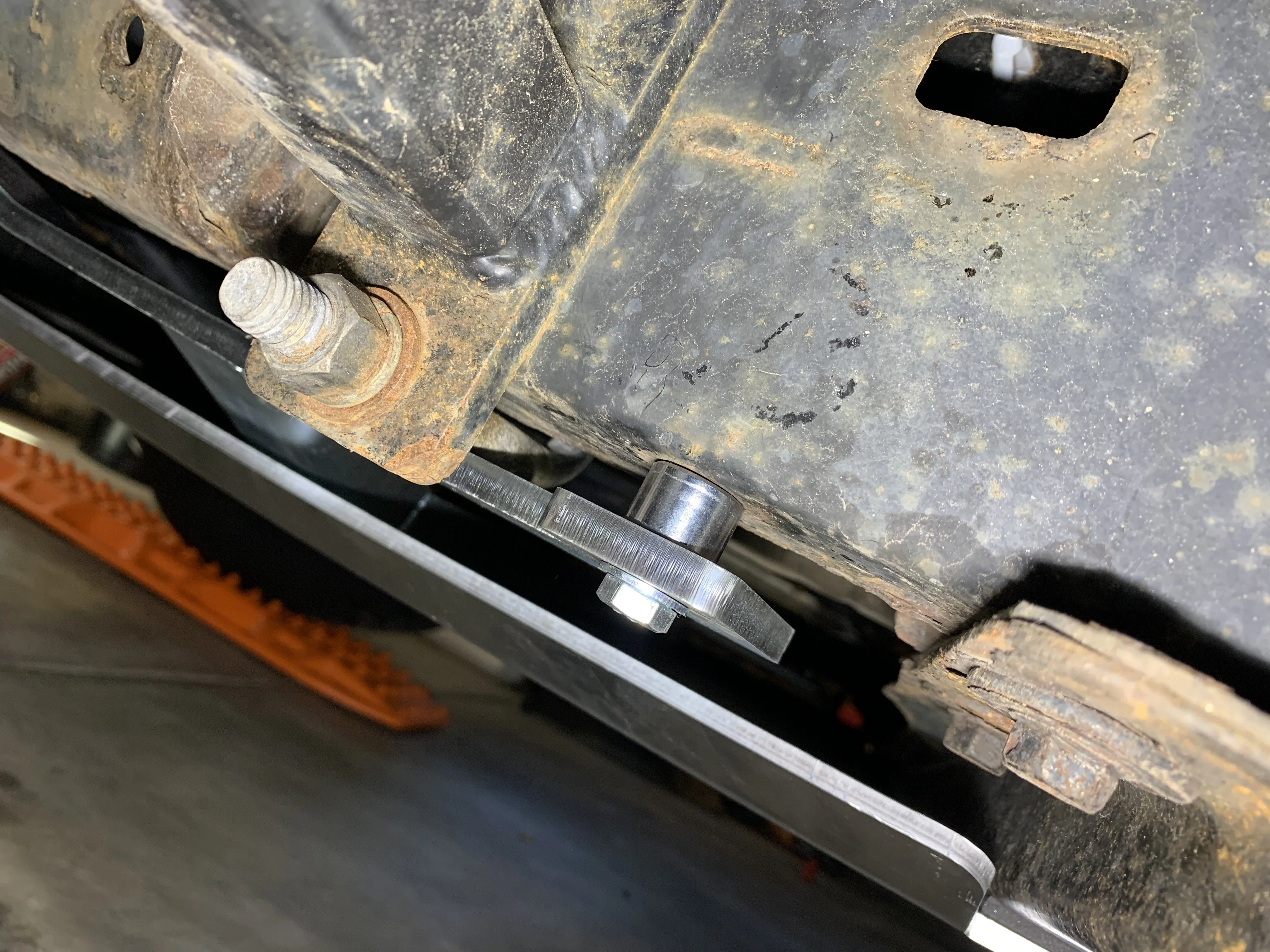

My process for install was the following:
- Install the cross members, but leave them a little loose.
- Install the rear skid with the bolts loose
- Install the middle skid with the bolts loose
- Tighten the cross members
- Tighten the rear skid, then the middle skid
- Used a bottle jack to help raise the front skid, trying to keep the flat part horizontal
- Install the front 3 bolts hand tight, but loose enough to be able to shift a little
- Use the bottle jack between the rear bolts to push the skid against the frame. Once the skid was against the frame and horizontal, the rear bolts lined up.
full
full

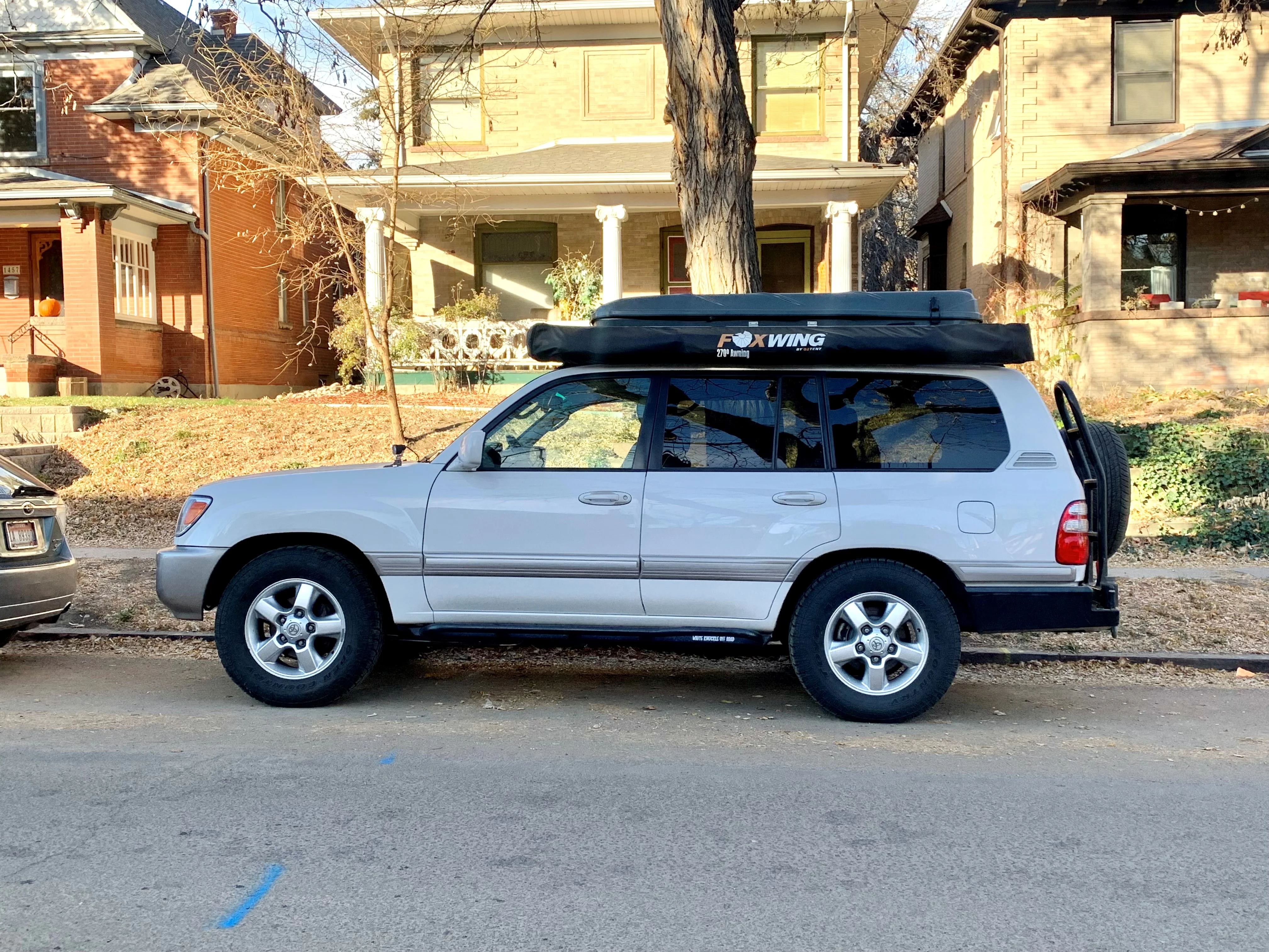

So here is how GUD3.0 sits today.... back end sagging on stock suspension.
full
The weight does add up quick. Here is a run down of everything so far (some of these are guesstimates):

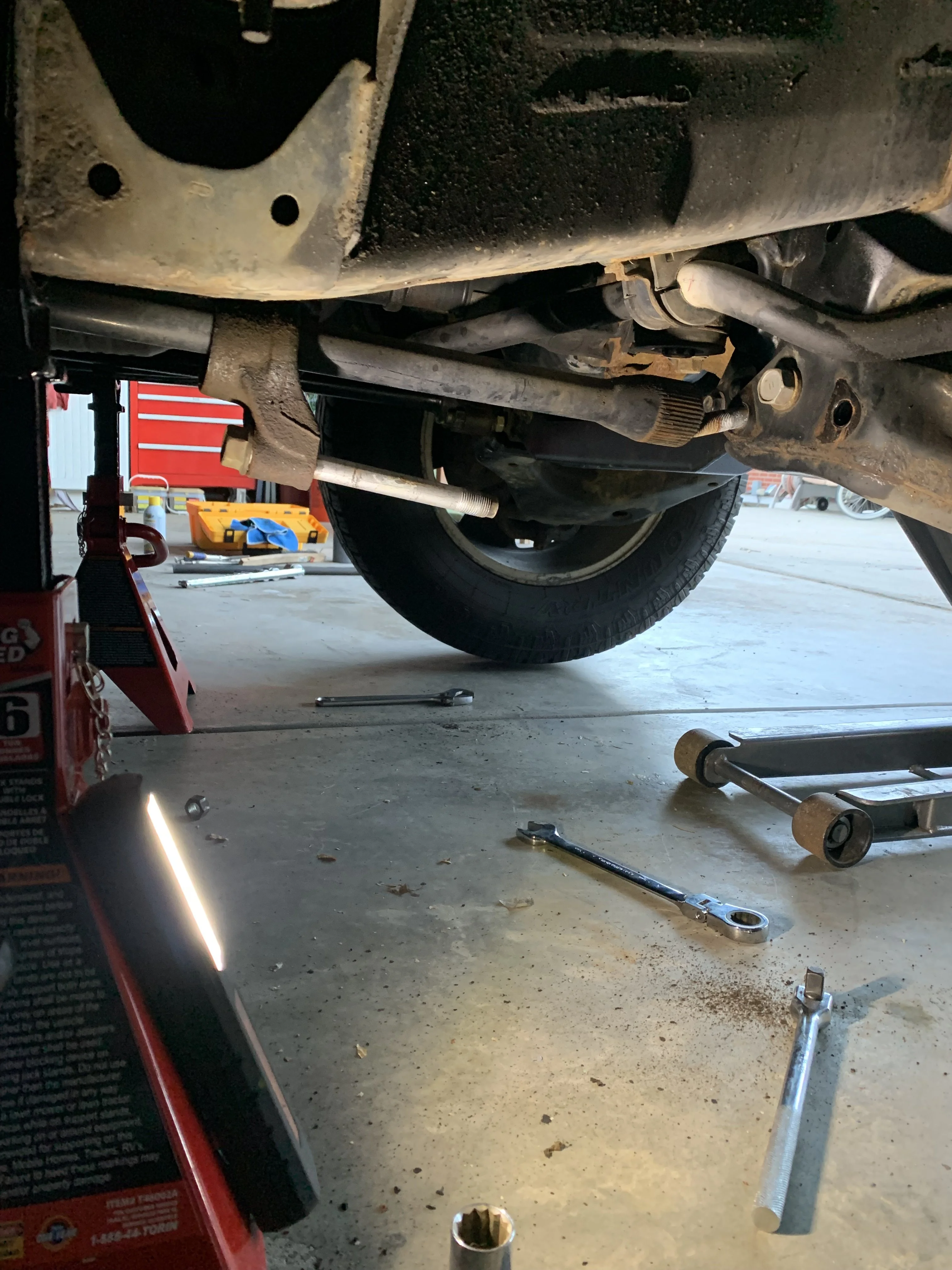

Installed the rear suspension. Went a lot smoother than anticipated. After reading all the horror stories of getting out the rear shocks, I was prepared for the worst, but was pretty straight forward with the right tools.
As recommended by pretty much everyone on MUD, invest in a 22mm flex head ratcheting combo wrench. Makes accessing the top shock nut possible.
Amazon product ASIN B000HBF68I
Removed the lower shock bolt and slid it off its mount. Got the 22mm wrench on the top bolt and wedged it against the frame. Then used a large pipe wrench on the shock body and rotated the shock. Large pipe wrench was the key to have a large surface area and not completely destroy the shock body.

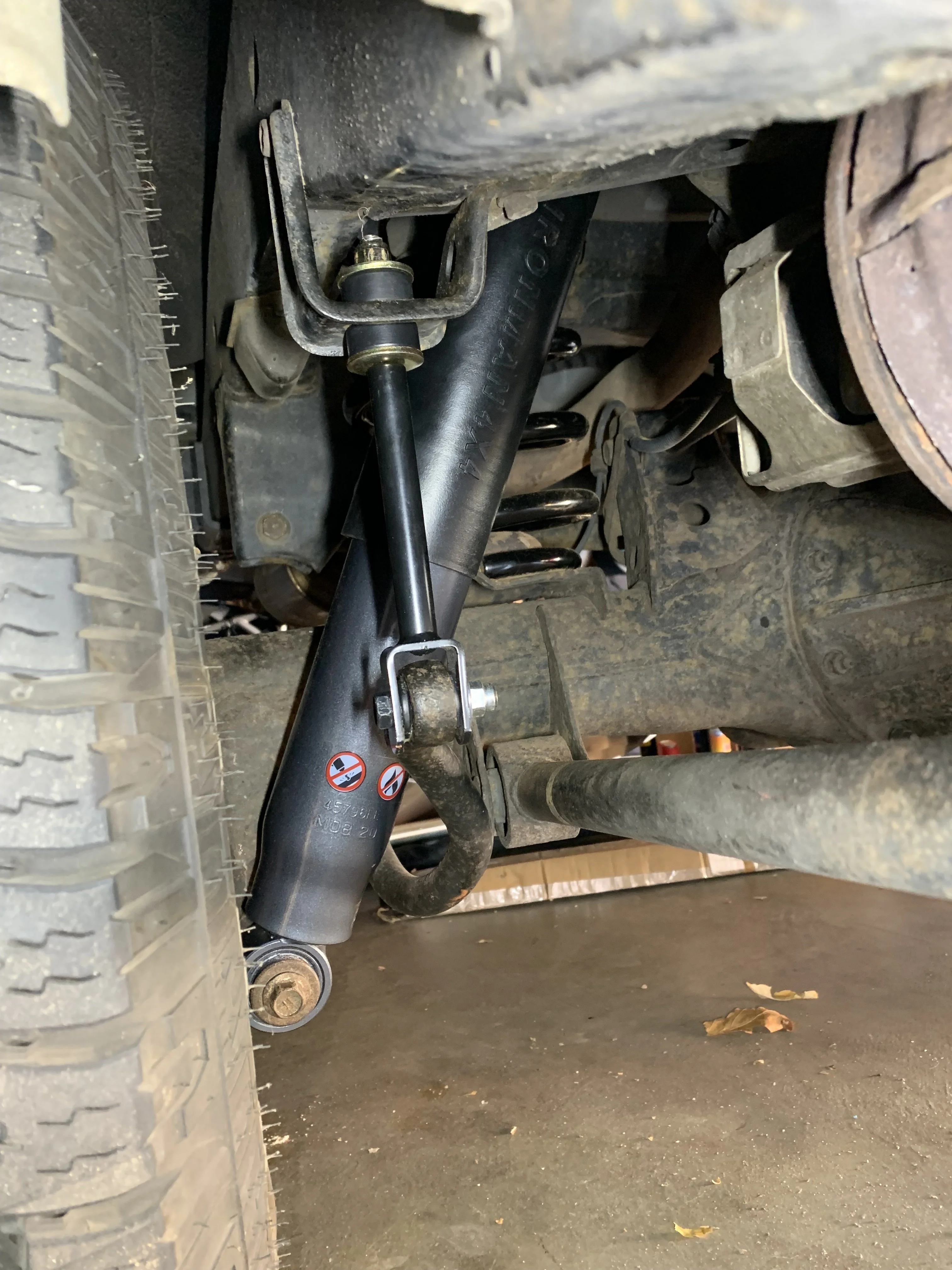

Size comparison of the OEM (can see the pipe wrench marks on the body) and the Ironman Foam Cell Pro shocks. Much larger and much heavier.
full
Note on the rear shocks, since the body of the Ironman is so large the lower mounting eye is offset so it doesn't hit the shock mount.
full
full
The Ironman shocks have a slot on the top of the threaded bolt that you can get a wrench on to hold it in place while you tighten the 22mm nut with the ratcheting wrench.

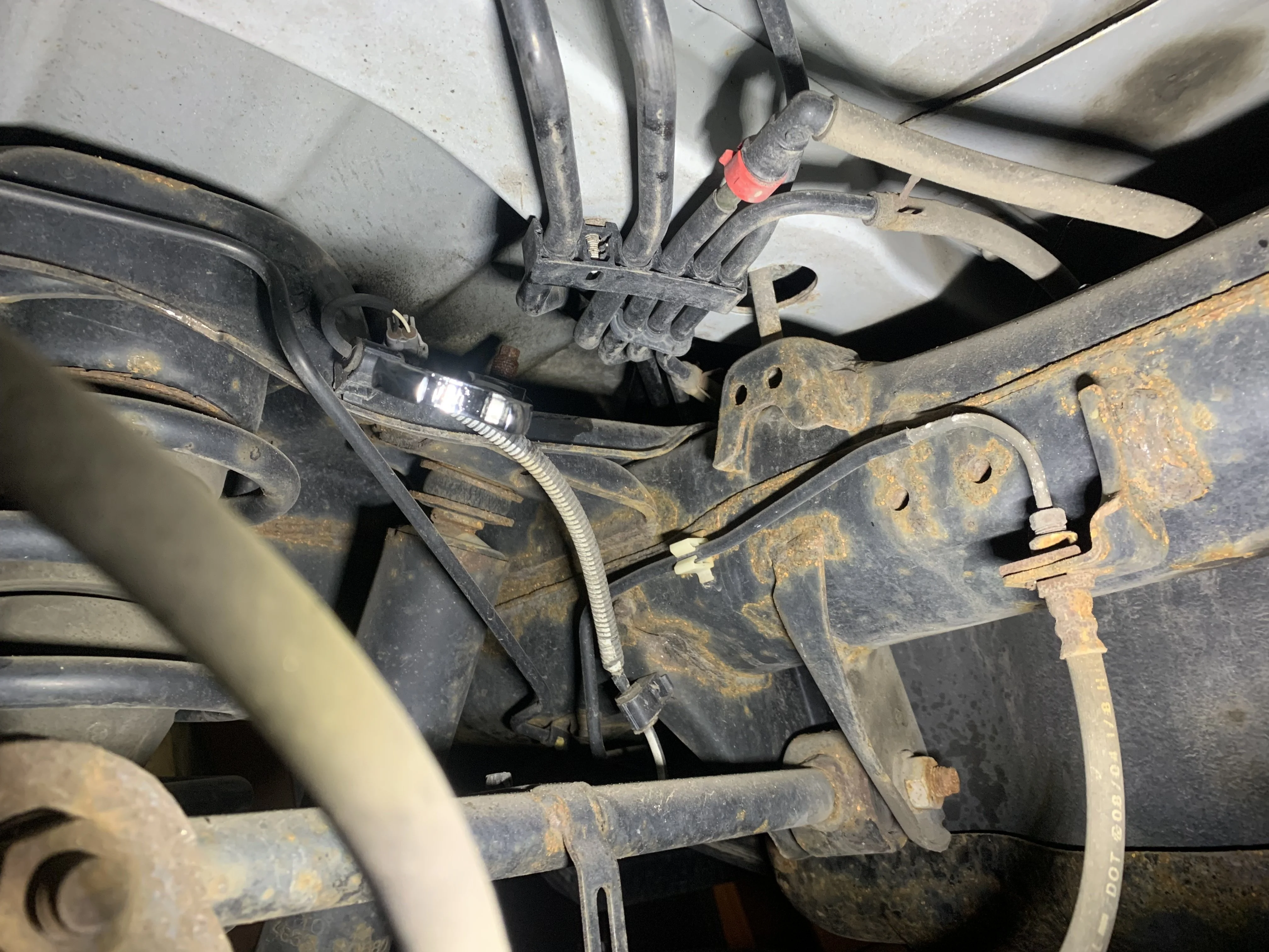

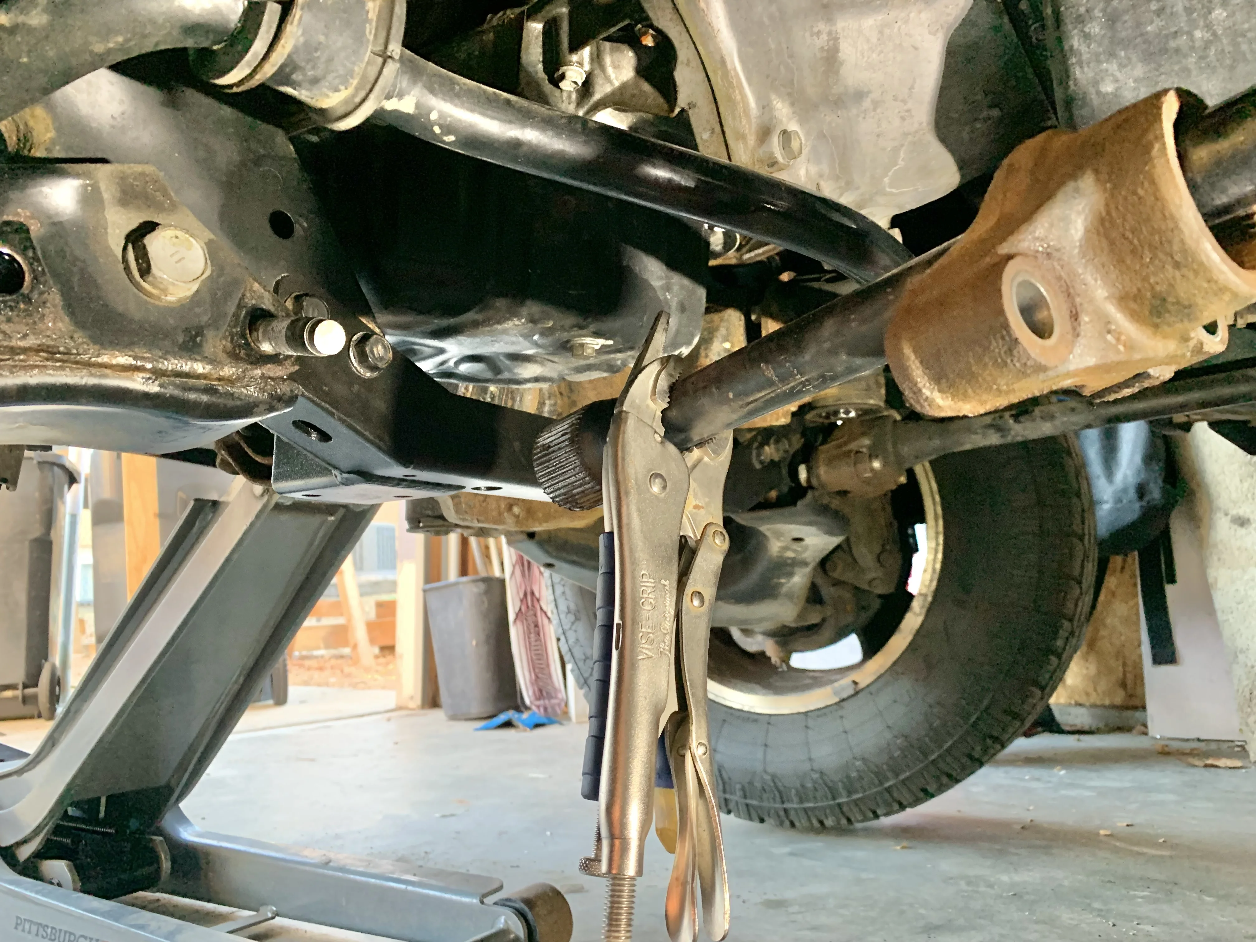

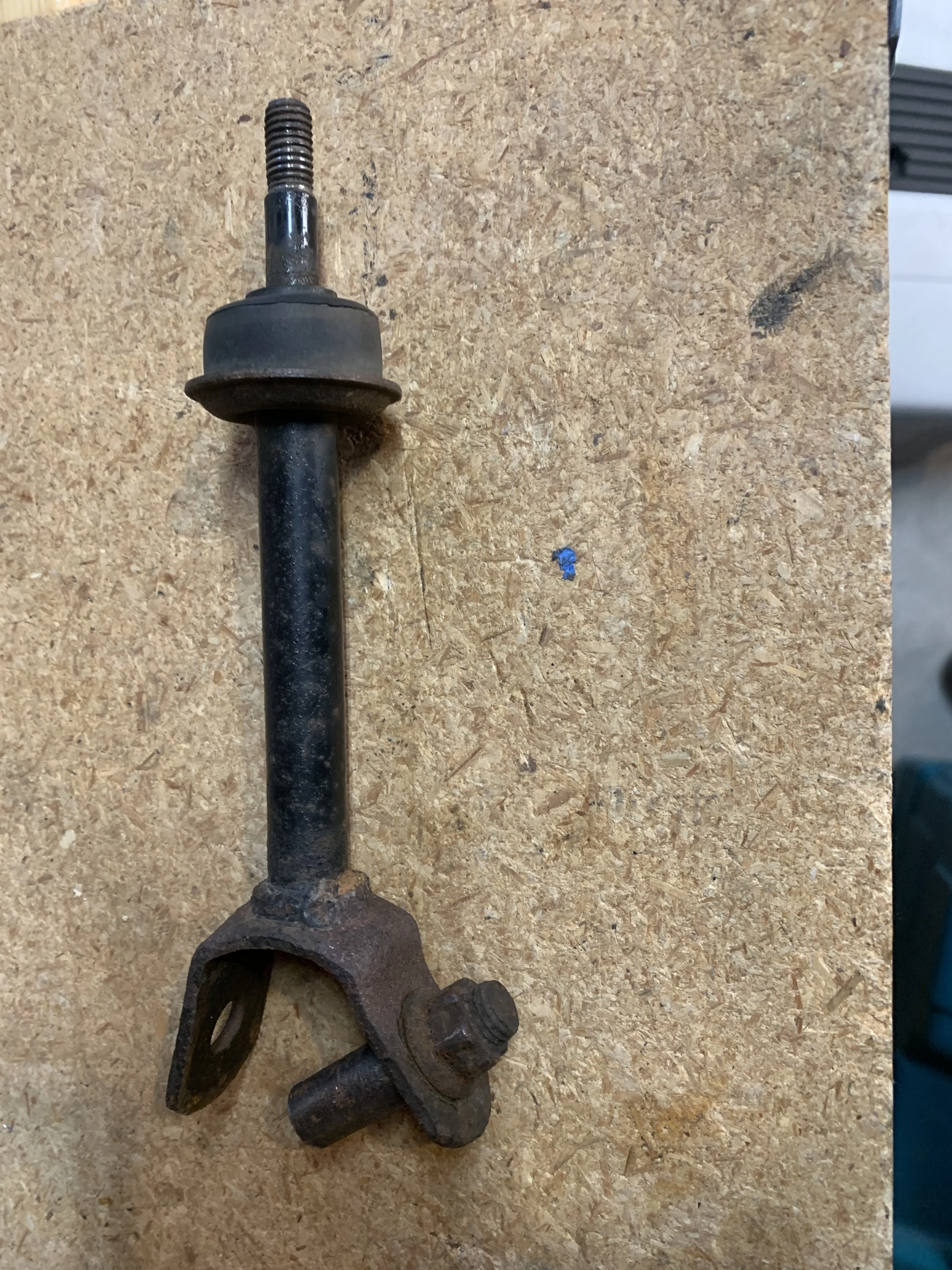

Also installed Trail Tailor Extended Sway Bar Links. As expected, the old links were pretty rusty and the bolts were seized. Sheared both, but one of them was completed seized in the sleeve.
full
full
So for good measure, replaced all the hardware. Here are the extra parts that aren't included with the Trail Tailor setup.

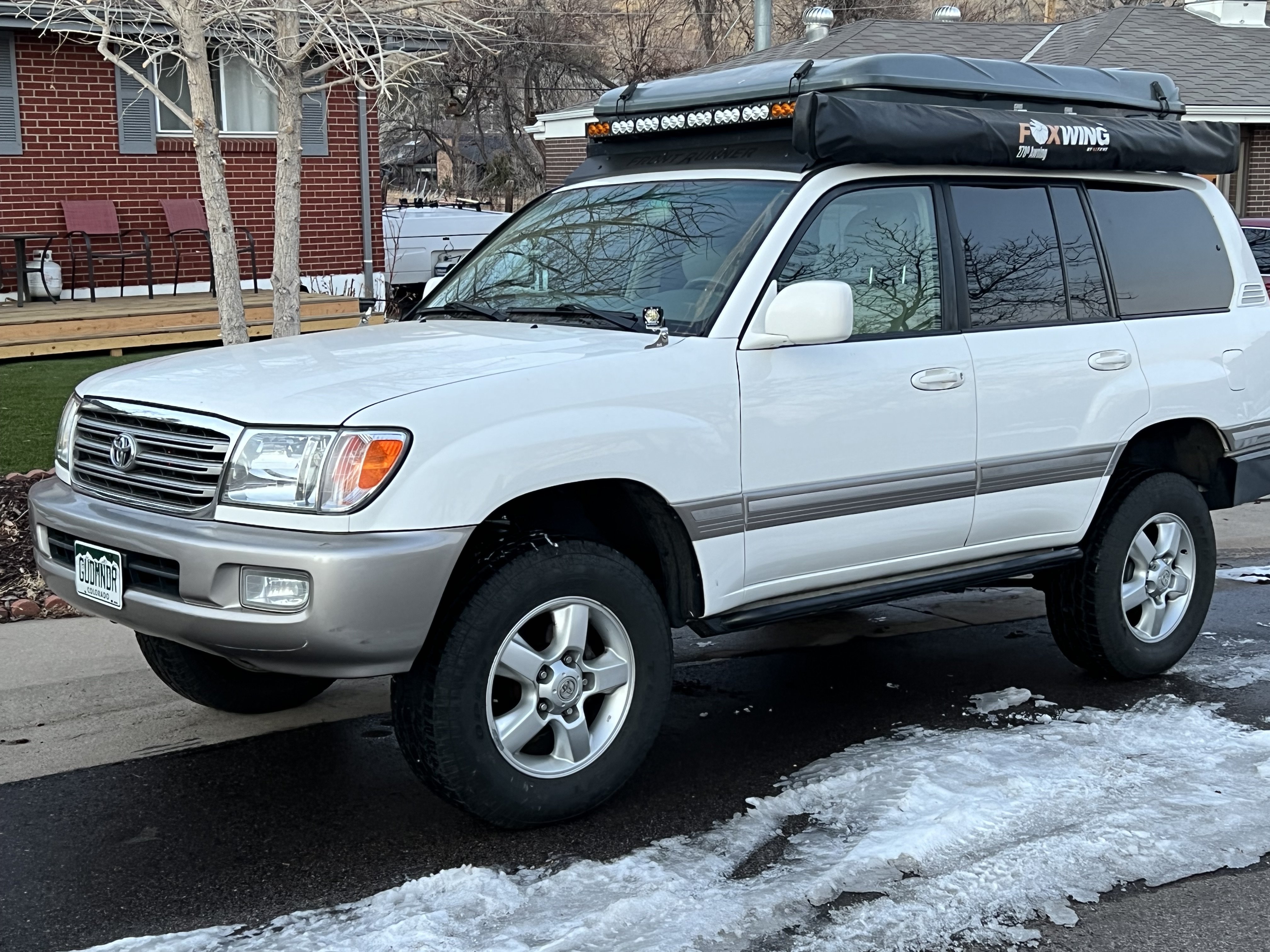

So here how it sits now with the rear suspension done. Super stink bug!
full
On OEM springs it sat at 19" from fender to hub. With the OME 2864 it sits at 23.5". Expect it to settle a bit over time. Next up will be the front suspension.

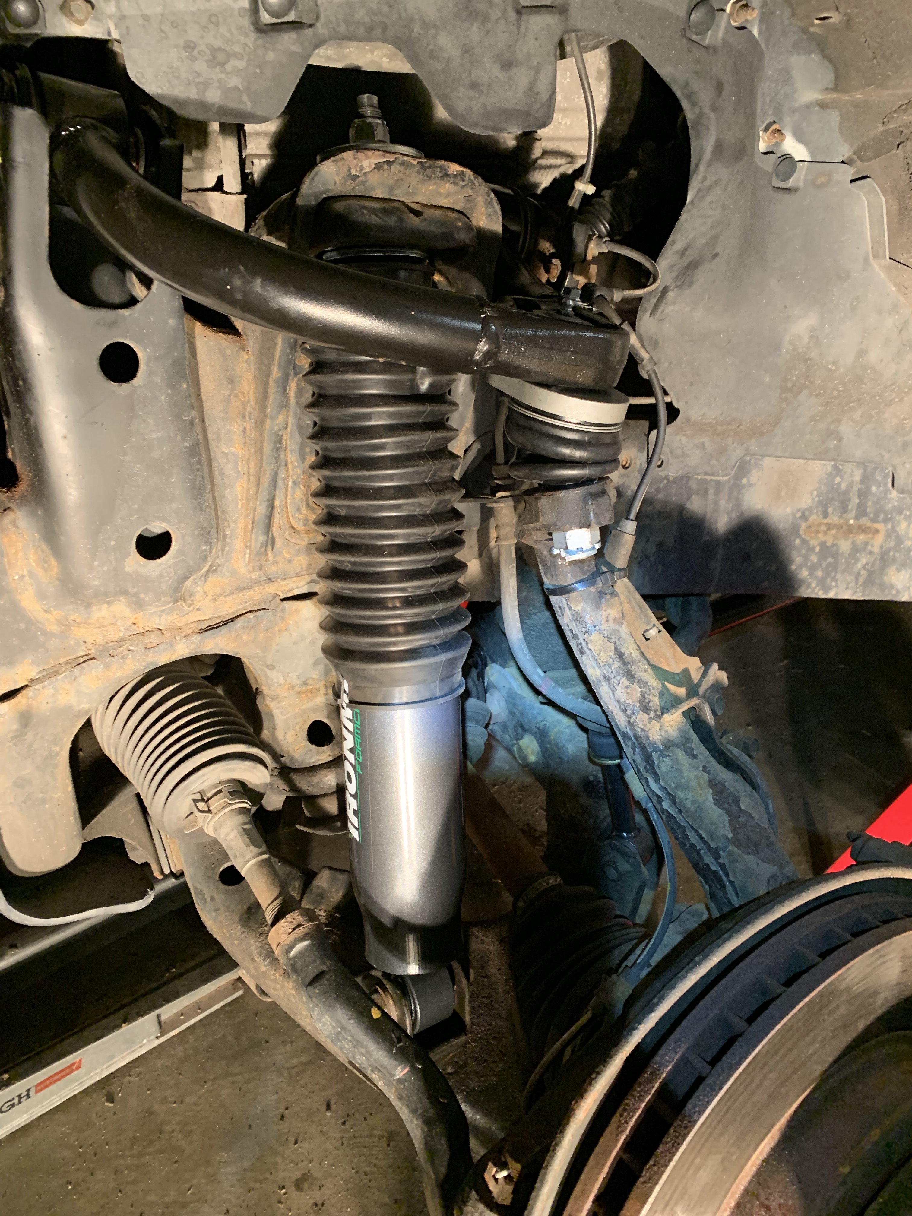

Finally finished up the front suspension. Had to wait until some warm weather in Denver. Upgrades included:
- Ironman Pro Foam shocks
- Ironman Torsion Bars
- Ironman Diff drop
- Ironman LCA Reinforcement Brackets
- Trail Tailor Extended Sway Bar Links
Install was pretty straight forward and everything came out with minimal effort. Again, was expecting the worst based on some past threads on t-bar removal.

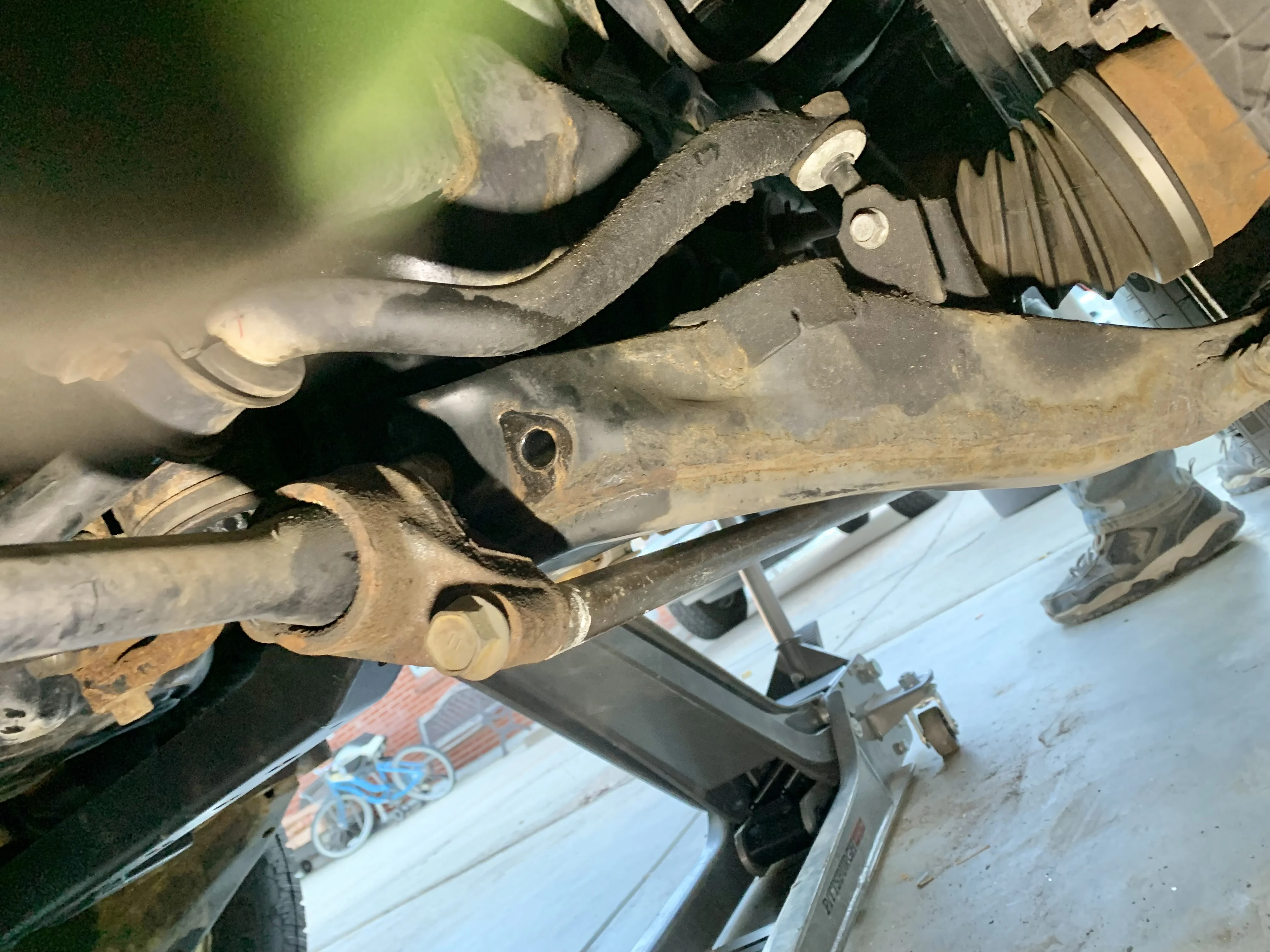

Started with the diff drop. Some good write ups on the install. Basically support the diff with a jack. Remove the stock support, then swap in the drop kit and spacers. Bolt everything back up.

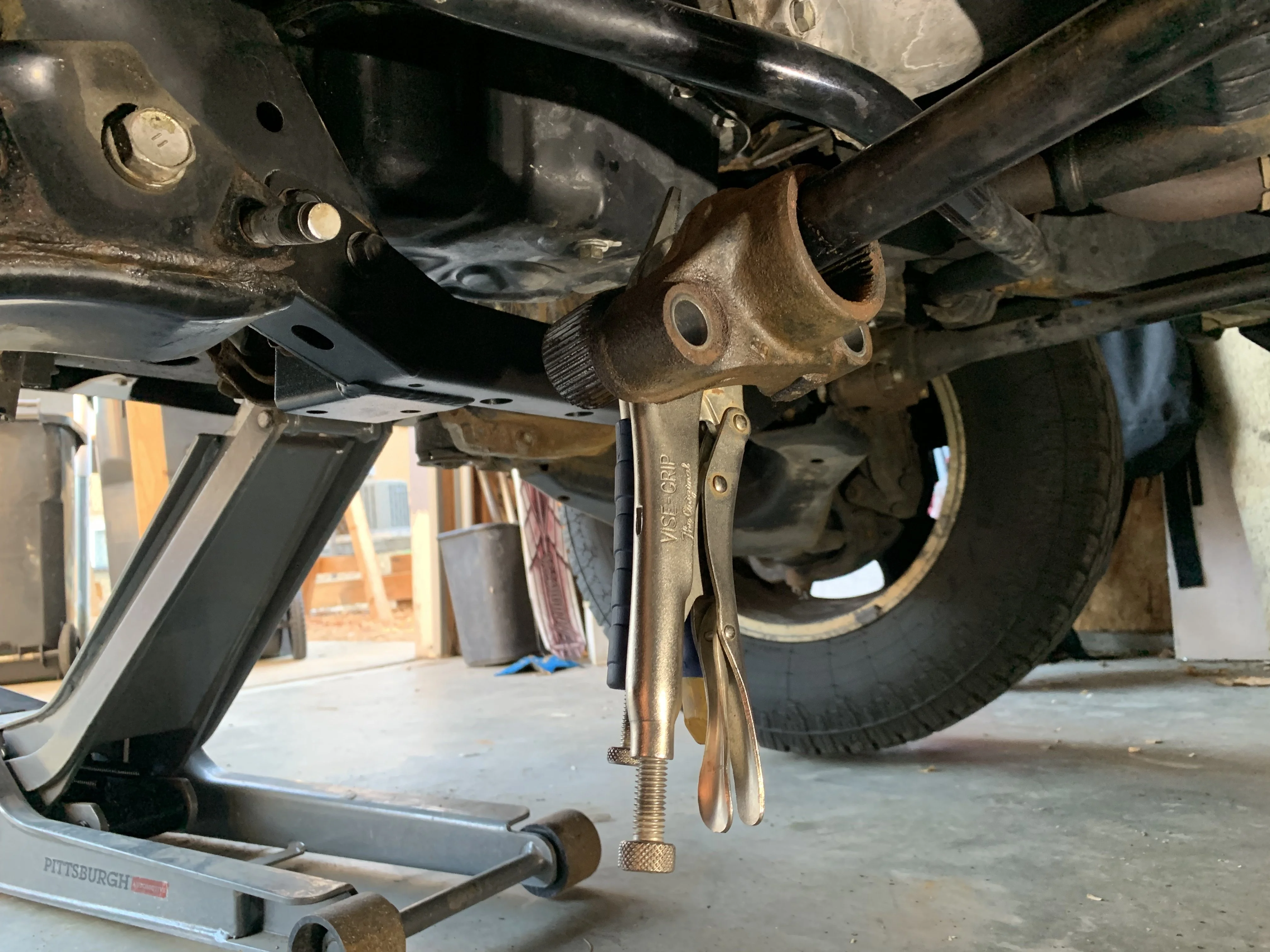

Found a couple of tricks to get the mounts off the torsion bar splines. Pics are a bit out of order, so hope it makes sense.
First, remove the adjustment bolt from the rear of the torsion bar. Front torsion bar mount is held in with two bolts. One can come out completely and the other can't. Remove the one that can come out and run it through the mount in reverse so the bolt faces the front of the 100. Take a long breaker bar pipe and slide it over the bolt. Bolt will act as a guide to center it on the mount. Use a sledge to pound the breaker bar straight back and the mount should slide back on the splines. Only need to push it far enough back so it clears the bolt that can't be removed.
First pic shows the breaker bar on the mount.

SPC UCAs were simple since access to everything is easy. Didn't even need a puller on the UCA ball joint. Just a few taps with a hammer. Since this required an alignment post install, we didn't try to dial in the adjustments on the SPCs. Set the SPC star plate to "D" for 2-3" lift. Left the cam bolts to the same position they were in and the ball joint in the middle of the slot. SPCs come with new castle nut and cotter pin.
Everyone warns of dropping the SPC washers in the frame. Even with two people we dropped 2 of them in the frame. So consider this another warning!
Not much to say about the shocks and sway bar links. Unbolt the old ones. Bolt in the new ones.
full

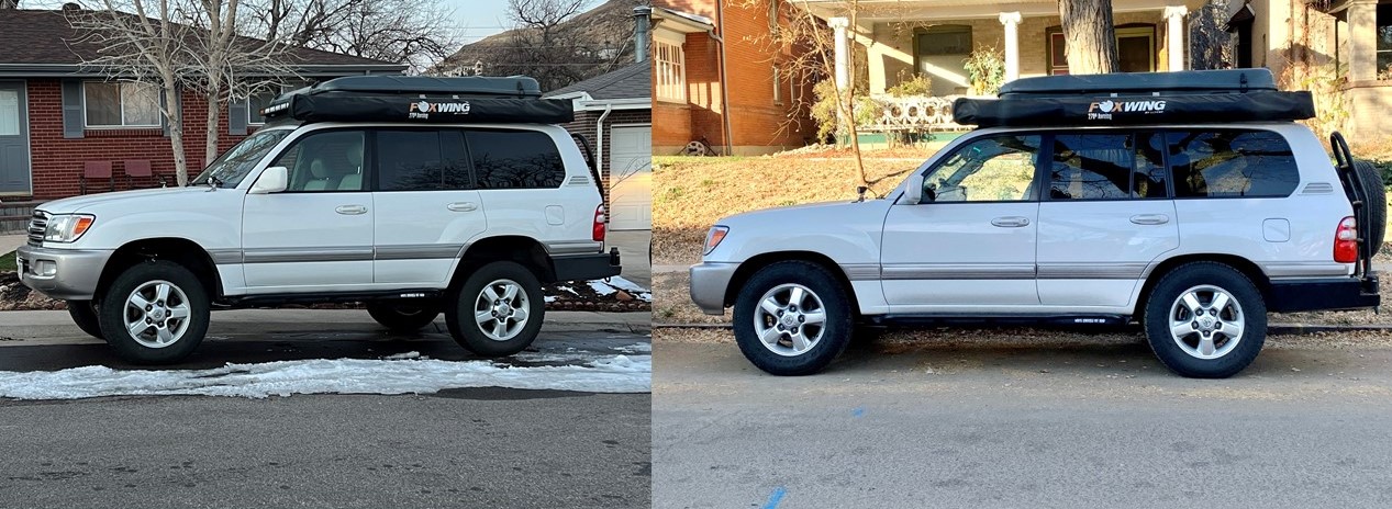

First try on the torsion bar settings was a bit low. Dialed it in again when we did the LCA brackets. Here is how it sits now.
full
Currently at 23.5" in the back and 22" in the front. I figure both will settle with some driving. Here is a before and after picture. Stock tires look really small after the lift.
