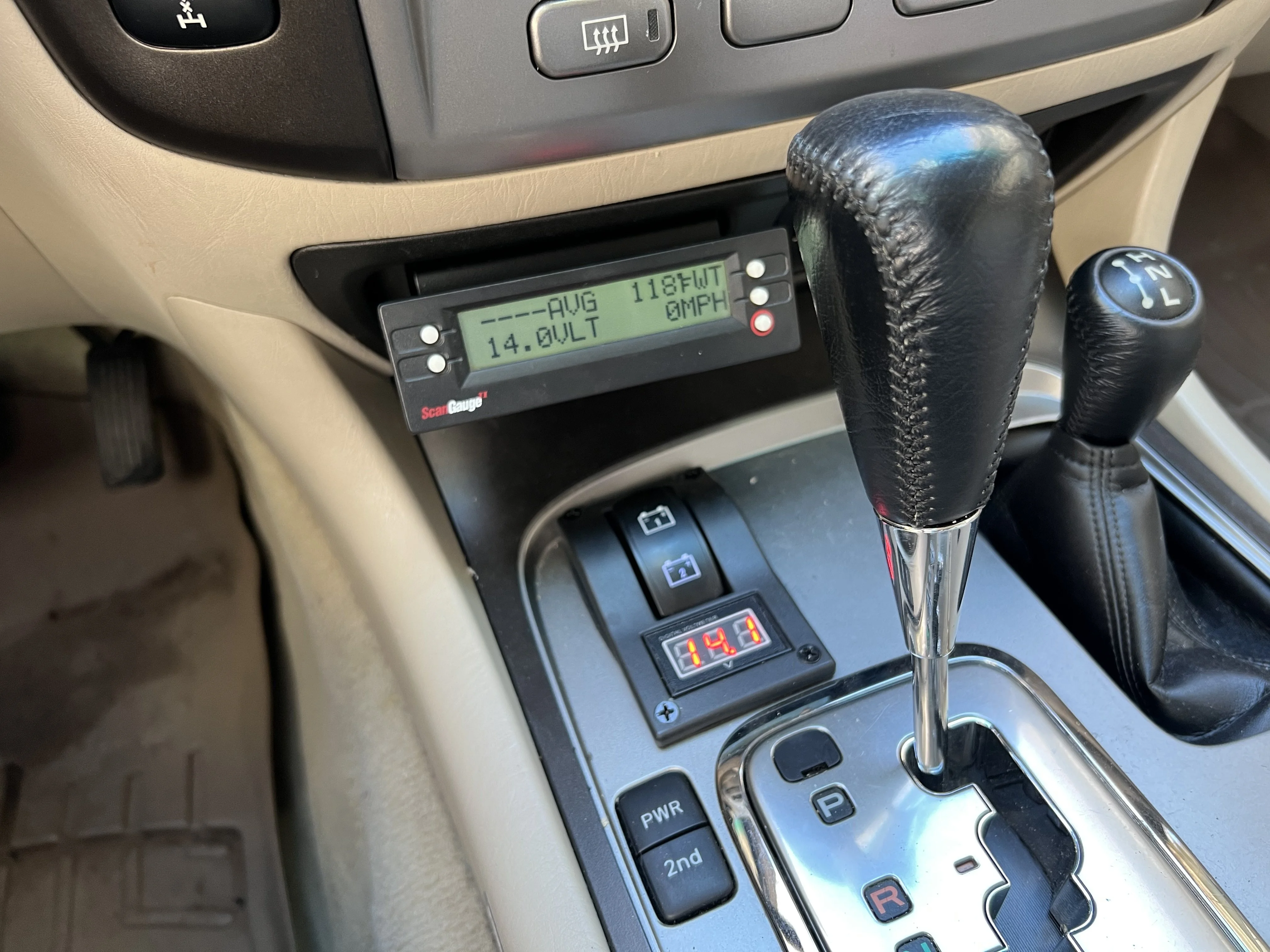

Finally installed my ScanGauge II using a mount from Cruiser Garage. Super easy install. Took about 10 minutes.
100-Series Ash Tray Mount — CRUISER GARAGE - https://cruisergarage.com/products/ash-tray-switch-mount

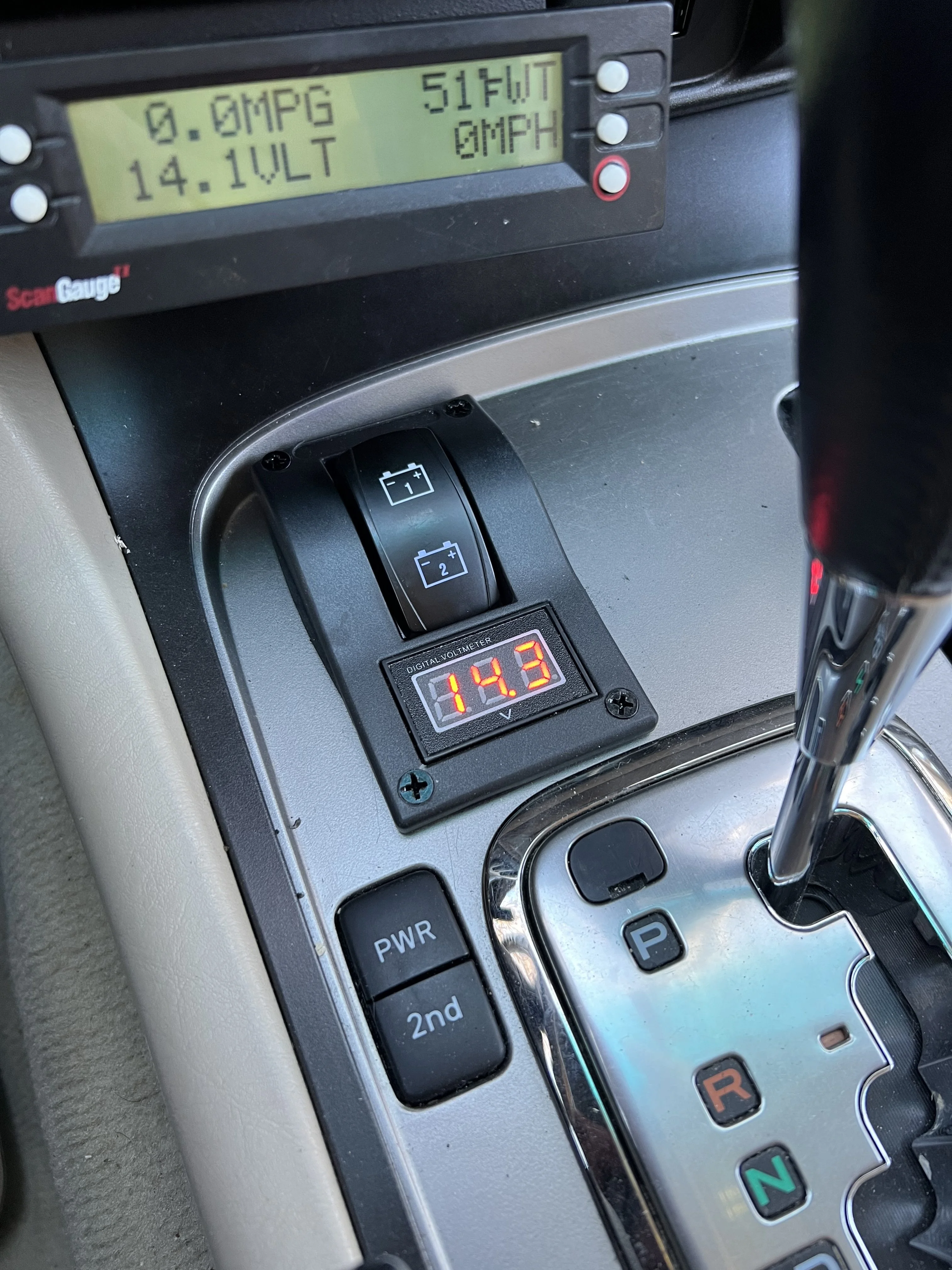

ScanGauge is great to monitor engine temp and to have a corrected readout for MPH once I up-size the tires. I found it interesting that there is voltage drop to the OBD2 readout for volts that the ScanGauge reads. The in-cab voltage monitor I installed is hardwired 16 AWG directly from the battery and it reads anywhere from 0.1-0.2 Volts higher.

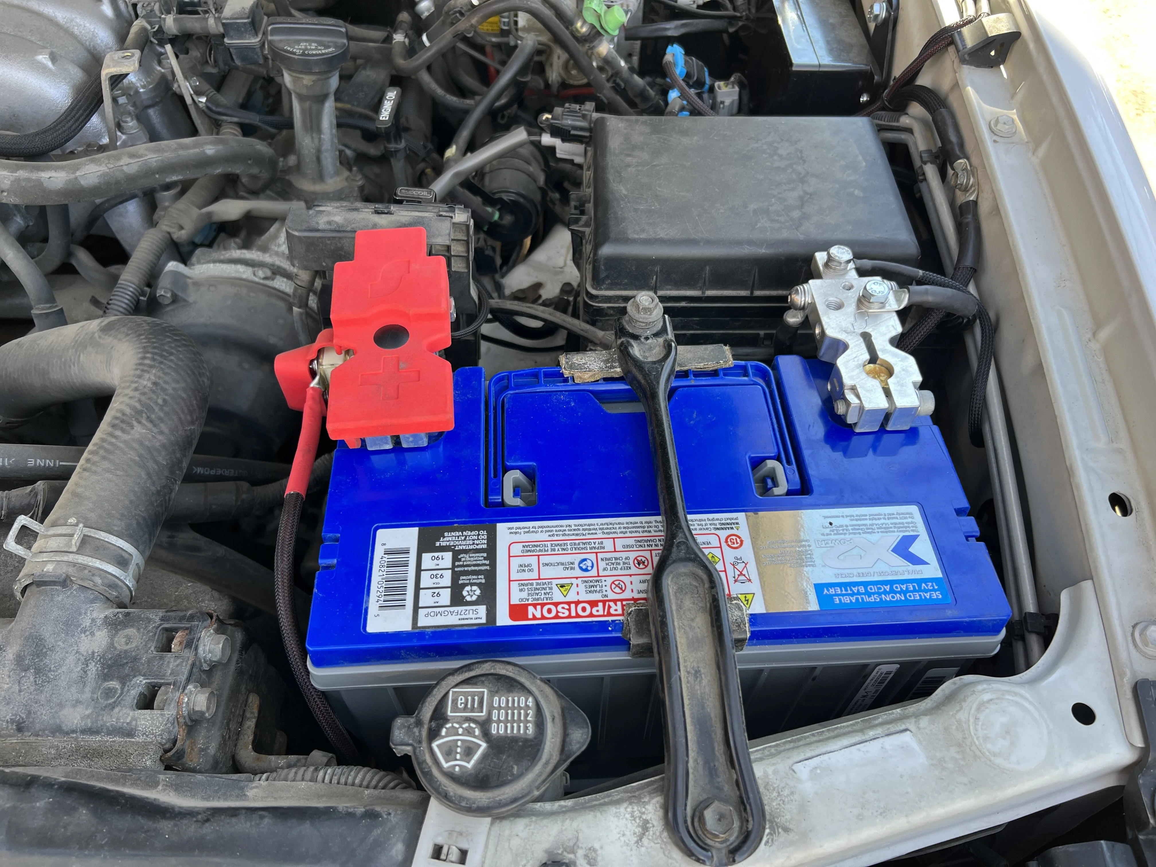

Replaced the starter battery today. Old one had to be jumped a few times and noticed it was slow to turn over lately. Resting voltage was mid to high 11 volts. Sticker on it was from 2017. So figured it put in a good fight.
Had planned to just get a regular starter battery. Ordered a Duracell 27F from Batteries Plus. Got confirmation I could come pick it up. Got there and they said they made a mistake and didn't have any regular 27Fs in stock. None of the of the other Denver stores had them either. Saw they had X2 AGMs in 27F. So pulled the trigger and got that. Don't really need a AGM for a starter battery, but figured why not. The Land Cruiser is already a money pit! Comes with a 5yr warranty compared to a 3yr for their regular starting batteries.
Specs on it are pretty beast:
- 930 cold cranking amps
- 92AH

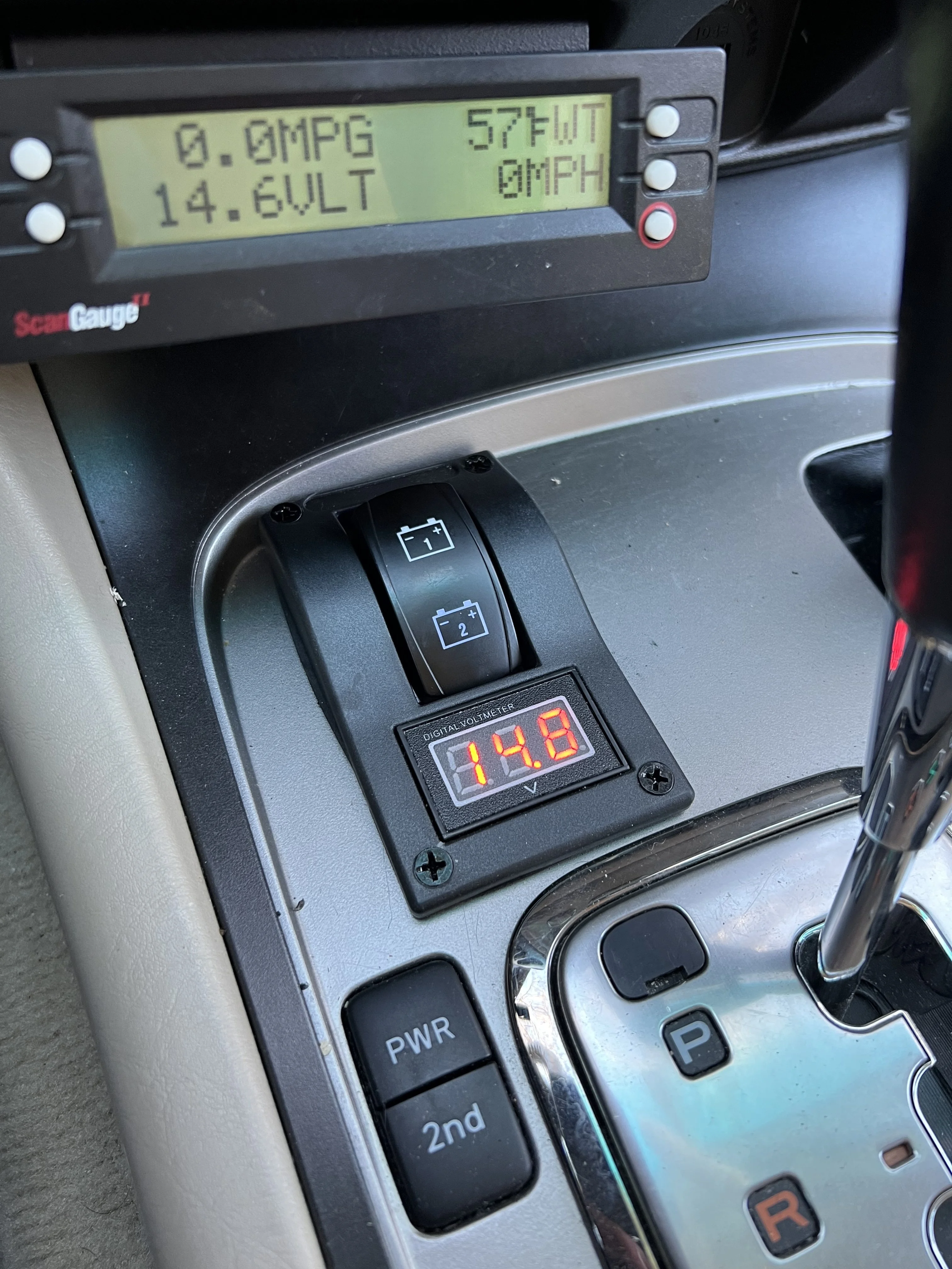

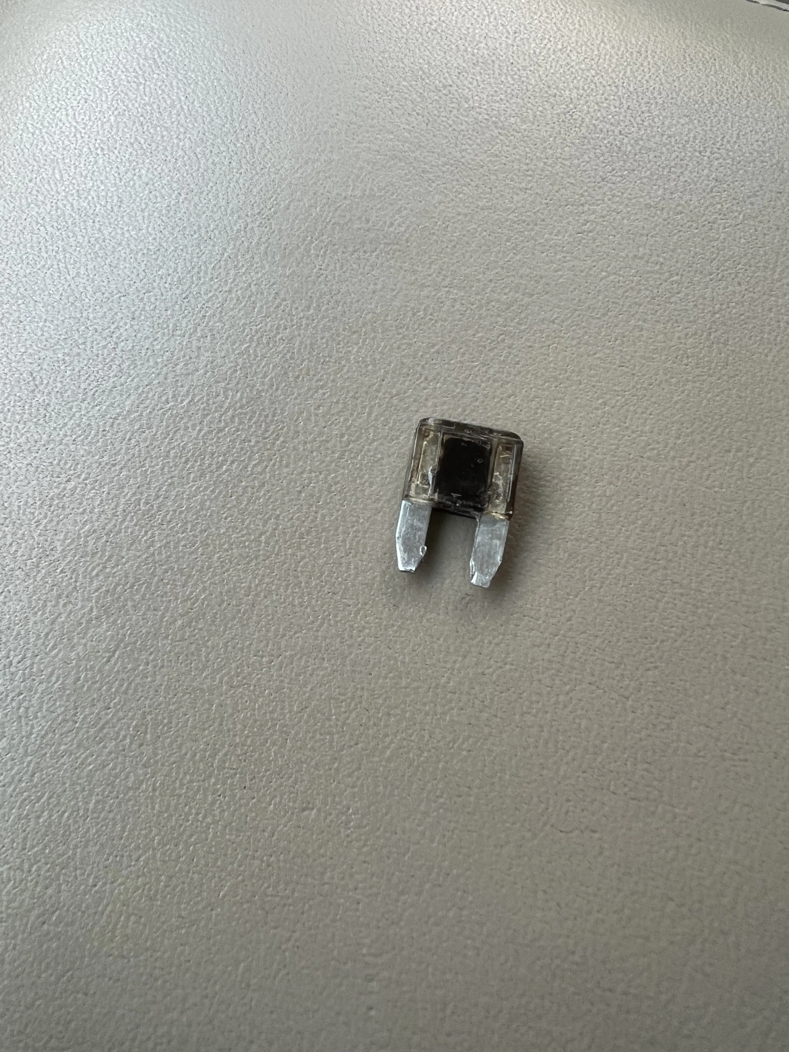

AGMs like a higher voltage to charge properly. To remedy this most folks add a voltage booster. I had one from GUD2.0. It replaces the regular ALT-S fuse. Using a diode it raises the voltage by 0.5V.
MK1 Mini Blade 7.5A (Fusible link version) | HKB Electronics - https://www.hkbelect.com/product/338-mk1-mini-blade-75a-fusible-link-version-2005/
full
Before the booster: 14.3V
full
With the booster: 14.8V
full
I consistently find that my Scanguage reads low too. About 0.2v low. Interesting to see that it is the same for you.

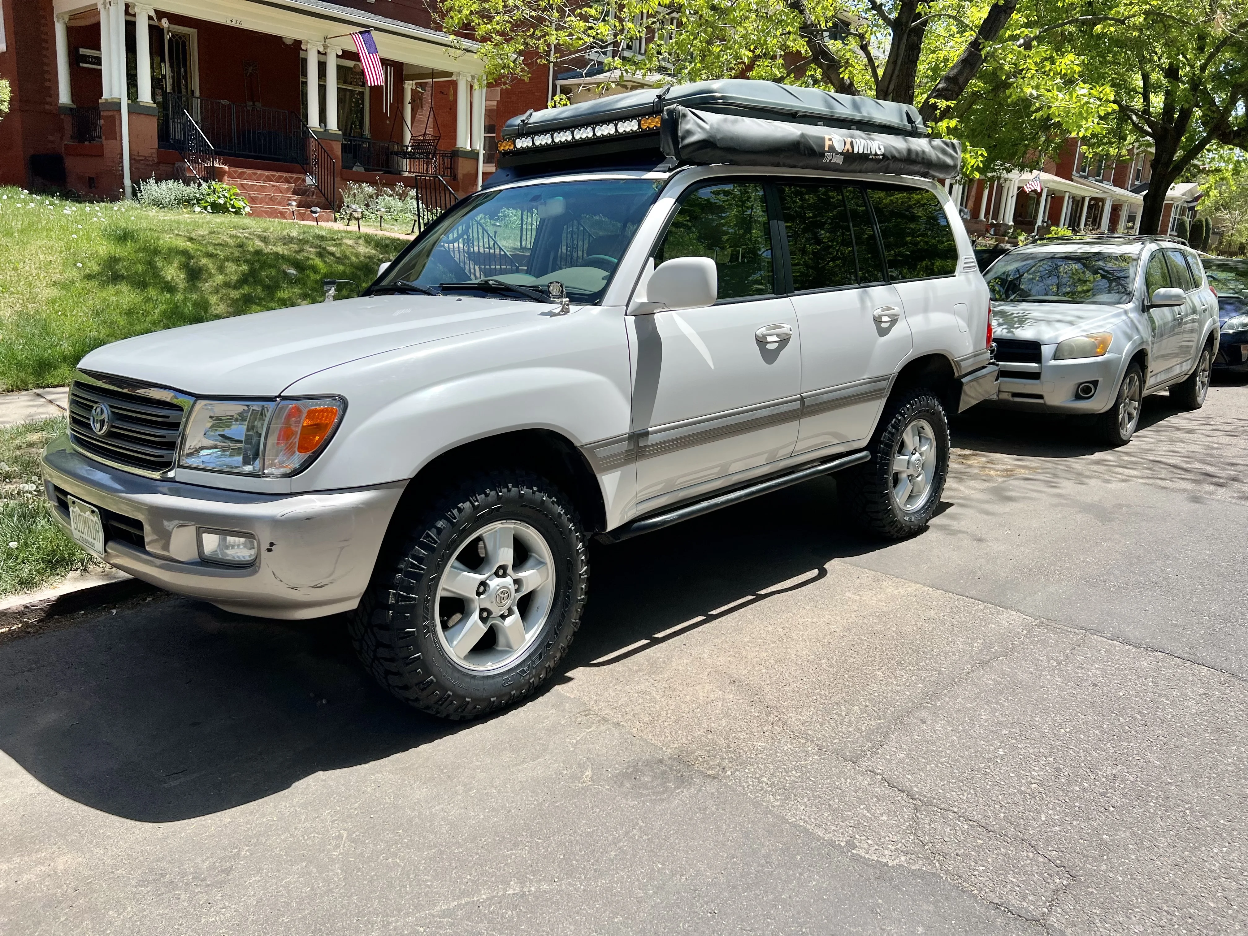

New tire day!
Went with 275/70/18 DuraTracs. With all the weight I wanted an E load rated tire. Had them on GUD2.0 and liked them. They are quiet on the street, have great snow/ice handling, and good off road. Some folks have had issues with side wall cuts. I've never had any problems, but also don't wheel it hard.
In other news, someone side swiped the front bumper while I was parked on the street (can see in the picture). They were nice enough to leave a note. Not going to try and fix it...... just going to upgrade to either a Slee or ARB.
