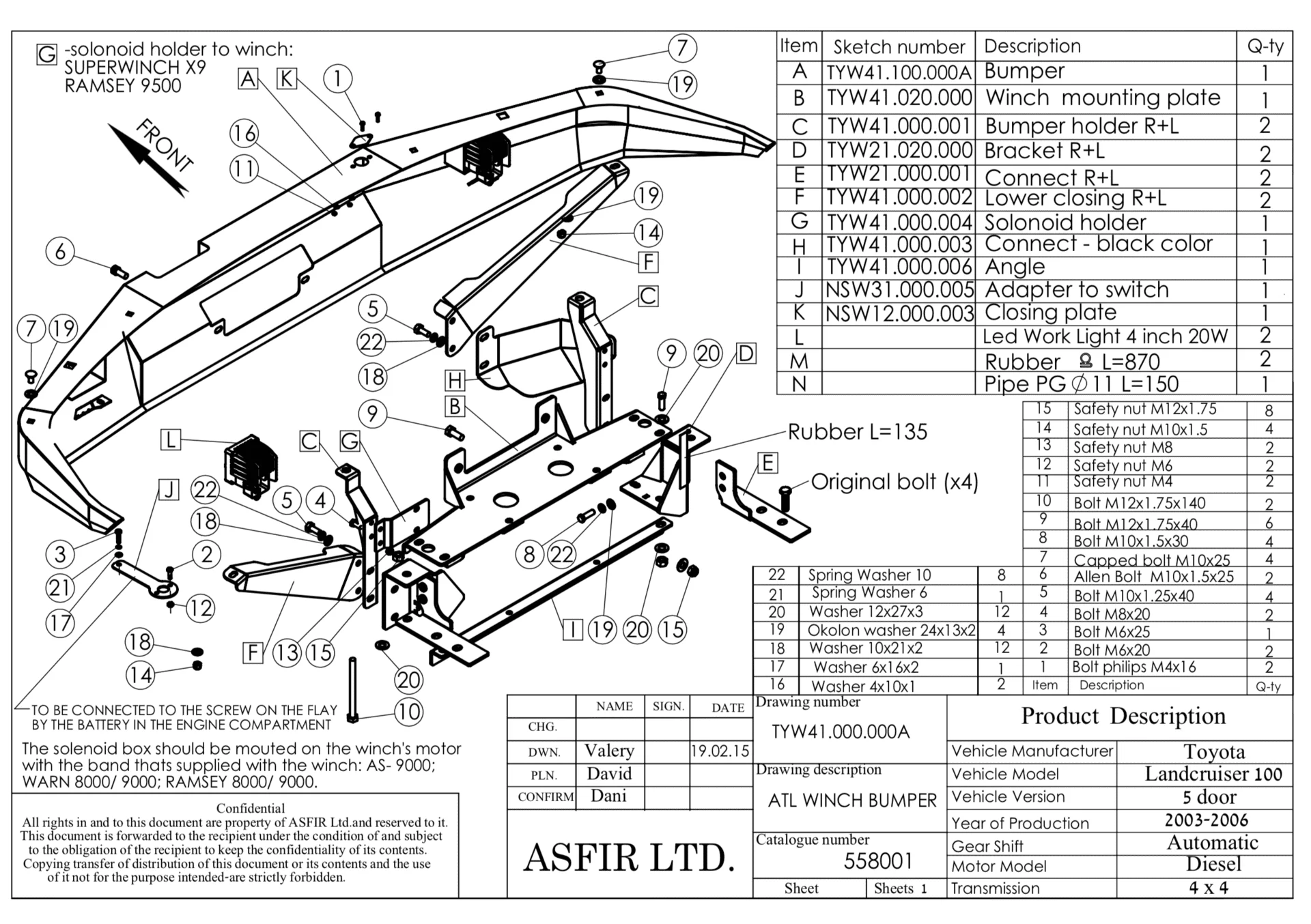

Asfir also offers a front bumper this is what they sent me...

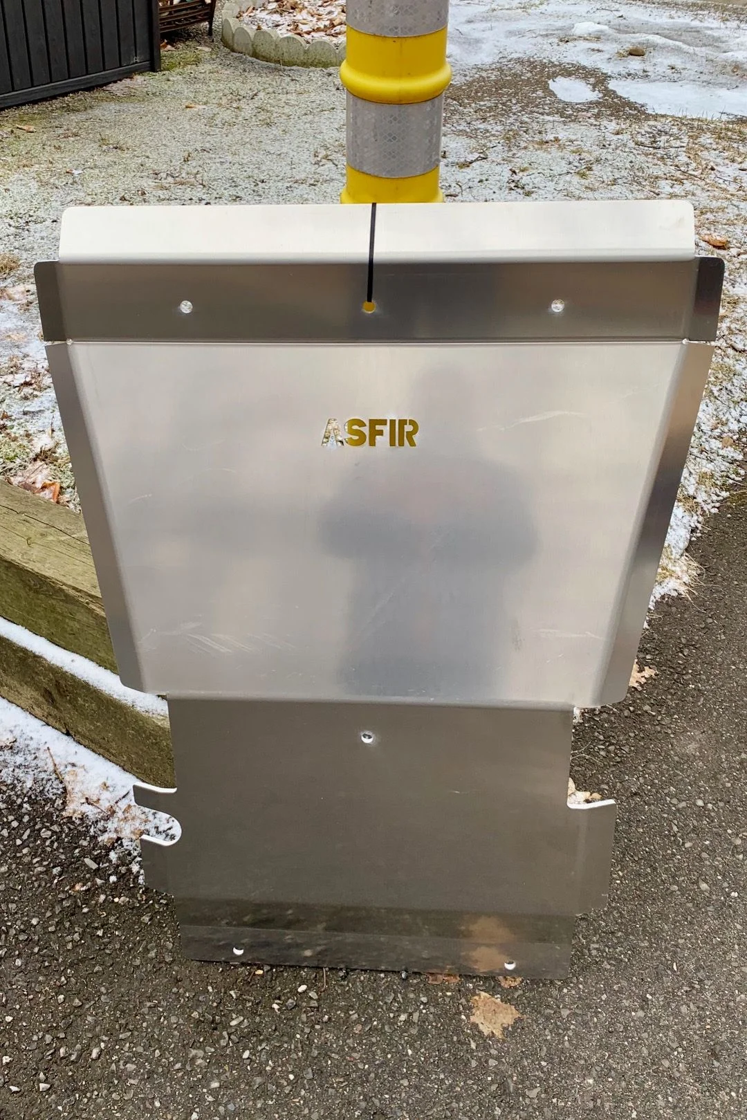

How thick is it? When you look at the pic of it standing up, the bottom looks pretty thick, but it looks very thin on the top section.
Also, how much was it w/ shipping and how fast did it get to you? Come with hardware? Was it straight bolt on with the LX w/out trimming?
@neckbone
I paid $192.69 US plus a small customs fee when I picked it up at Canada Post. So say $200 US all in. An excellent price for the quality product you receive.
The thickness is uniform throughout. It's just the angle of the photo that makes it look weird. It bolted right up easily with no mods required. It came with an extra bolt and spacer but I didn't need it. I think it was for the diesel model. This product it excellent.
It shipped fast and took about a week to arrive. It only came with one bolt and spacer which I didn't use. I replaced all the original bolts with SS hex bolts for a cleaner look.

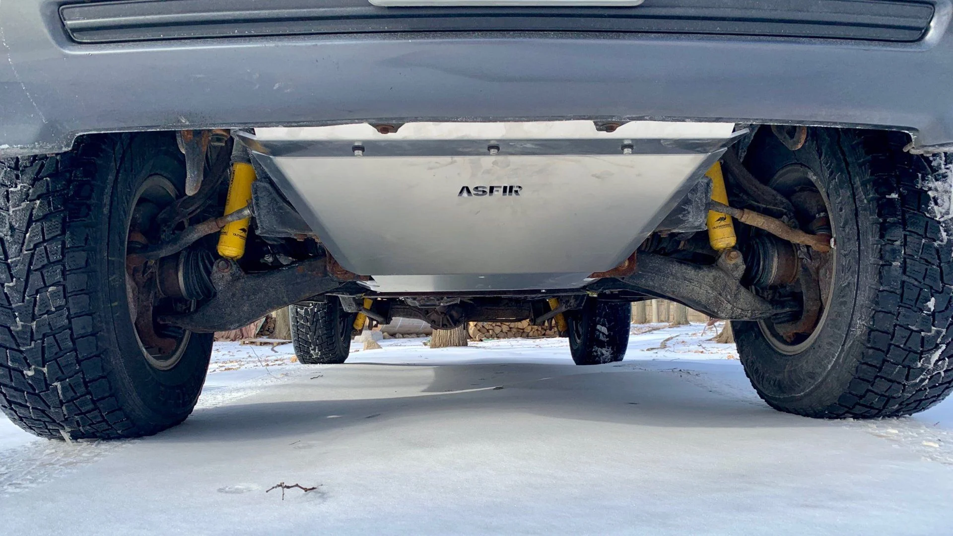

Does it work with the plastic underbody tray that covers the oil pan that comes stock on the LX? It looks pretty good, so it covers the front the is also a skid to the front diff right?

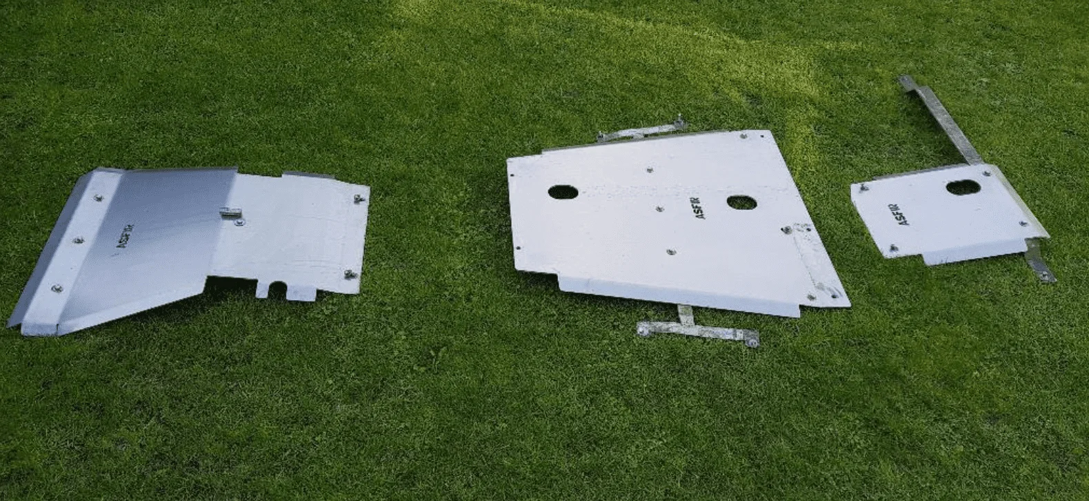

Was looking to buy this and the whole set, but the gear skids from ASfiR needs modification as it's for the hdj diesel.
What does the gear skid cover? I'm thinking about getting the front skid then going to Trail-Tailor and getting his creeper skid.
Oil pan and trans I think? /Pretty sure.
I'm assuming it covers the transmission but you can contact Leonard at ASFIR and confirm. Also, confirm it'll work with the GAS version and not only on the Diesel version. I hear some skids will need modification. The front one I ordered did not need any mods.

The front skid plate doesn't seem to allow access to oil filter - do you remove the whole skid plate? Or can you access from side?
I haven't performed an oil change yet. I'm assuming it'll be like my Ricochet Skid plate on my 03 GX470. You can access the oil filter from the side. Or because it's so easy to remove and install the ASFIR skid plate you could do that. Which is what I plan on doing when it's time to do an oil change on my LX.
