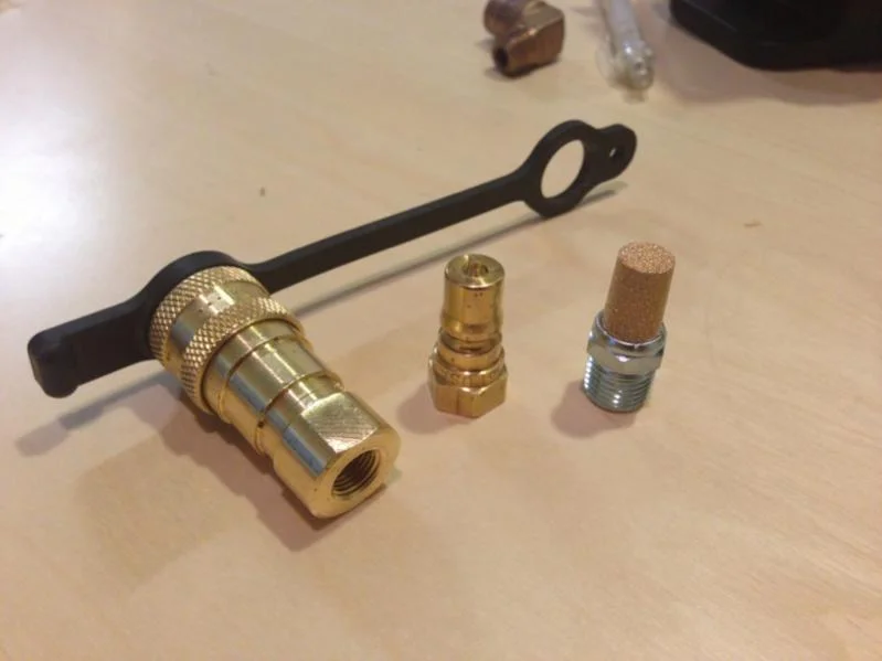

I picked up a bunch of 3/8" fittings and some hose to play around with ideas. I think I am going to go Parker for everything for the OBA and the Shower install. I really want Stainless Steel fittings and connectors and it turns out we have a mud member who is not only a Parker dealer himself but his entire business revolves around stainless. I think I'm going to be sinking a bunch of money into this endeavor. :P
Yes I'm going to do Pretolok on everything. I learned there is a DOT version which has a deeper lock along with an interior sleeve which goes into the tube. This is seriously stupid overkill especially since the $6 Parker part becomes a $30 DOT part. And that's not even in stainless. I found a quick disconnect I like that I think I'm going to use. They are called Nipple Couplers. They look like your standard compressed air quick disconnects but they are nippled on both sides of the mating connector which prevents any leakage at all. Overkill a bit but I like that. I will get these in all stainless so that I don't need to concern myself over the steel internals rusting. I also picked up a breather filter. I like these and may use them or my breather extenders. The mount for these will just be a bent piece of steel that will be powder coated with the rest of the bumper. I have the Odyssey battery tray on its way and now just reading up on which SureFlo I need to order.

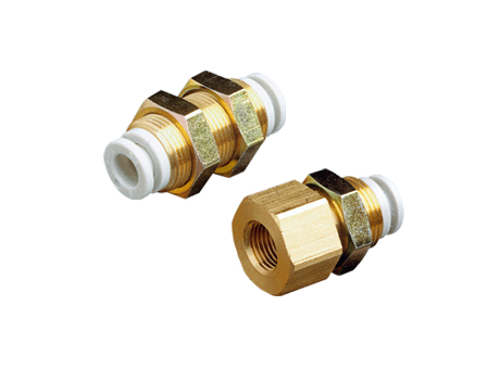

My question on the Parker fittings, how in the heck to I attach them to the truck? I don't want something hideous like a steel, rubber lined, clamp. That just screams cheap.
Bulkhead connector is the term I believe

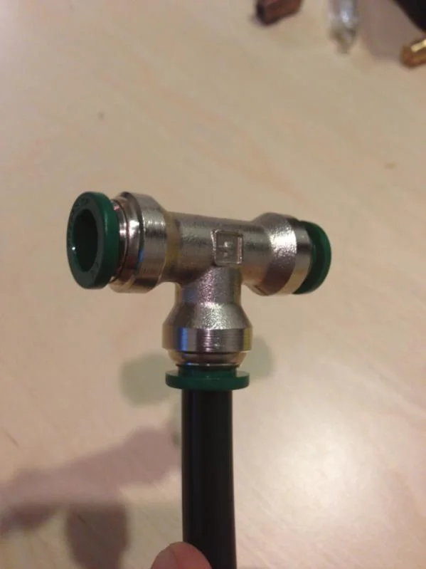

Yeah there are those but I'm talking about something like a "T" fitting. Its in the engine bay. How do I attach this thing to keep it from bouncing around? Some of the solutions I've seen don't make me happy.
