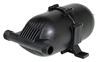

The rest of the Shurflo stuff arrived. So I now have the pump, the accumulator and the strainer. Now that this stuff is here I can start playing like Lego building blocks and figuring out how to get this all inside one bumper wing.
The boxing in of wings is done. Just some clean up left. After some thought, the pump nor the accumulator will work inside the wing even though it *could* have fit. It would mean too many compromises. I'd rather mount the pump under the truck somewhere.
