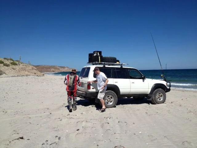

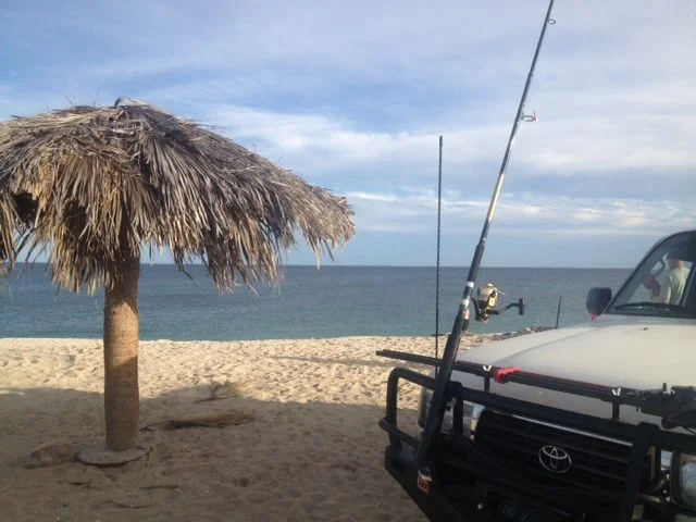

Fishing pole mount?
Real useful in Baja, and even for running from camp spot to lake/river.

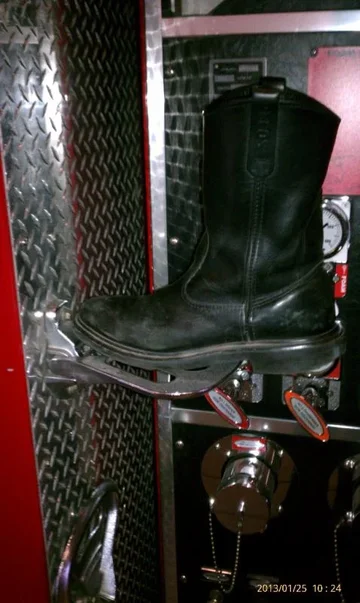

We use the larger ones on the fire trucks at work and they are stout and big. The smaller one on the right is stout enough and I have a few squirreled away for that exact use in the future.

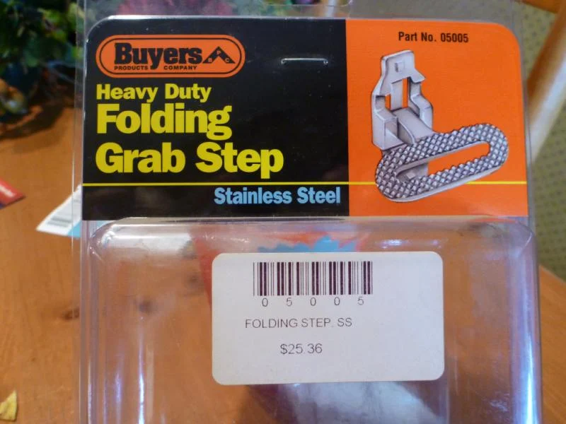

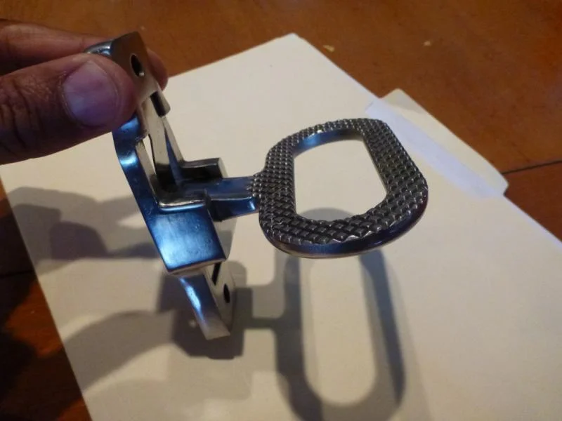

So I was thinking about access into my engine bay with the 4" lift coming. Anyone mounted fold down steps?
Something like these:
3VTD6_AW99
3VRY7_AS01
Real men don't need these things.....:flipoff2:

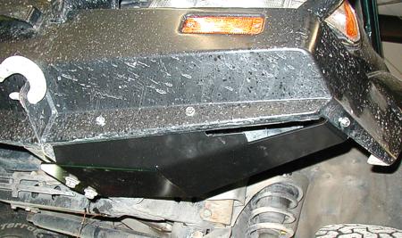

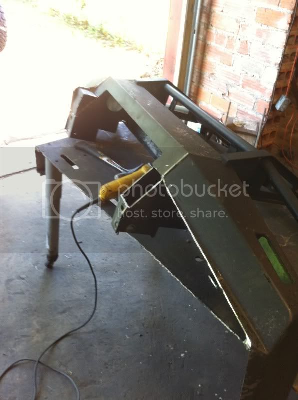

I like my Slee A/C Drier protector. Pretty much an expedition rig here, too. The Slee follows the lines of the lip, so if you're gonna trim, you'll want to consider whether you can relocate it upwards to follow. Not sure exactly how much you have to work with in terms of changes still protecting the drier.
Guess what I'm saying, without some additional work, trimming the lip and adding the Slee plate are kinda incompatible.
Yeah DYNOSOAR and I pretty much figured that out as soon as we saw it. We may just fabricate something to use in the meantime until I find a good JDM solution for the drier placement.
