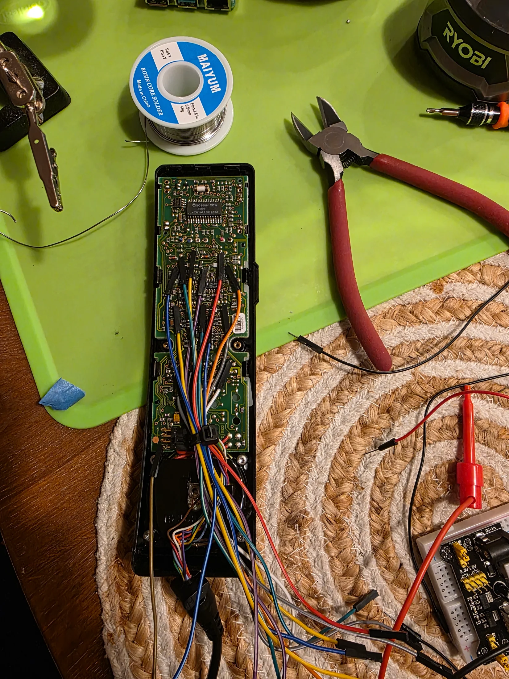

My LC came with an old, non working Motorola car phone. The LCD was shot, but after some tinkering it looked like the PCB was in quasi-functional condition. I couldn't fully reverse engineer it, so I re-wired it and hooked it up to a raspberry pi that then connects to my phone by Bluetooth. With this set up I can power it on, type in 10 digits which then get sent to my phone to place a call, and hang up all through the car phone keypad.
Question for the peanut gallery: I unfortunately have to sell my LC (happy wife, happy life), so I'm wondering if people would be willing to pay a premium for this novelty. I have an open market minimum price in mind which is roughly what I put into the car financially, but I was wondering if the "working" phone could bump that up if I (re)list it on BaT.
Shout-out to desluder13 over at instructables who did a lot of the heavy lifting. Bluetooth-Connected Rotary Payphone - https://www.instructables.com/Bluetooth-Connected-Rotary-Payphone/. I'm happy to pass it forward and share my learnings/code with anyone interested in taking on this project.

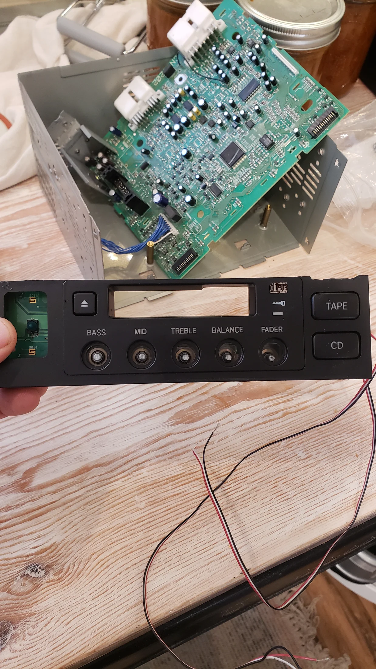

Way cool. I'm literally splitting the oem lx450 stereo in half and putting the cassette half below a single din bluetooth unit and combining them together. I'm also repurposing the steering wheel phone key pad as controls for the stereo. It's taken many lunch breaks and evenings. All that to say it's purely for me and I don't expect it to add any value to the truck (not that I'd sell, but I digress).

I'm gonna need to see pictures of this

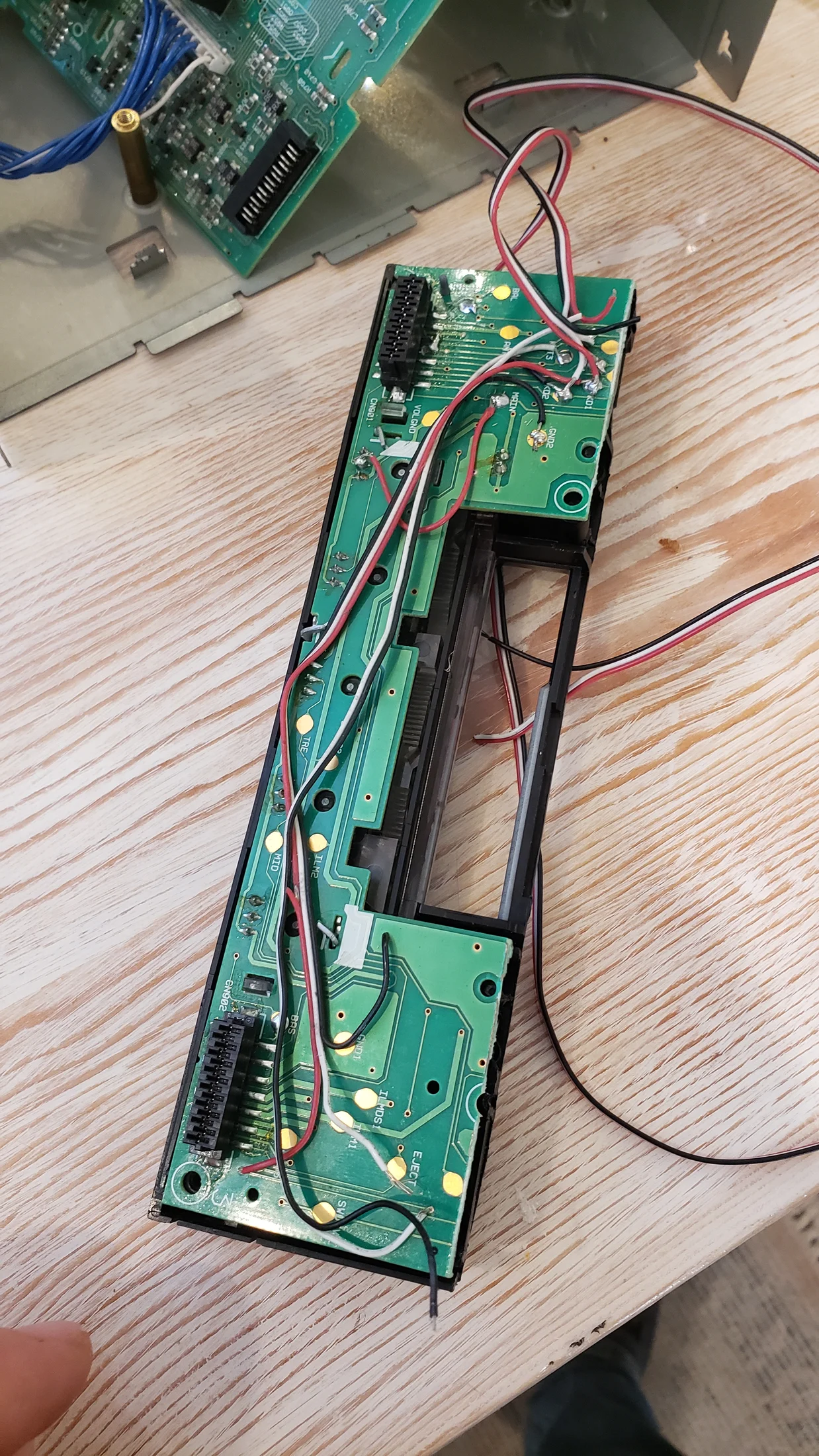

The cd button is rewired as the power button, the fader knob is now the volume knob. Stereo output is soldered into the aux input Jack on the other head unit. The UI pcb is the only one that needs to be modified and it's basically just traces, otherwise I don't think it would be feasible. The wires are there to replace the needed traces that got cut out. All but one have a test pad you can solder to which is very convenient.
I don't want to hijack this thread but I can make my own when this is done for curious minds

View attachment 3998792View attachment 3998793
How much are you asking? I’m in the middle of trying to program one myself. Send me a message and let’s talk more. Curious how you ran power.
