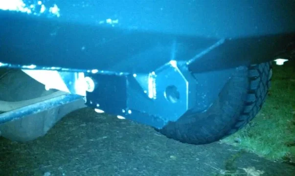

Great idea BTW. Cut those suckers off! Don't forget to reinforce whats behind them. There are nice bolt on and weld on options available. :cheers:
"I am looking at getting new D-Shackle loops because, of course, the ones on the ARB are just pathetic. I need to hunt down who makes them. I've seen them here but can't readily find them thru search"
I filled in the indention that says 'ARB' when I had mine recoated. I also drilled a series of small holes under the bottom lip in case I ever wanted side or center skid plates to attach.

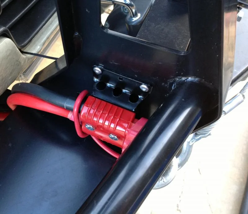

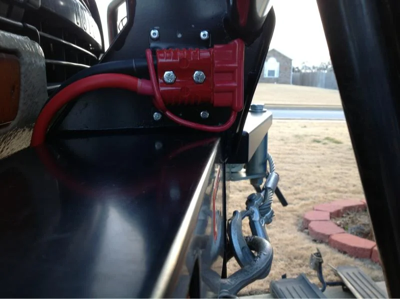

Here's an idea for your jumper cable connector:
Not sure if Tom Shepard would approve though... LOL
Sent from my iPad using IH8MUD

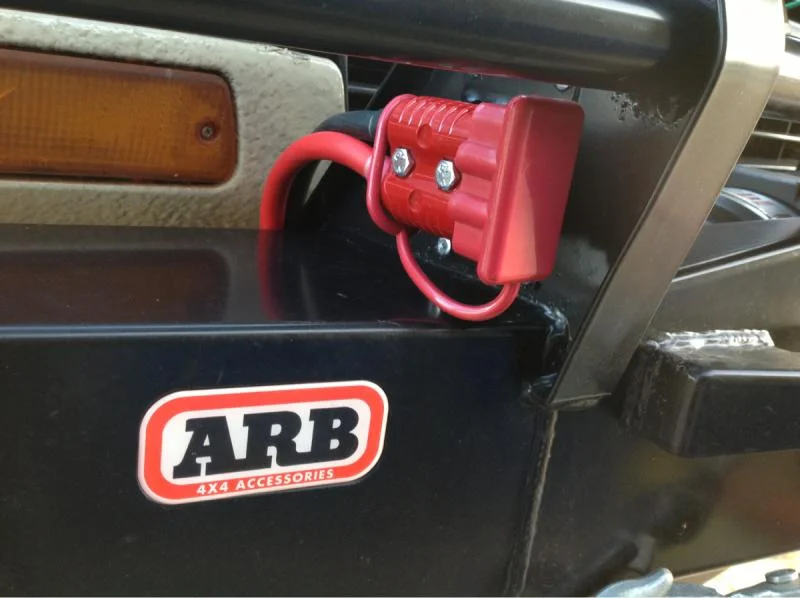

Tim, do you make the bracket that the plug is bolted to??
About as well as my S/C install. And my barrier install. And my P/S reservoir install. And my drawers build. And....and...and... :flipoff2:
LMAO! I know how that goes man, believe me. Well, maybe not to the extent of your list, but I have a to-do list that never seems to shorten, no matter how much I get done.

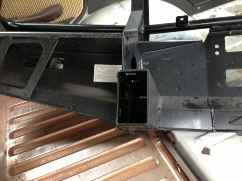

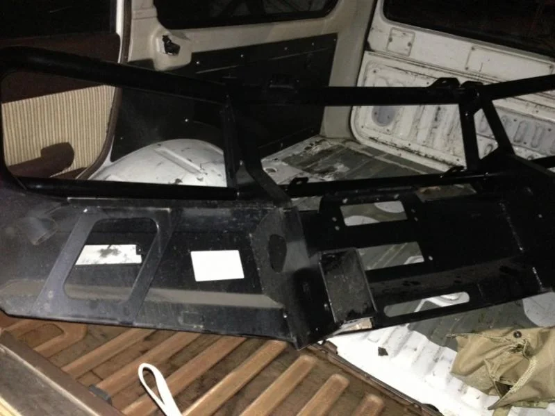

BTW here is what the bottom and back of it looks like. Is this a different design because I don't see the lip that others refer to. The wing for sure needs love.

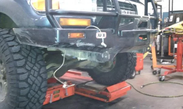

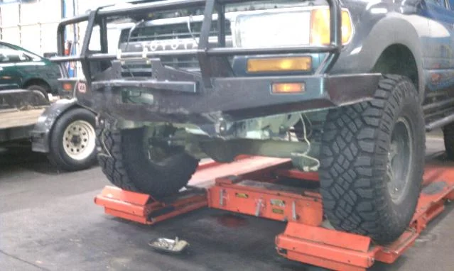

Joey on my ARB although a 60 series.. I boxed the wings n welded shut the front turn signals.. n cut out an access hole panel at the top for tools n tire chains...
