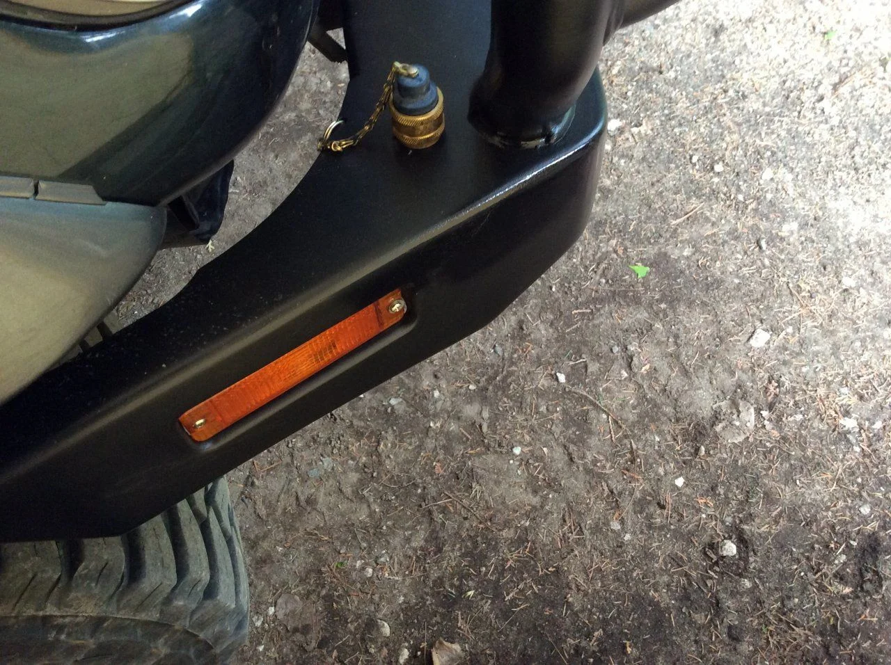

I like it with the exception of the quick connects. Facing up like that I see them getting filled with all kinds of crap causing leaks when used or even them seizing up. At least in a place other than So Cal.
Totally agree and plan is in the works already. I'm going to replace with Parker all stainless and their tethered caps to prevent just what you mentioned. I prefer straight up vs out of the bumper because when I'm working on the truck's engine bay I don't want to be bumping into the air fitting. This way everything is out of the way.
Agreed - can anyone make a salient argument as to why this is appropriate? I have always seen it as an unnecessary risk (theft, becoming a very fine missile in an accident, reducing visibility, etc).
I don't want worsen my already reduced visibility and during an accident I need to rely on the two bolts holding it down, which no other mechanical lock, to keep it from javelining in an accident.

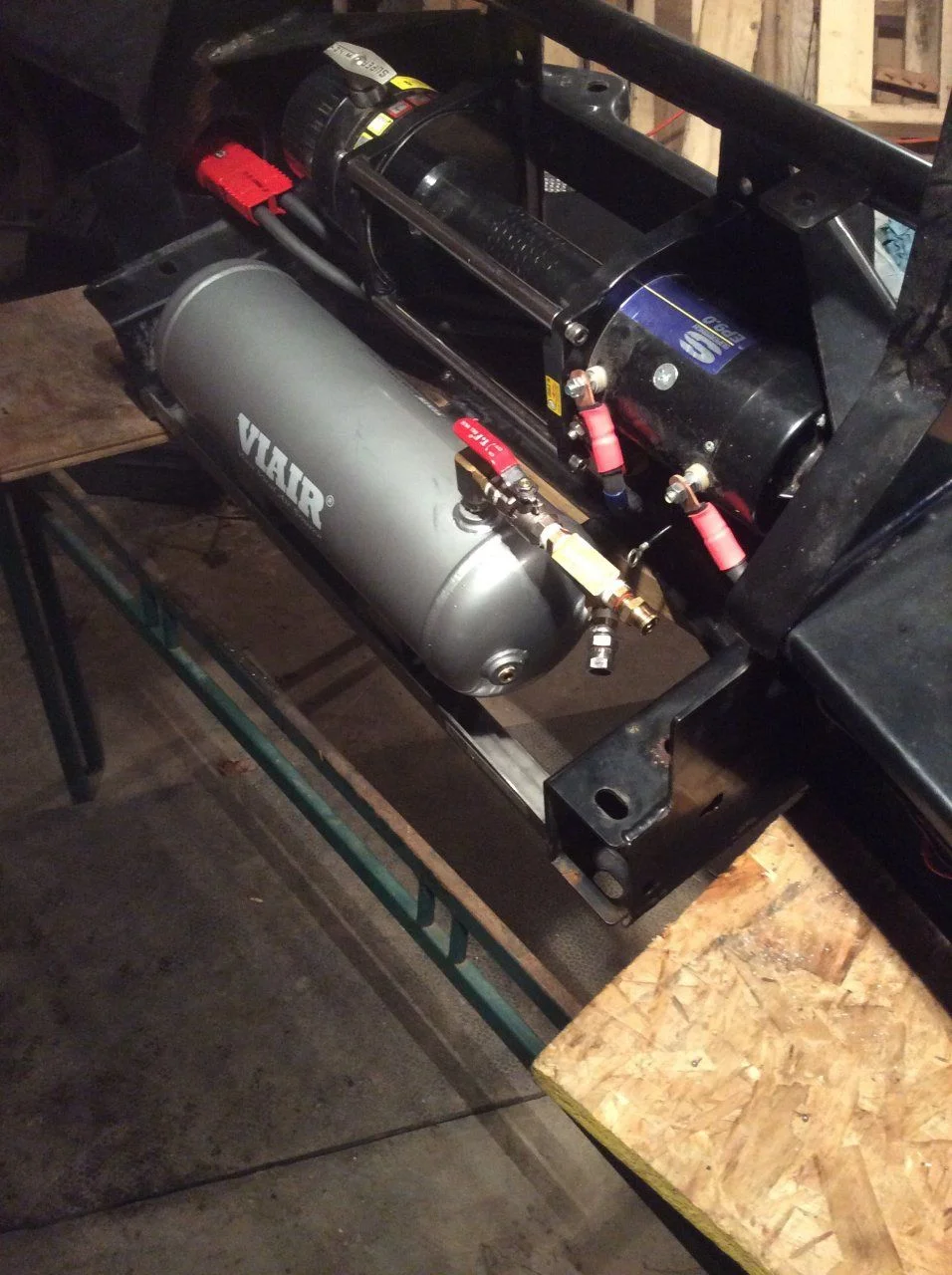

Just throwing this out there, but a potential kit could include provisions/ hardware to mount a 2 gallon air tank behind the bumper.
Here's my quick connect (brass) with cap.
What I meant to say was that I completely agree with not mounting it there for exactly those reasons.

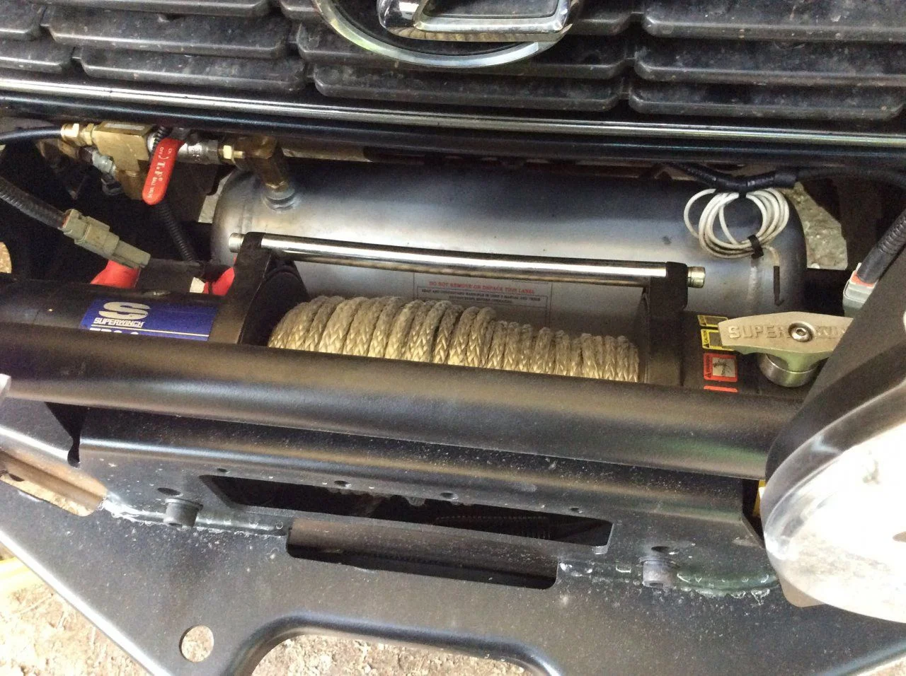

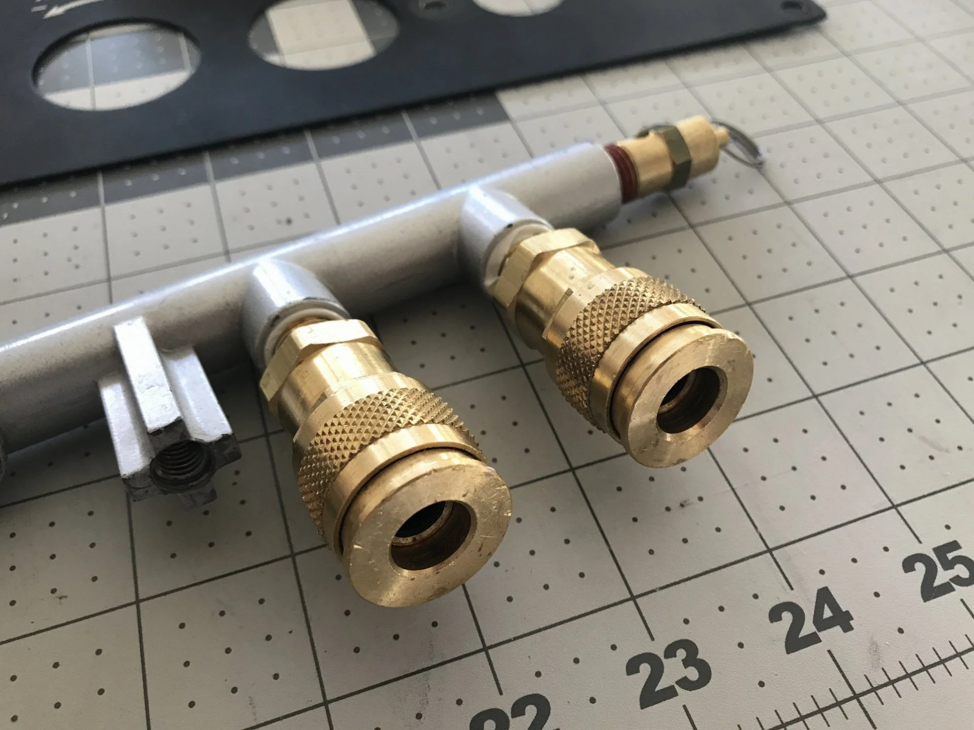

After a few years of use it's time to start giving the bumper some needed attention. I've removed the OBA Manifold on the bumper because the cheap crap that was on there was just looking bad and the air fittings both stopped sealing. Replaced with new Parker fittings and some liquid filled gauges.
This time all the hardware in that area (NOCO plug, panel, opener) - screams the need for SS button-head cap screws.
