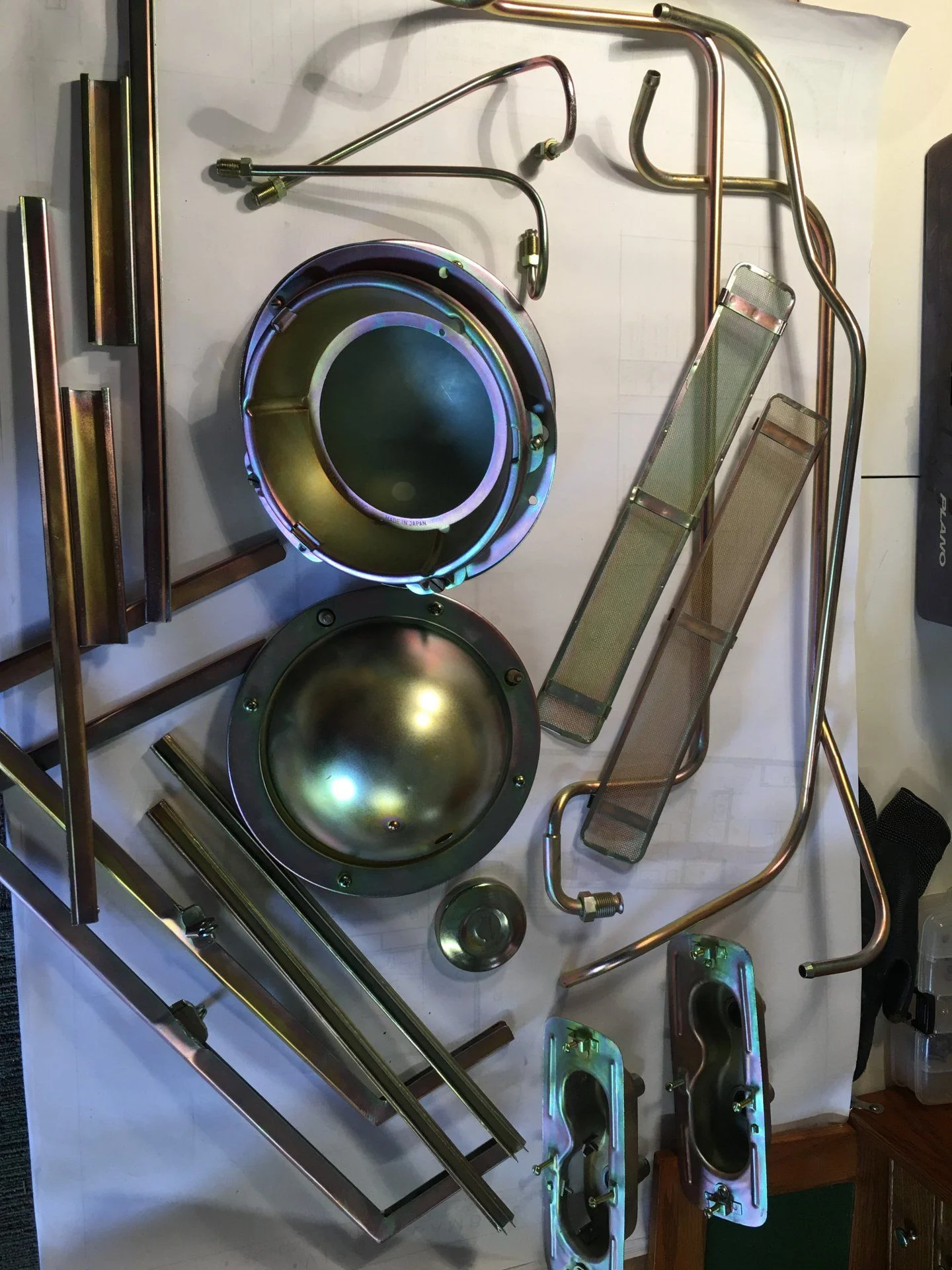

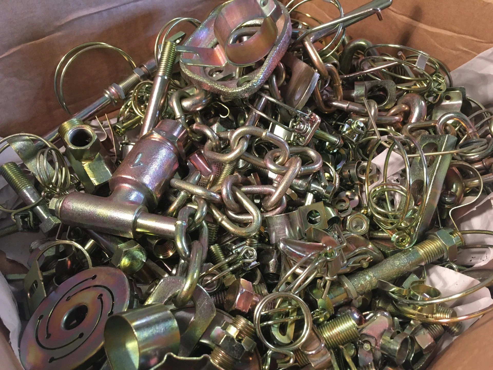

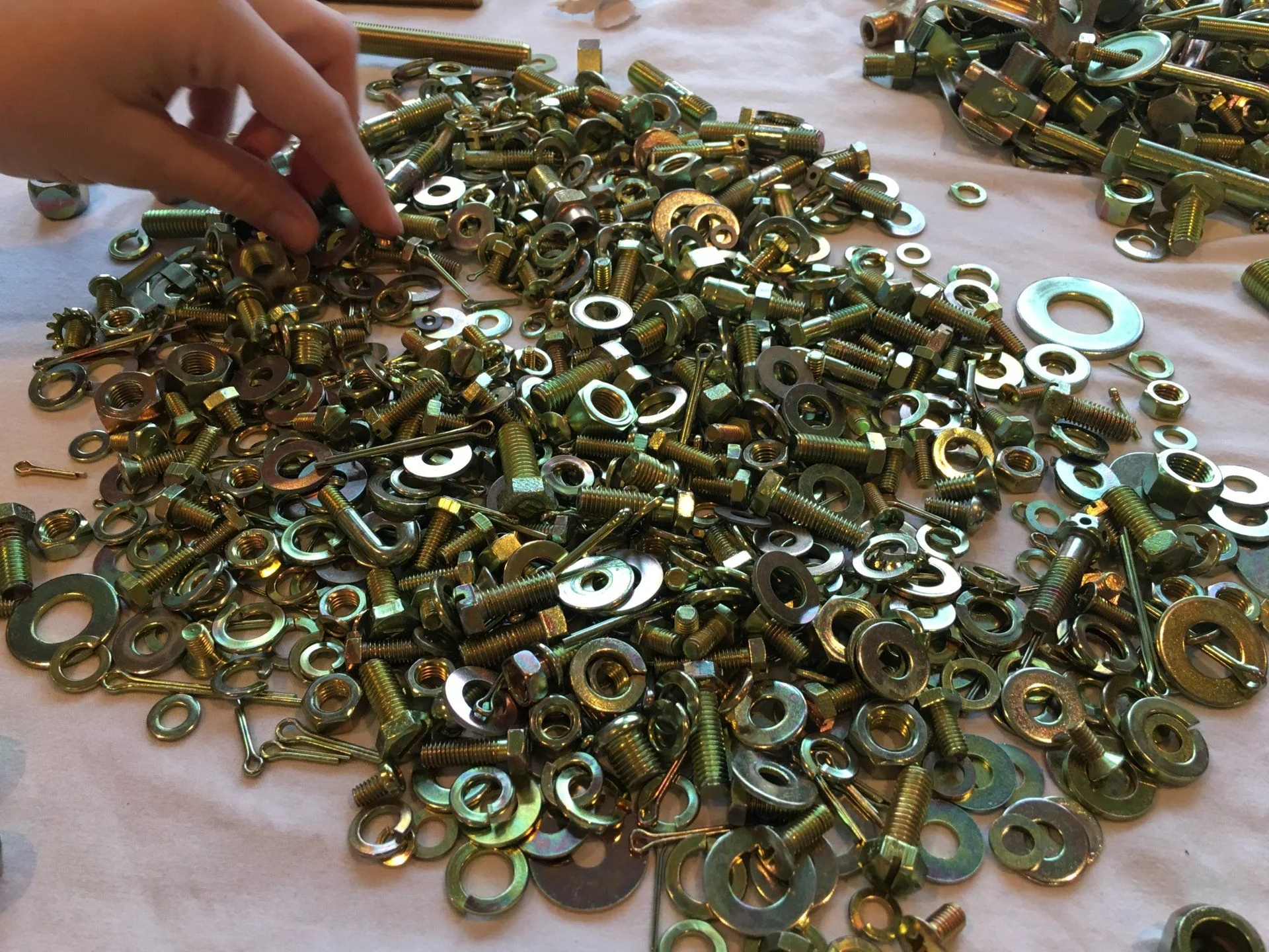

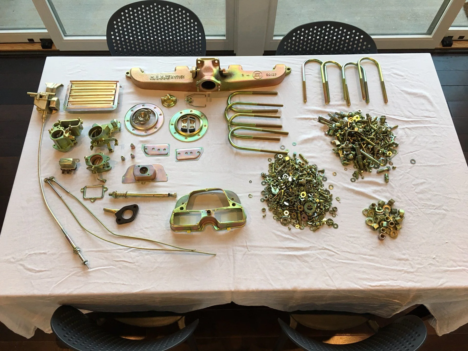

I used TFC plating in Portland, OR at the recommendation of ccpilot. I degrease, blast, then wire wheel all my stuff. Price is insanely reasonable at $125 for an 80lb batch. See pics below.

Wow, that’s a great deal on plating. Especially with parts that look so good. It’s hard to find places like that in New England, especially at a good price. The manifold will lose the zinc pretty quickly due to the heat, but it will get you a little more time before you see red rust.

@ClemsonCruiser just how clean did you get those small parts/bolts before sending them out? I've been working on a 5 gallon bucket of hardware (nuts and bolts mostly) and have degreased then tumbled (in walnut shells) most everything.
I was then planning on chasing the threads (with a thread restoring kit - https://www.amazon.com/gp/product/B000P6UNHE/ref=oh_aui_detailpage_o00_s00?ie=UTF8&psc=1 ) and then wire wheel.
Is my plan overkill or should I do more prep?
Also, how did you ship from SC to the plater? USPS flat rate?
