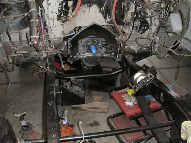

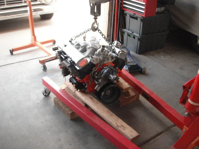

Orion finally meets the real 465 and go for a roll under the Cruiser
Much creative rigging to get this monster inbetween the rails
In place with the crossmember.. hopefully tomorrow Mr engine comes back to the party.

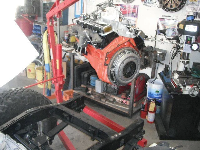

Another major milestone milestone day:
Freakin @#)$*&$$#$ clutch fork boot was a particular pain in the arse to get installed. :mad:
Engine parked on floor for a new pilot bushing and clutch install.
Precarious dangling portion on install always keeps me nervous about the quality of Chinese hydraulics.:rolleyes:

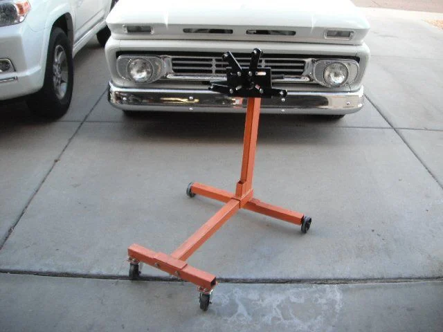

After much huffing, puffing, grumbling, pondering, levering, jockeying and sweating. The one man mechanic show gets the slug installed.
I am beat..........:rolleyes:
Last pic is of an empty tool I hope to not need to use again for quite some time.

Stock under manifolds has worked well for me since 1996. (wires from Sept 69 Bel Aire... To match motor)
Motor seems tight to drivers side frame rail...:hhmm:

Yes it’s probably tighter than most. The result of the ill advised attempt to center the drive train earlier in this project. It was later moved almost back to original placement to minimize rear drive shaft angles. Proximity to the steering shaft worse with a Scout box.
Put a spacer between the Scout box and the frame, maybe 1/2 to 3/4". This will give more clearance to the steering shaft, and maybe enough room for the plug wires. Will involve increasing the length of the relay rod though.
