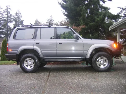

In this picture, I have a 90lb box of gear & tools, 20lb CO2 bottle, and my 35" spare.....still sits on the high side of level.
I'm wondering what all the guys running heavy front/ meduim rear do when they load up the truck with lots of gear in the back? You have a level stance on the street, but then when you go to use the vehicle for what its intended for, the back end sags under the weight? Doesnt seem very logical to me, but I'm new to LC's being a Rover guy all my life...

vccruizer is that ur 850/860 combo with 35's?
In that picture, I also have the 30mm spring spacers from Manafre on all 4 corners. I addd these for additional lift so I could wheel on more aggressive trails. The picture below is without the spacers. 35s in both pictures.
You have med/med, correct? And in that prior pic you have your 4x4labs bumper, also correct?
I've added a dual battery, ARB and M12k up front, so I know I need heavy there.
In the back, I'm in the process of adding a 4x4labs bumper and sliders. I always carry a fridge (nearly 100lbs when loaded) and usually carry my CO2 tank, small set of tools, recovery bag, etc.....I was planning to do heavy in back, but want to be sure I'm not going to be a 45-degree stink-bug and funky looking.........will the mediums be a better choice?

Not the best pictures, but will give you an idea on how it looks. Here's mine with 850/860's (Heavy/Mediums) and 285 Nitto Terra Grapplers.
