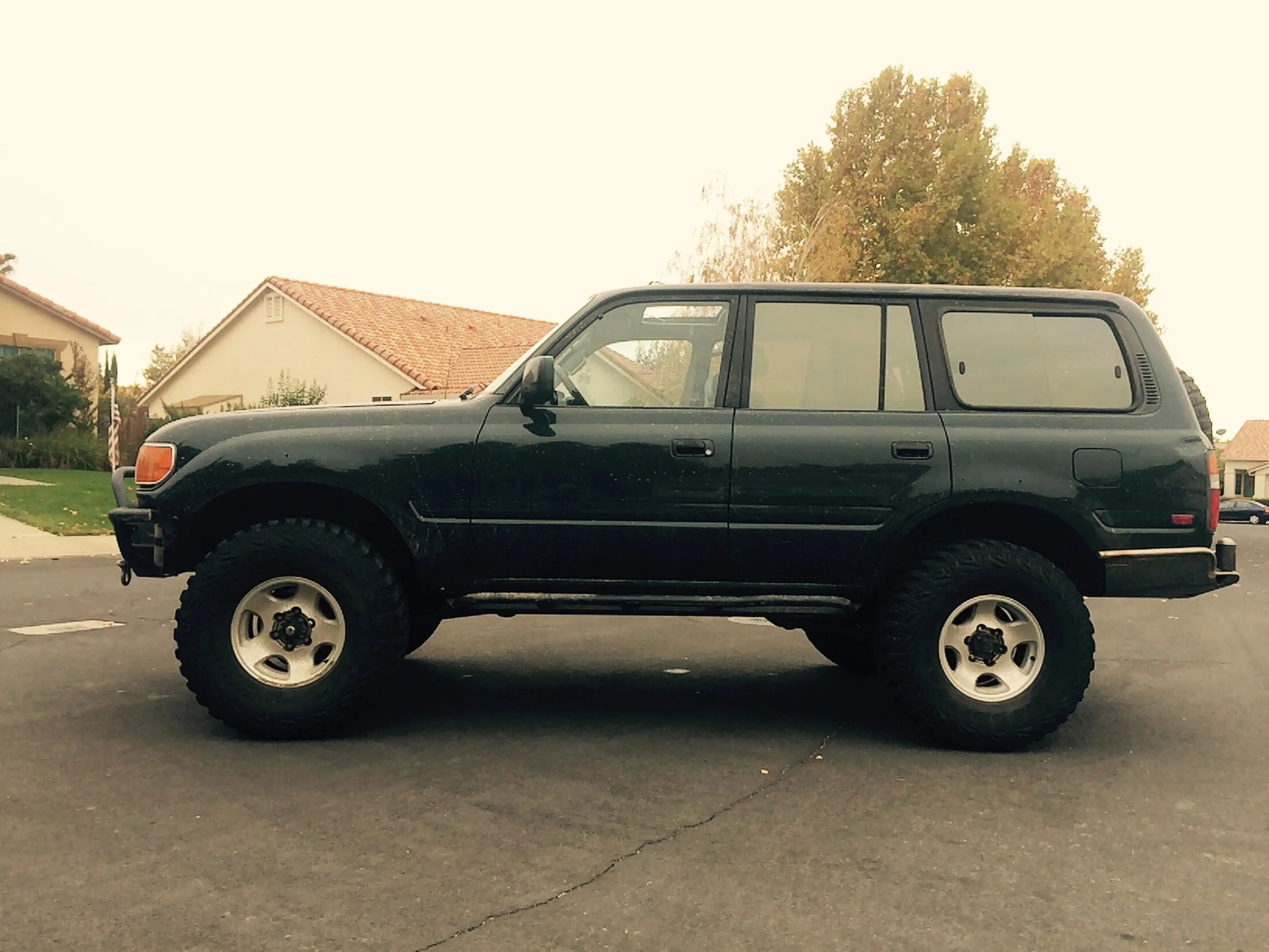

I have J springs and net about 3” of lift. The rear will sit higher without significant weight.

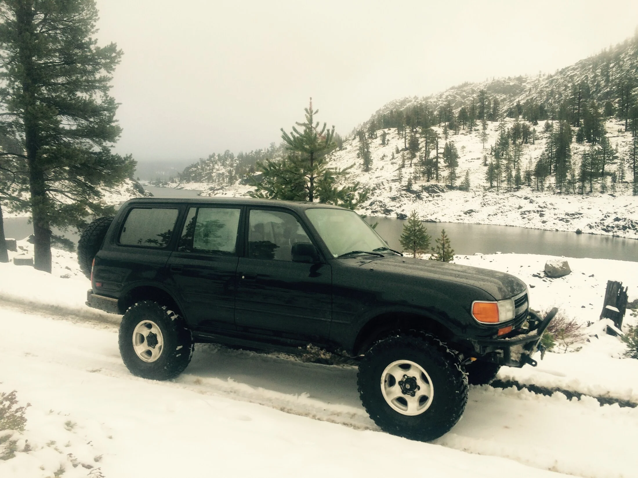

The first lift and tire combo I ever ran on an 80 was OME 850j/863 and 35’s. This nets a nearly level stance with a very light front and 275 pounds of rear bumper and spare tire with enough room around the tires to let them articulate off road.
Mine is unloaded, came with J springs, and sits at about 4.5" depending what you consider stock center-of-wheel to fender flare measurement.
The front has a 2" spacer for the truck to be dead level.. which suggests the 850J upfront nets 2.5, not the advertised 3.5. As noted above, OME listed lift amounts are not exactly known to be accurate, but it depends how your truck is set up.
