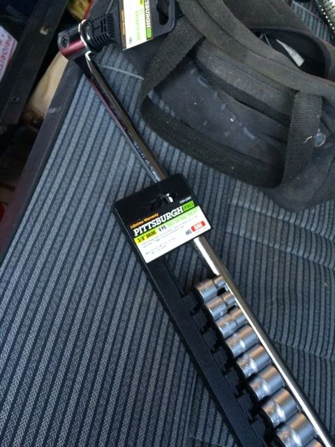

I love having a harbor freight in town. I'll give it a try with these anti strip and the breaker bar this weekend and tell you how it goes. Sadly I work all day tomorrow but maybe I'll pull out the work lights and get it done in the cold.
That set-up looks like it might do the trick. Finding the right tool is often half the battle...

So even these sockets are stripping... I'm gonna try to man mode it and just cut the bolts off.
Hmm...it's hard to read from the image you posted above, but is the socket set you got from HF the 'Extractor' kind here or just regular socekts?:
http://www.harborfreight.com/9-pc-38-in-drive-metric-bolt-extractor-socket-set-67894.html
Other thing to confirm is that these bolt's that are stripping are actually bolts or just a part of the cross member that has threads in it (think along the line of a nut that has been welded at the bottom of the hole in the cross member) and the bolts actually come out from the top (between the top of the cross member and the bottom of the gas tank)...
Have you got a good picture of these stubborn bolts/nuts?
Also for the bolt-out sockets, it looks like HF sells a SAE and Metric kit, be sure that you got the metric one as the SAE may be just large enough to keep stripping the head.
I didn't see the metric at HF. So I have a SAE, which is probably part of the problem....
