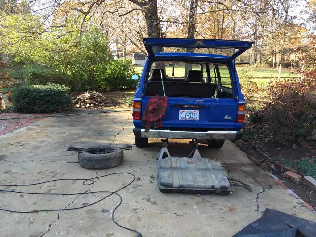

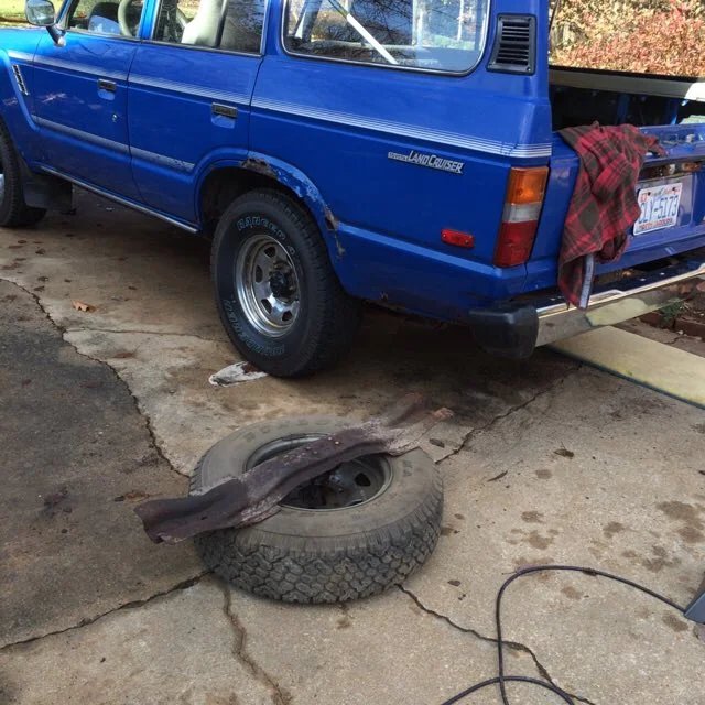

BUT. I got it off guys!! wooo the tank is on the ground too. Already lots of crap before i've even gotten into the tank, which I'll do today.

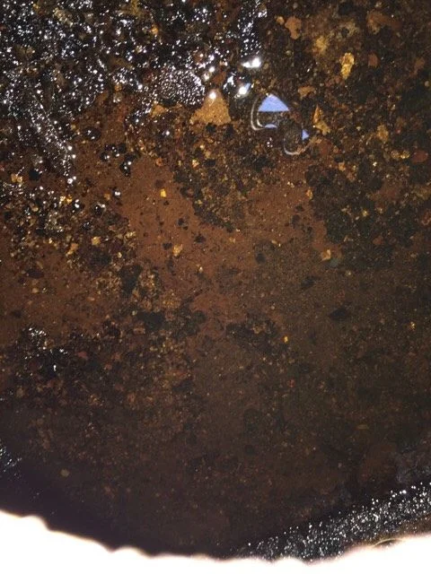

I don't right now.. was just planning on rinsing it out with water and seeing what it looks like. I figured if it wasn't that bad i'd just slap it back on. I don't plan on letting it sit so i'm not too worried about it rusting again.

Hmm...sounds like you need to come up with a plan on how to properly clean and maybe treat that gas tank now that you've got it out.
Just shooting from the hip here, but I would avoid using water to wash out the inside of the gas tank...why not use clean gasoline?

Water is also not a very good solvent. You need some form of cleaner/degreaser to get rid of gunk, and then if there is rust you need to treat it with acid. A quick google search will reveal lots of options for degreasers, less expensive options include dawn dish soap and laundry detergent.

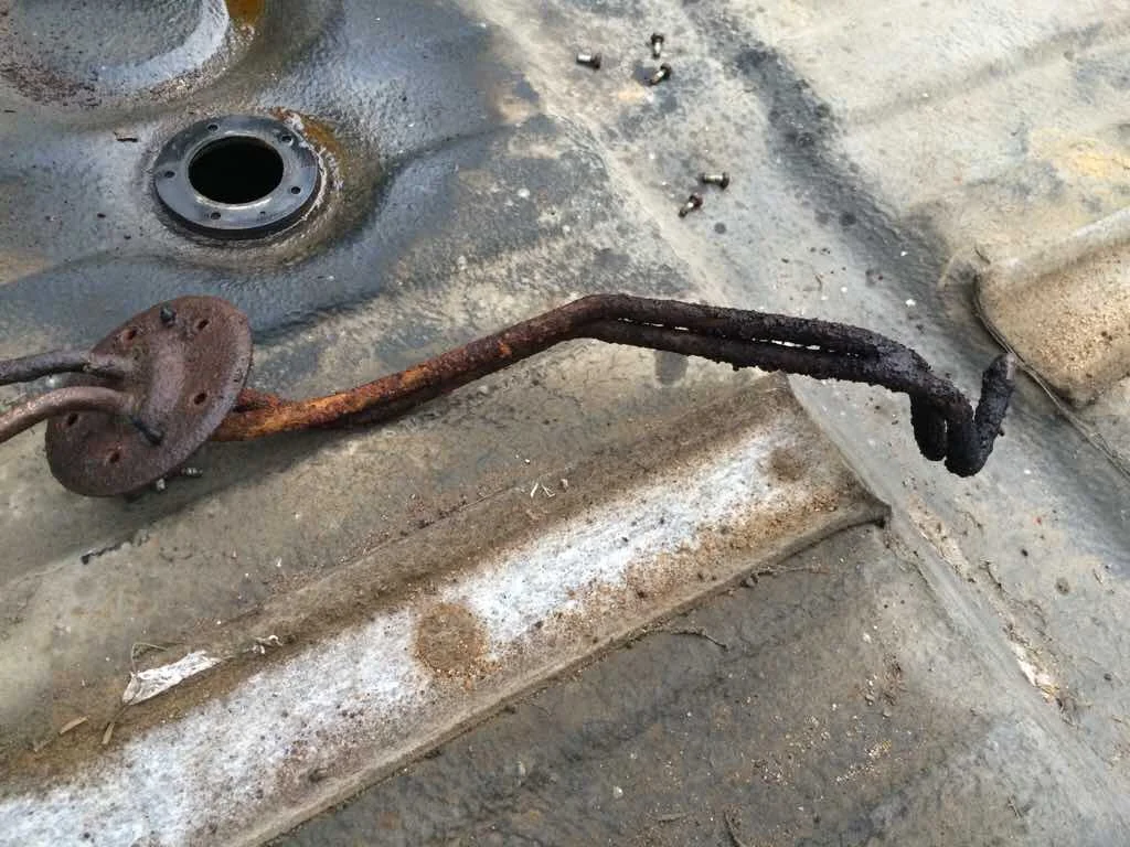

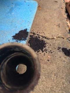

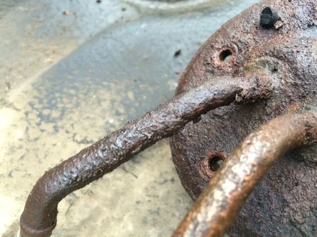

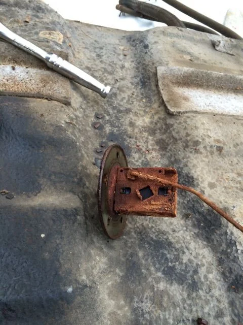

I cant believe this beast ran at all. I'm in awe of how much i drove it with it being this much crap ( theres not too much in the tank... relatively speaking)
-from the gauge unit
-from the sending unit
-The sending unit- i think thats the send line(?) has a freaking hole in it!! i could break it off easy.
-whole thing
-i wondered why my gauge didn't work.... the thing is so rusted it wont even move

I cant believe this beast ran at all. I'm in awe of how much i drove it with it being this much crap ( theres not too much in the tank... relatively speaking). The sending unit- i think thats the send line(?) has a freaking hole in it!! i could break it off easy.

Fugly...looks like you're in for a new sending unit and gauge...and a good cleaning...
The stock screw holding in the sender and pickup plate are little phillips, easily rusted and mangled. Apparently somebody has done this before and upgraded to tiny hex-heads? Either way, that tank really should be discarded. It will continue to shed rust for the rest of it's miserable life.
