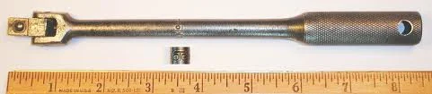

So just to make we're on the same page, you're sliding the Toyota tool with the hook on the end of it through the hole in the body of the vehicle (above the center of the rear bumper), mating it with the slot in the tire carrier mechanism and then using the arm tool to rotate the thing counter clockwise...

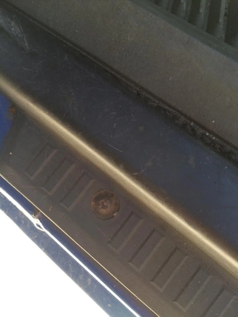

I can't really get access to the wiring where it passes by the doors cause of this -View attachment 957221
and all the screws on all four doors look like that. Any good way to get em out?

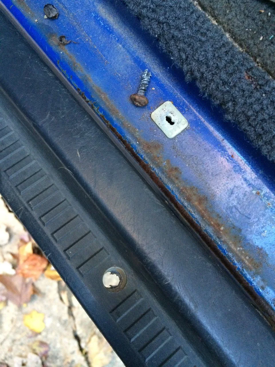

Did you ever get these screws out? Keep soaking them in PB Blaster penetrating oil...
Another thing you can do is to cut a single slot into the head, either with a hack saw or a disc grinder (or dremel if you have one), then use a single slot screw driver head (on a power tool, preferably) to try and back it out...
If that doesn't work, you could move on to using an extractor bit on a drill. If you go to Home Depot or the likes, you will find reverse thread extractors...first drill a hole down the center of the screw head, then use the right size extractor to back out the bolt (it grabs the sidewalls of the holes you just drilled).
I guess the very last resort would be to drill the entire screw out, but then you will have to retap the hole in the body of the vehicle since it will ruin the threads. Or you could cut/rip out the plastic (an act of true desperation) and then get some vice grips on the head of the screw...
EDIT: If you were able to get one of the other plastic guards off of another door, check to see if those screws screw into threaded holes in the metal of the vehicle body or if there are some sort of inserts/tabs that have threads, and then the inserts/tabs are pressed into unthreaded holes in the body...I can't remember which way it is, but if there are inserts/tabs, then if you ruin the threads getting it out, you should still be able to replace with new ones easy enough...

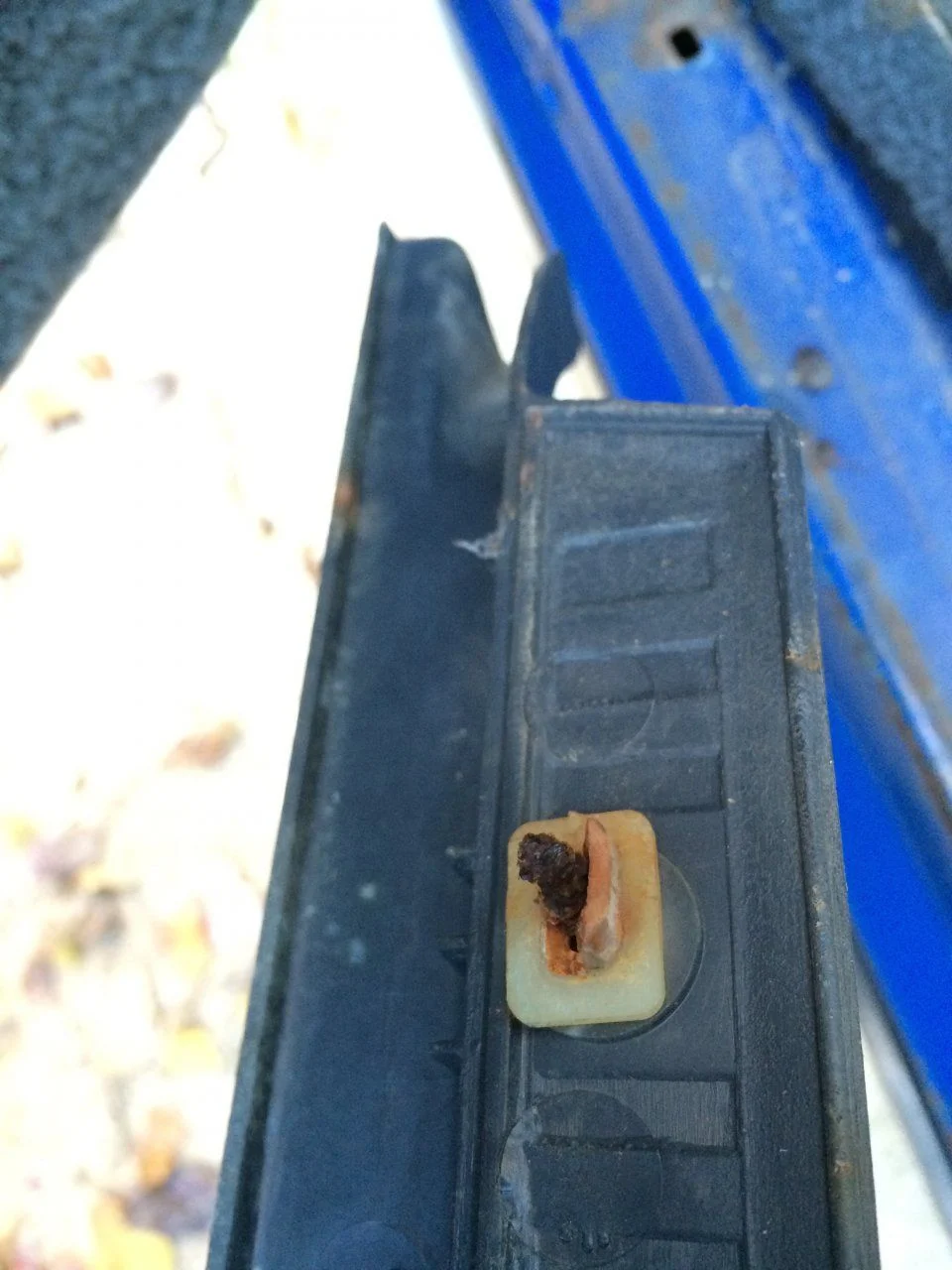

The doorsill screws are selfthreaders into plastic expansion nuts. A wrong handed drill bit will either drill off the head or back out the screw. Either way, the sill is off and screws can be replaced w/ SS.

Okay I don't have that nifty bar that connects into the back-side perpendicular. all I have is the bar that goes into the slot. and one that connects to that(to make it longer). And the jack of course(but thats pointless with the tire).

In tracing the wire I needed up having to just pull the plastic pieces. I only Broke one!!(of the screw holes) The screws went into those plastic piece like you thought. Also i found this lovely hole underneath my DS feet.
