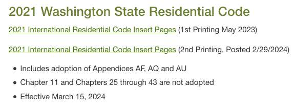

Going from your location, Washington seems similar to Pennsylvania in that they adopt the ICC (International Code Council) building code with amendments: Residential Code Amendments | SBCC - https://sbcc.wa.gov/state-codes-regulations-guidelines/state-building-code/residential-code-amendments
That can get tricky for someone not familiar with working with the codes as you have to figure out what parts control - ICC or State. You read through the ICC and think you know what is going on only to find that a State amendment overrules or changes parameters of it. I go through days of continuing education every time the new code comes out and still end up with some issues where things were not clear - not to mention issues with how the local building department decides to interpret things.
