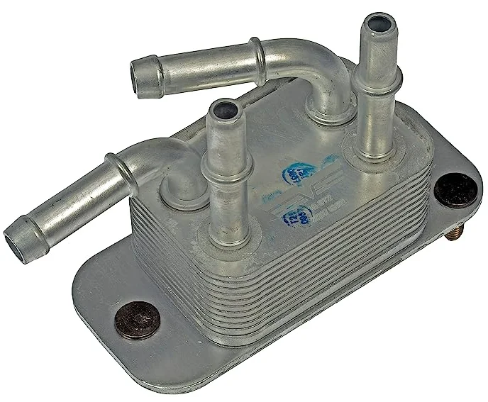

Something like this might be promising. The F350 Super Duty has this somewhat simple fuel cooler on the fuel return line. Two of the ports for the the return line inlet and outlet (obviously), and the other two ports are for a secondary coolant system to send coolant through (to help bring the return fuel down to a more similar temperature). It gets bolted to the frame rail. A cooler like this could be attached wherever convenient (and safe) on the LC, and then the coolant lines could get routed to wherever the coolest air is (e.g., right behind the grille) and then attach an electric pump and a radiator with an electric fan. The main question would be how much heat could actually be transferred from the fuel to the coolant?

VERY interesting.
Fluid/fluid coolers can transfer a tremendous amount of thermal energy.. we’d just need to figure out how much heat we’re removing and size the air-fluid exchanger appropriately. And add a coolant pump.. which in my experience will be the toughest part of this to make reliable.
I think the best thing to try first is pick the most reliable car brand (... Toyota?) and select an electric coolant pump from a model that has one (e.g., Prius). Probably will be the most reliable pump as long as it's a later generation model. The nice thing, even if the pump fails, it just means the vehicle reverts back to not cooling the return fuel (so worst case failure is that it reverts back to OEM functionality).
EDIT: Apparently VW & Audi (among others) also have secondary electric pumps for sending coolant to turbos. Not sure I'd want to go with theirs, but at least there are some reasonable options available.
One of my prior VWs had one. Usually 5/8-3/4” ports. I wonder whether restricting flow that much would be a problem. We’d see much lower temps and pressure than in those oem setups..

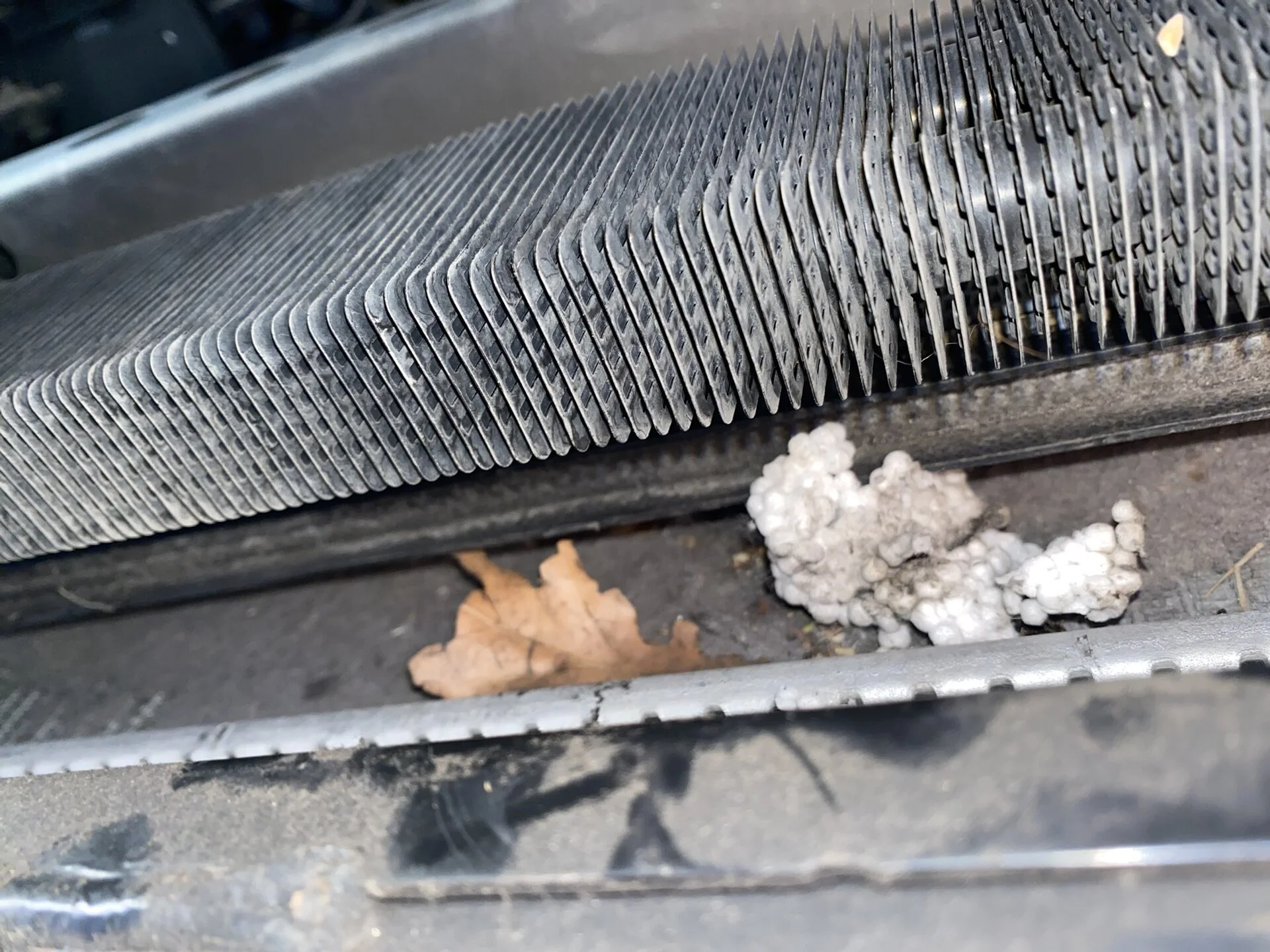

Cleaned this radiator for the first time, since replace 30K miles ago. It's driven city street & HWY locally only.

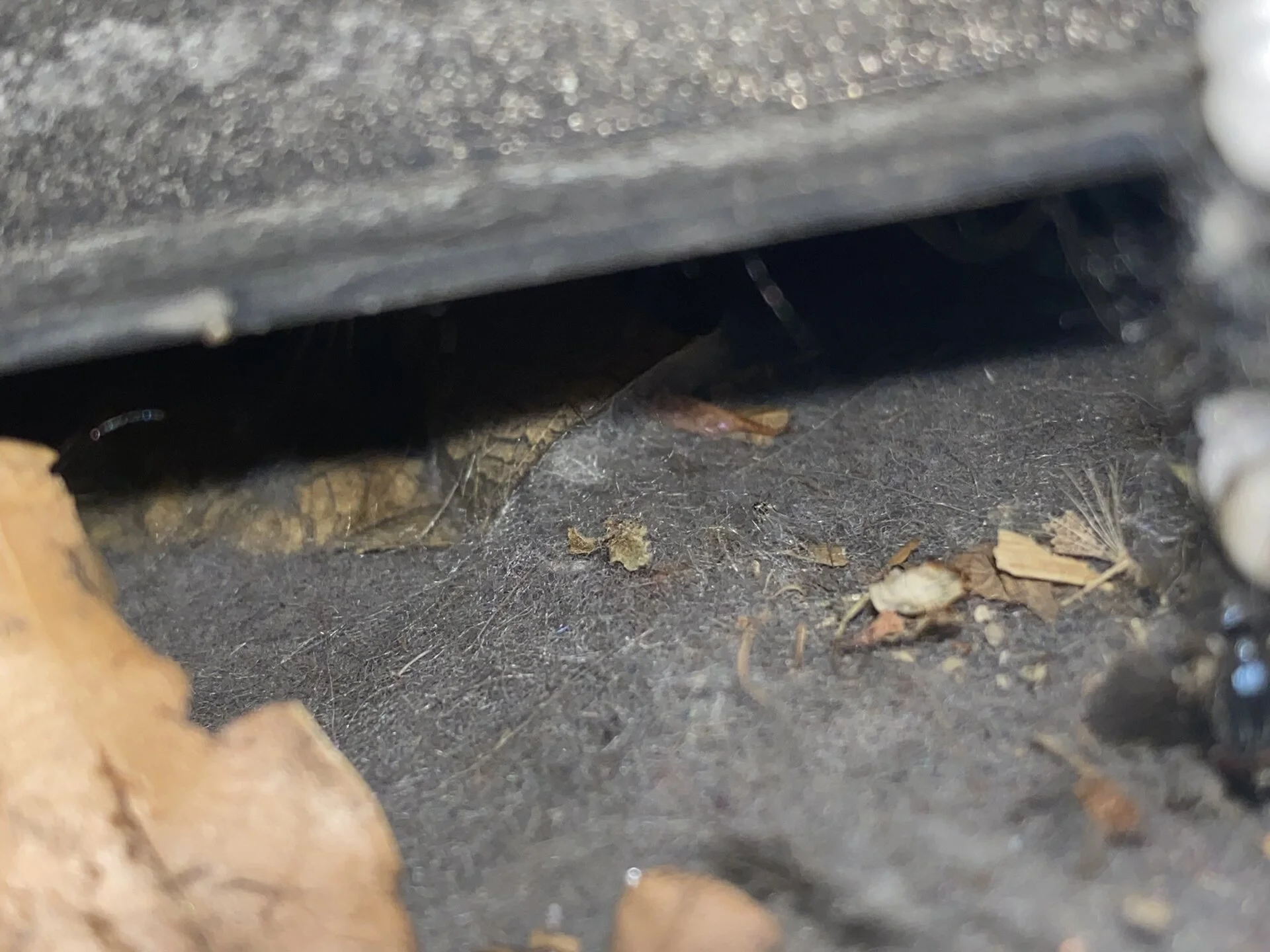

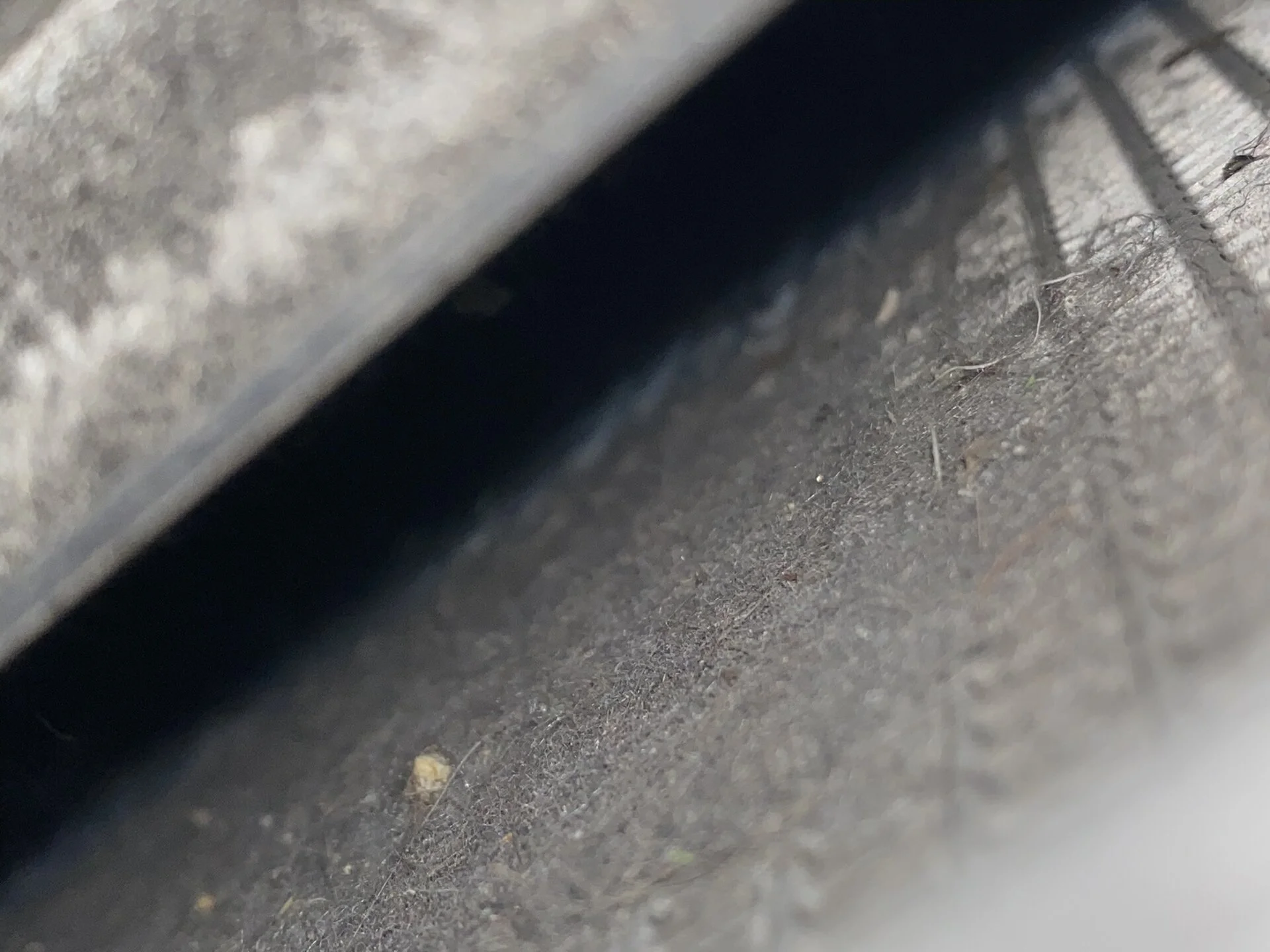

What you're looking at in post #209 pictures, is 3 radiators. The largest in the background with cottonwood, leaves, bugs, dirt, brake and tire dust, grasses and all manner of road debris. Is the engine coolant radiator.
I can assure you, that in matters a great deal that fins of radiators all be keep clean.
Engine radiator is an integral part of coolant system. Reduce air flow through Rad fins, reduces cooling ability greatly.
I've lost count of just how many Land Cruiser/LX. That come to me running hot, were owner has no idea it is. They'll say, dash gauge looks normal, some needles even below mid-range.
I'll hook up to the OBD port and log ECT (engine coolant temp), as I drive in afternoon sun with front & rear AC on max cold. On a day perhaps, 90f to 100F OAT. I'll see ECT around 190F to 200f, depending on speed and yr. As I come to a stop, idling with foot on brake in D. I'll watch ECT climb to, 200- 220F, the drop back as I drive.
I'll service the coolant system. This service begins with washing radiator fins of debris. Often includes a new thermostat, rad cap, flush and make sure reservoir working as it should. Some, a new fan clutch is needed. ECT then drops to 194F to 197F (98-02 184F to 187F). Now with AC on and stopped idle in D. ECT stay under 200F (98-02 under 190F). I can drive all day, HWY speeds and at a crawl, still maintain proper operating temp (ECT).
I've wash shovels full of debris from radiators. Which to really get one not cleaned regularly, requires hours of washing over days. Dealership and most INDY, just replace the engine radiator when they find clogged. Which is best! But if one regular hose out debris, they clean much easier.
We must have coolant system working at peak at all times.
We must have coolant system working a peak at all times.

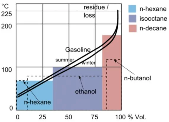

Found this article with this curve:
I haven’t been following this thread too closely so sorry if this has already been posted.
From the curve, at 140F return temp, the gas would be about 20% vapor. At normal driving conditions this would probably not be an issue as the tank temp would be less and the evap system would be doing its thing.
Now add high altitude plus 100F+ ambient temp, and 3 mph wheeling up a mountain it’s easy to see how how well get some boiling.
So why do some have issues worse than others? IDK but mods are probably part of the equation. It makes sense to me that full BB style skids may trap enough heat that the tank doesn’t cool like OEM and the fuel return temp could even be higher.
