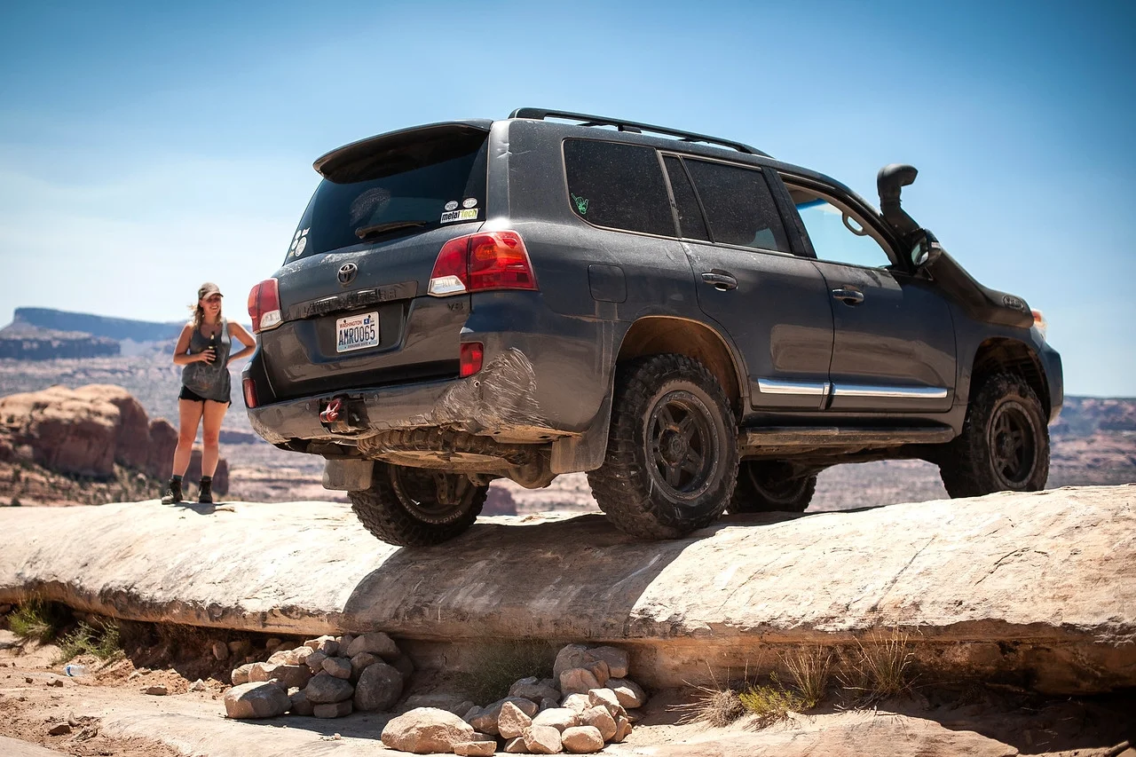

lots of issues with this and the 200's, usually a combo of heat, altitude and shaking IMO... first the smell of gas, second you can hear the gas bubbling in the tank or whatever the hell is going on, 3rd fuel starts coming out of the gas cap down the side of your truck, 4th you throw a code... Gotta replace the charcoal canister to fix it. We call it the Moab code cause if ya wheel in Moab(usually happens on top of the world) you will most likely throw this code, part of the game!
One thing you will notice if ya look close at any Moab pics I post with 200's is that sand/dirt has stuck to the leaking fuel down the side of the rig, been happening to us for 5 years now, guess we just got use to it 🥴 🥴 🥴 (usually only happens on the long rougher trails)
