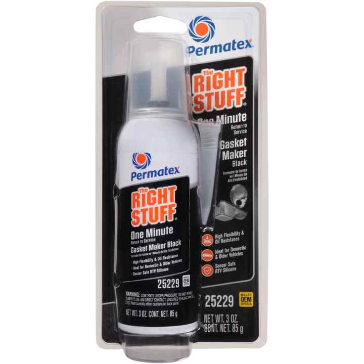

I pulled the valve cover and head bolt.
Used a heavy duty zip tie with a shop rag and poked that down below the galley blue port into the head bolt hole. You can drill and tap and then pull the zip tie out to clean out the hole.
I used two inserts and between the two I put “The Right stuff” to make sure it wouldn’t have a leak.
I agree that a right angle drill is a great investment for this job.
I have mine from when I did it a few yrs ago. Since it will hopefully be sitting on my garage floor, I am hoping to not have to do all the bending and twisting. Thanks for the tips.
