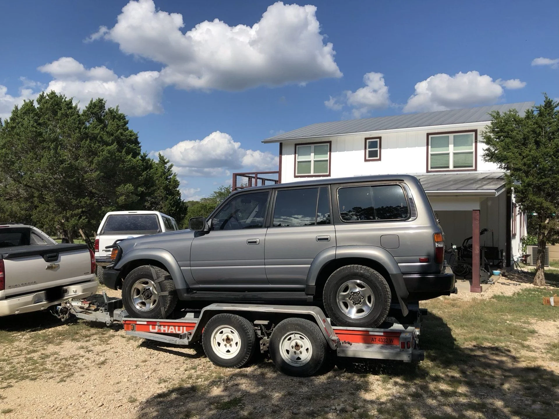

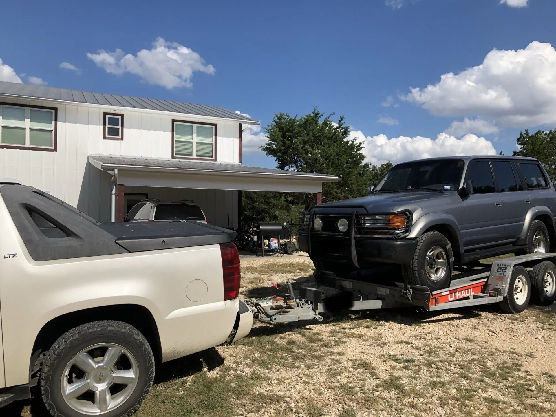

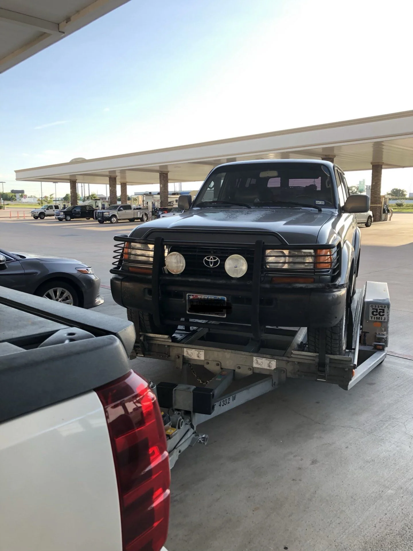

I purchased it in Wimberley, TX. Here are pictures from the day I bought it:
It was a hot mess, and the PO was over his head. He owned it for less than 3 months, and my theory is he passed it off to me, thinking it was FUBAR. 1/4" of oil coated the engine on every side. And I believe he cleared the CEL before I arrived. As soon as I drove it for 5 miles after purchase, it kicked on. Luckily for me, it was only a P0401.

A ritual of ours as well. To stop at Bucees after a cruiser pickin. Good looking rig. Love the color. Get the factory service manual. You can download here on Mud. Use google search to find things on Mud. Much better than Mud search feature. Welcome!

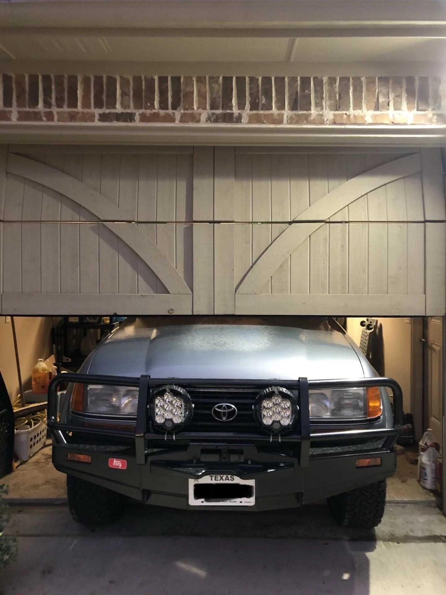

You'll want to get the 'damage multiplier' off the front of yours first thing.
Started in CT? Oh boy. Not sure we want to see the upskirt pics. lol
Except for year models...a twin to mine (also Moonglow Pearl and TEXAS).
Already done! And damage already done! Took a deer strike to the front left, but was repaired. Now has an ARB.
Thanks for the compliments! Funny you say that, 2/2 of the vehicles I have purchased in the past year have been at buccees on the same day of purchase.

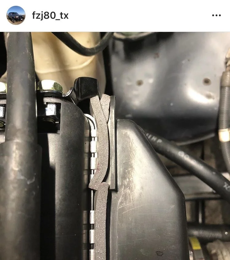

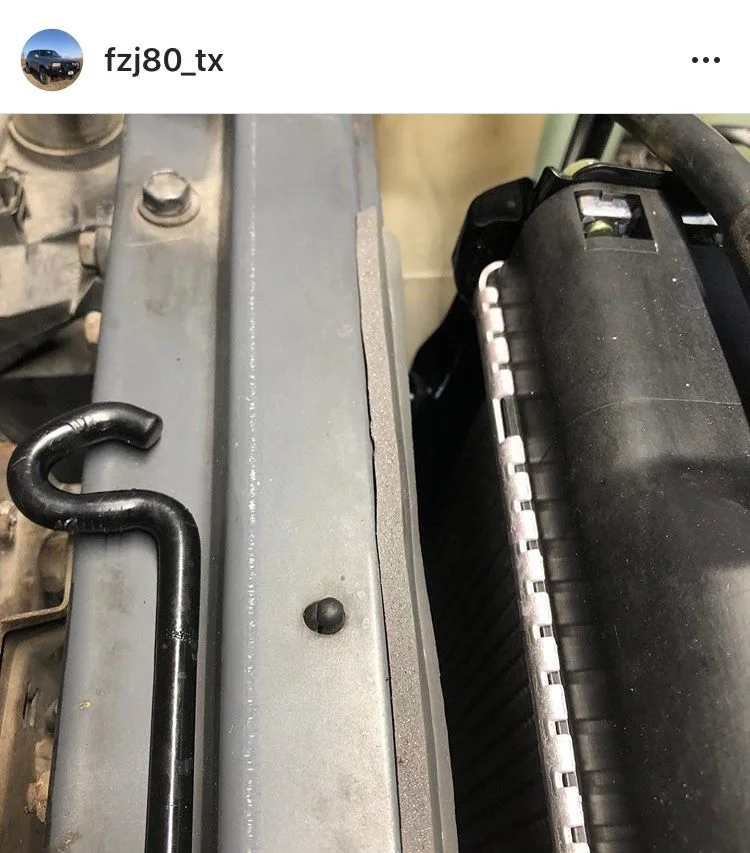

Second step- cooling system overhaul. All OEM hoses, and converted back to OEM Red coolant after what seemed endless flushing with distilled water. New Koyo radiator went in, as the previous radiator was leaking. Radiator and shroud got 360 degree gap filling of frost king foam tape to seal all gaps. I used 3/4" x 3/16" x 17".

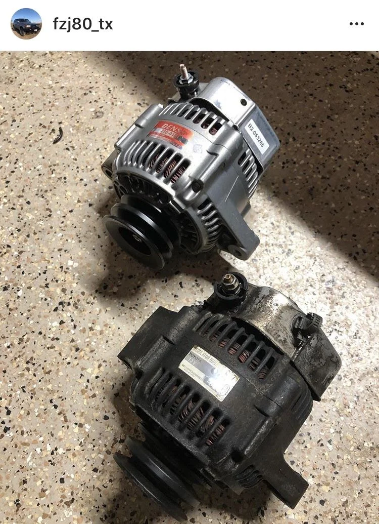

During this process, I also replaced alternator as it was drenched in oil. Photo to follow.
Here is photo of foam tape used to fill all gaps. I have not seen coolant temps get above 190 so far. The TX summer heat will be the real test...
Photo of old V new alternator. Went with remaned denso 210-0181. Cool part number, the wire zip tie that secures the wire to the alternator, is part number: 82711-1A840.

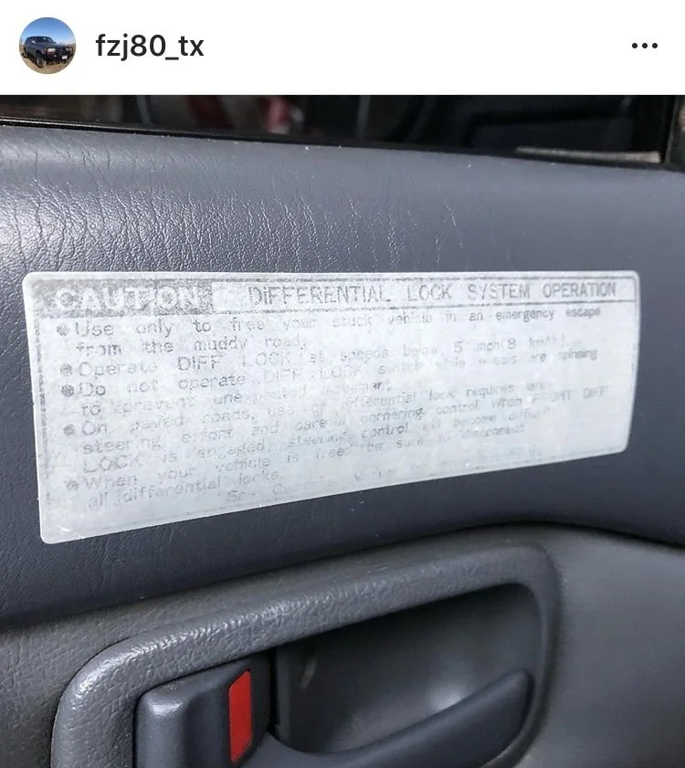

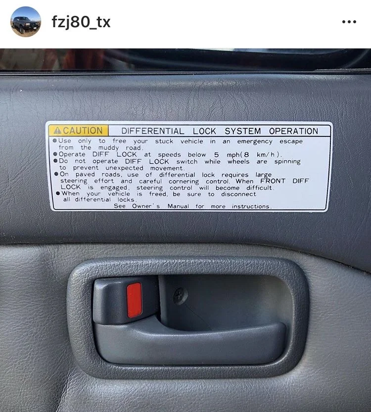

OEM everything, even down to the stickers. Super simple, and very satisfying. Do you notice anything? Classic situation of one job leading to another... door handle bezel is cracked. Will have to replace. OEM 69278-60010-03. OEM sticker: 41991-60061

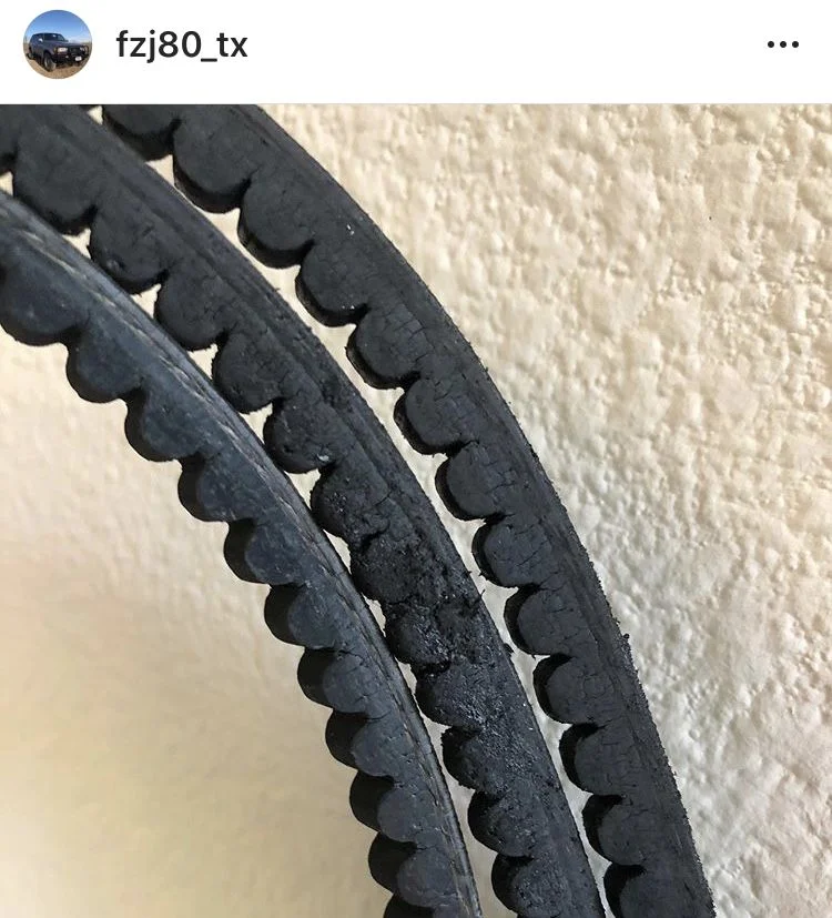

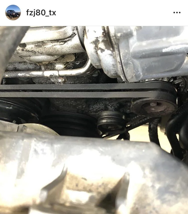

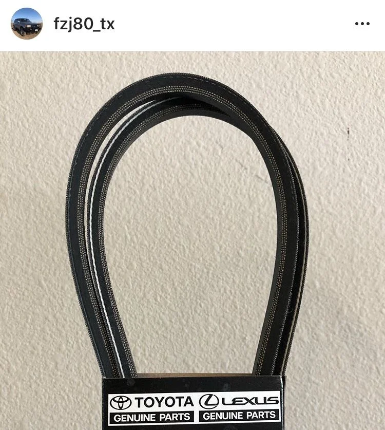

Swapped the belts. They were cracked, covered in oil, and squealed like a pig. New OEM belts, combined with all new pulleys has made for a much quieter engine bay.

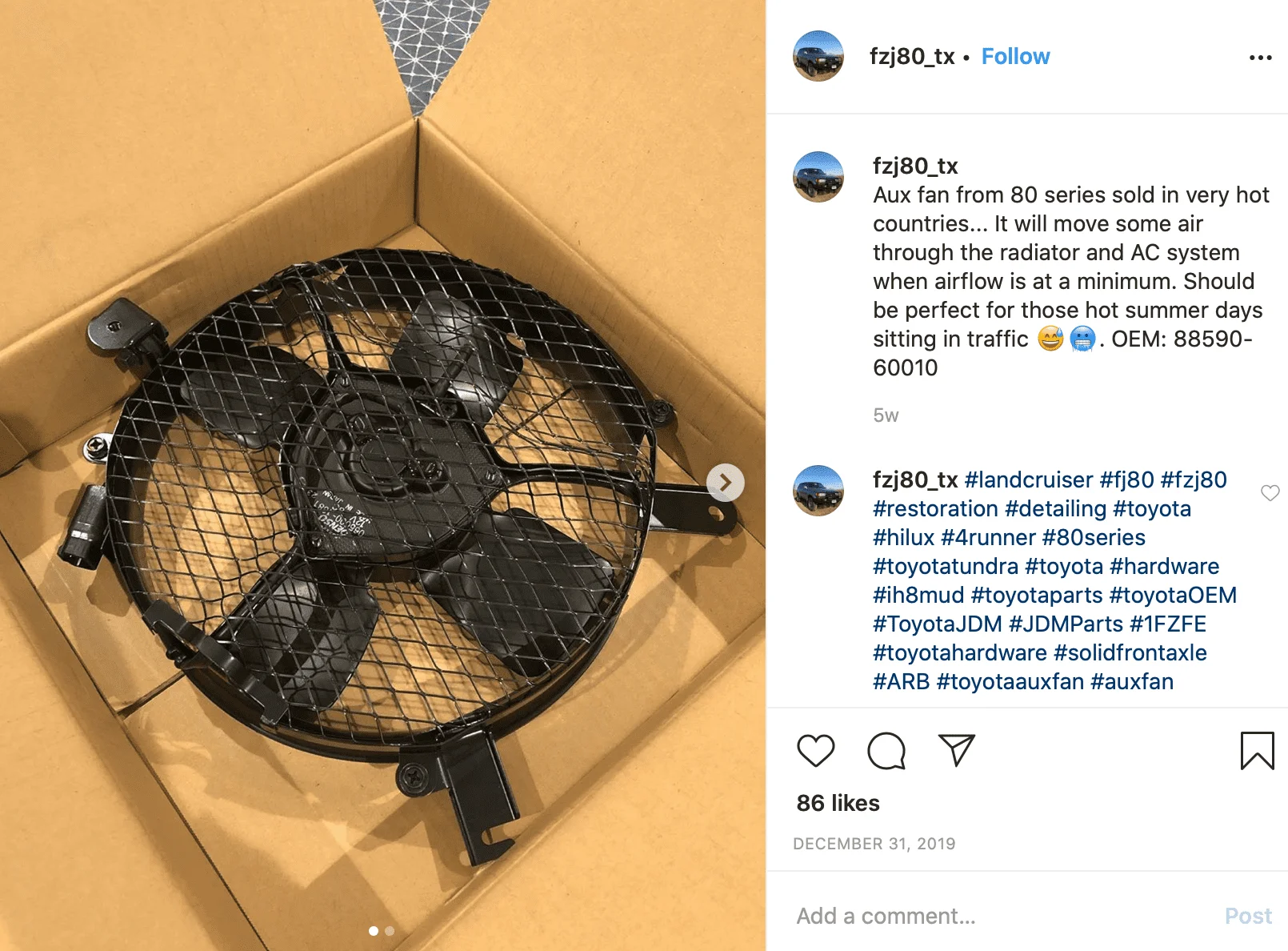

Sounds like you are on top of your cooling system, good job. IF you have any elevated temps this summer look at replacing the fluid in your fan clutch with 15K (cst) or 20K (cst) silicone. Makes a huge difference if your fan clutch is tired.
You can also add an 'Aux Fan' for your A/C condenser pretty easily...if your A/C isn't quite getting the job done at low speeds (stop and go traffic).
You've done a lot to it already....looking good!
Appreciate the suggestions.
Currently, it has a new OEM plastic fan blades and the denso blue clutch fan, I did not "upgrade" the fluid in the clutch fan though.
I actually have the OEM aux fan, I still need to be instal and wire it up after finding the appropriate plug from the local junk yard. Going to wire it up as a manual switch, to an OEM switch.

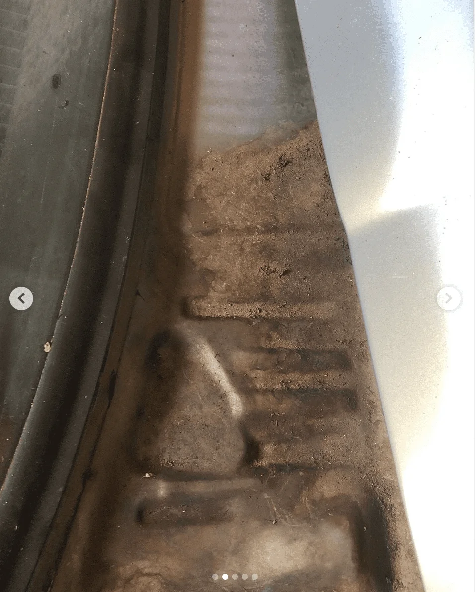

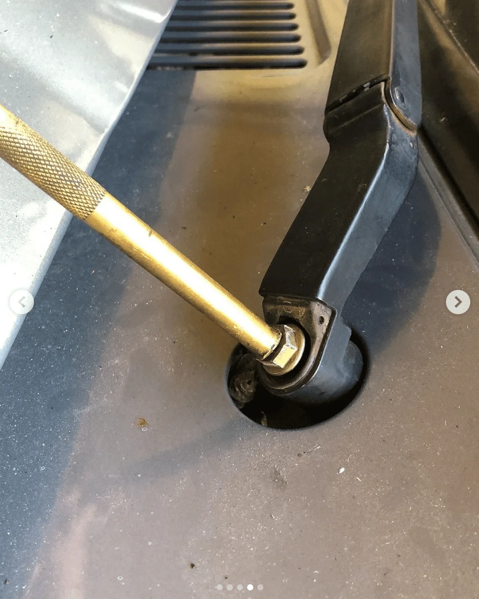

Cowl cleaning time. Before, during, and after.
Before you go looking to replace the cabin air filter, your looking at it. The 80 series do not have a traditional cabin air filter. Who knows how many years of debris are in there. Could be all 23 years.
First remove the wiper arms, in order to do this, loosen the 12mm nut, and take a brass punch and give it a couple smacks, this will loosen the taper fit. 2. Once arms removed, open hood and remove the screws on the edge inside the engine bay. 3. Lift and pull cowl towards engine direction. It’s wedged under the windshield pretty snug. 4. Clean away, you may notice the plastic mesh inserts will need replacing, as they are likely deformed and letting some debris into the cavity below. I would recommend a brush, degreaser, water, and then finish with some wax.
