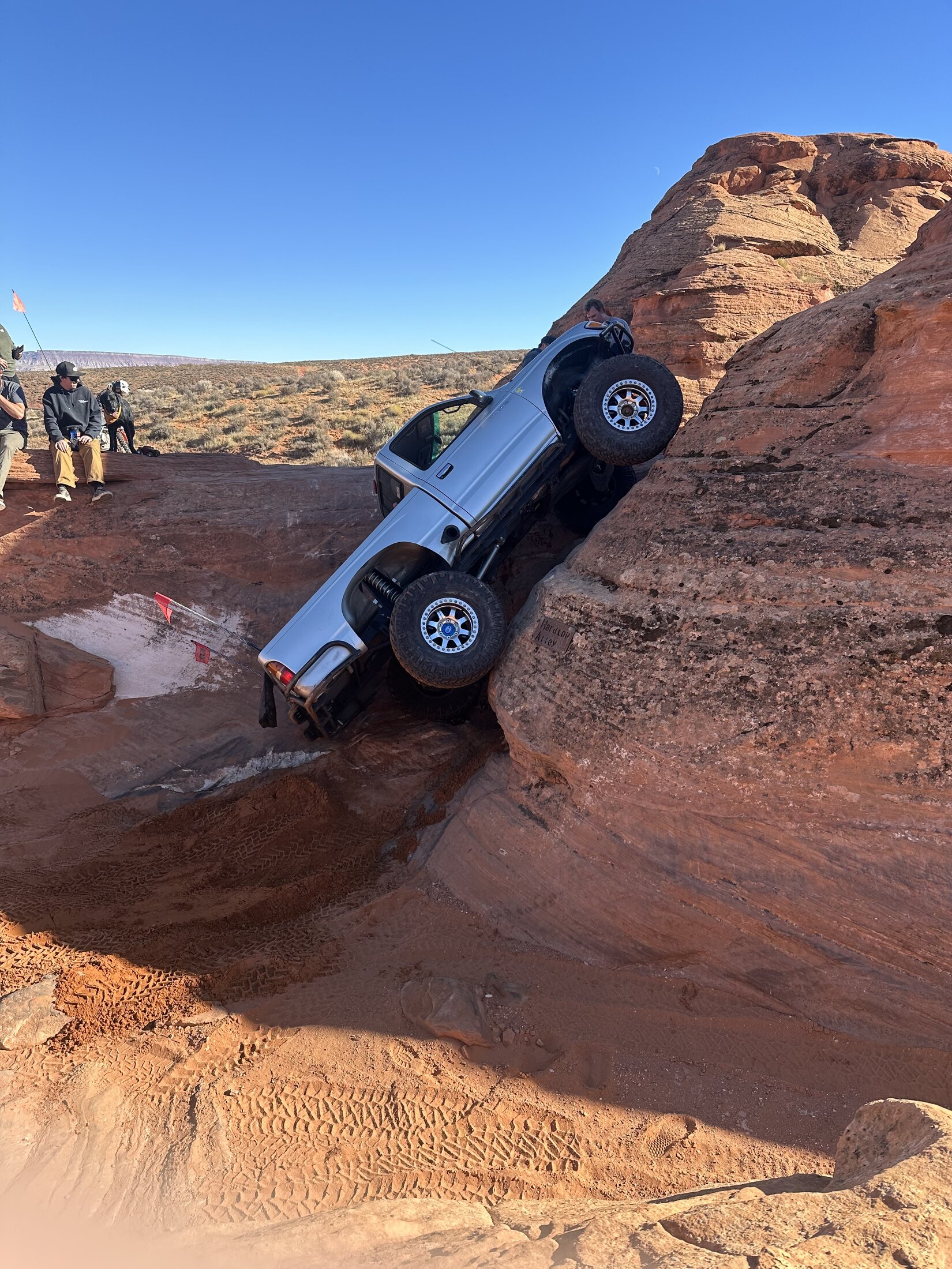

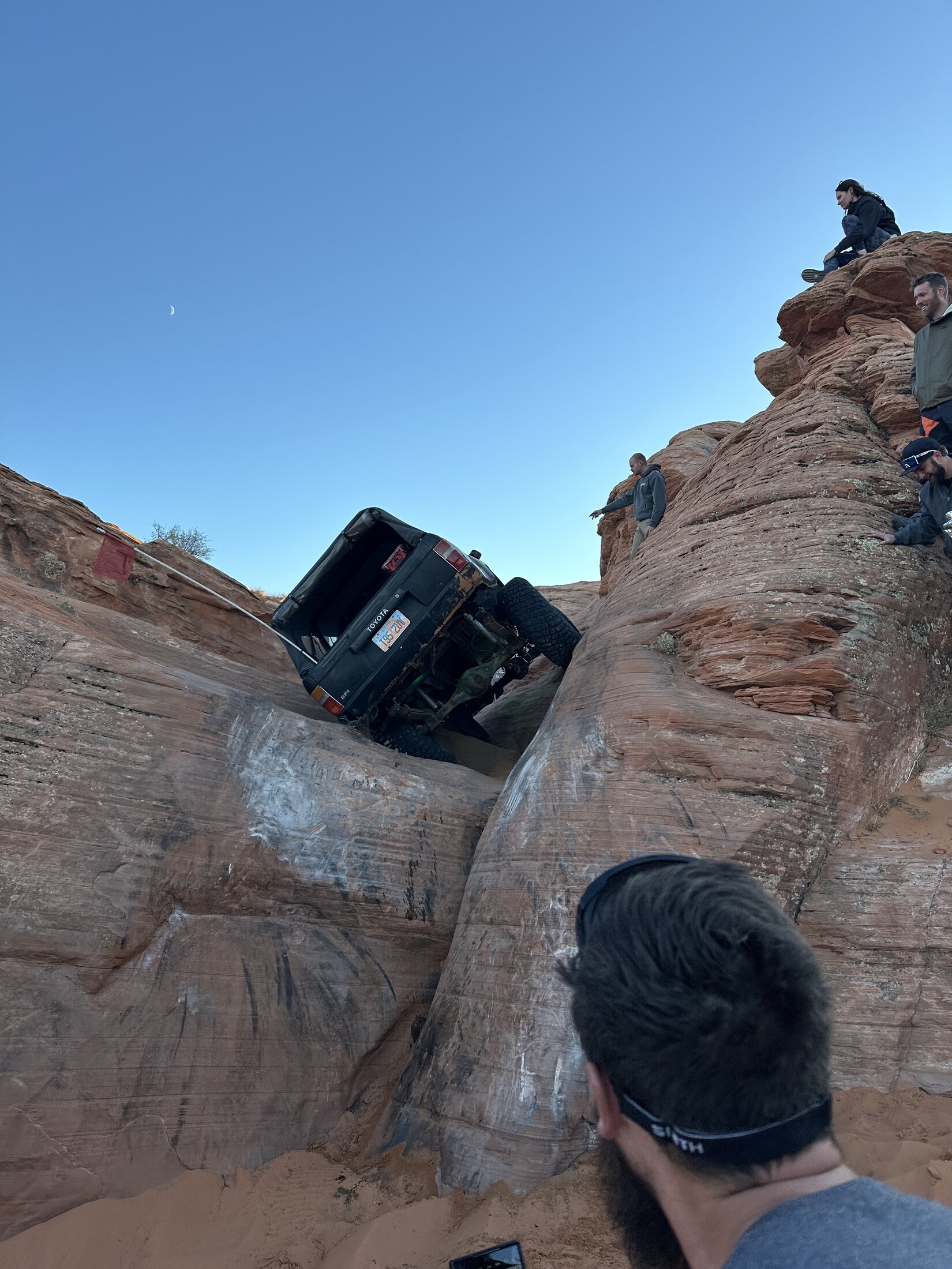

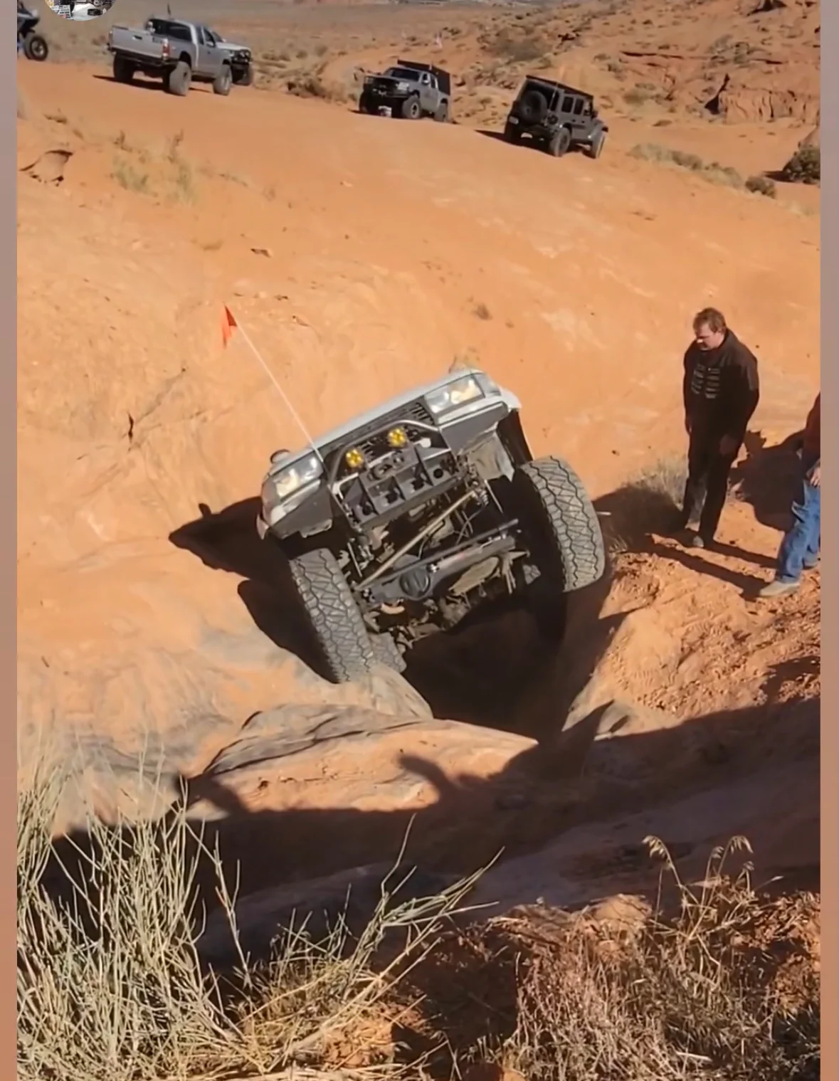

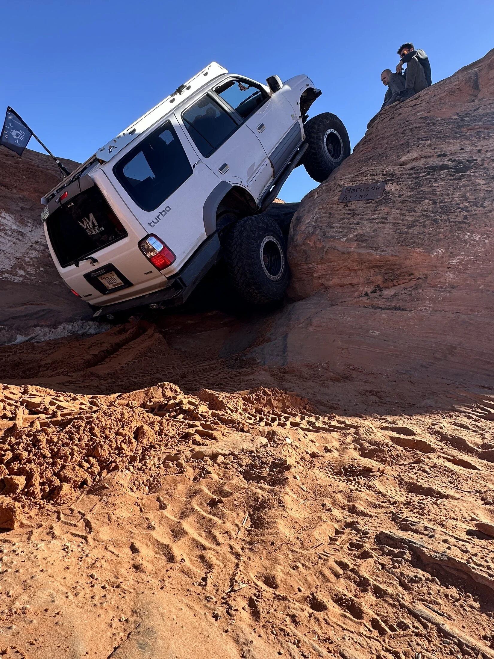

We survived another sand hallow trip! We hit John’s trail and moved into slip lock gulch. Got denied on a lot of the v notch climbs because the sliders are so dang ol wide. Full throttle bumping the car on middle monkey didn’t help….. but it did make it so every door but one doesn’t open. I’ll post up more pictures soon

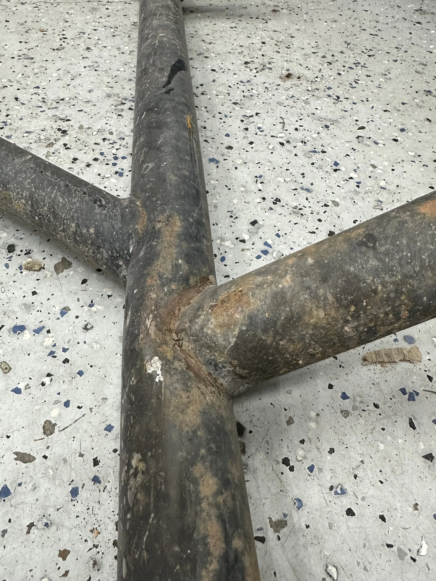

Before the next trip, pretty much all of the armor needs to get redone. The bumpers bent front the accident, the sliders are to wide and got me denied on most of the hard obstacles, and the rear bumpers to narrow and offers little to no protection for the rear quarters, oh and the welds on the T case skid broke and it’s flopping around

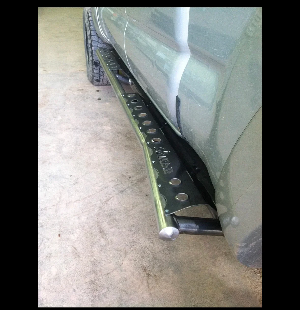

The current idea is something pretty similar style to what c4 has. It’ll have a 2x2 3/16” square tube main and legs with a 1 3/4” outers. It’s just be waaaaaaay narrower.

Would you actually terminate the rear end of the slider tube and cap it like the C4 design does? Looks like it poses great potential for jamming up against obstacles while reversing.
