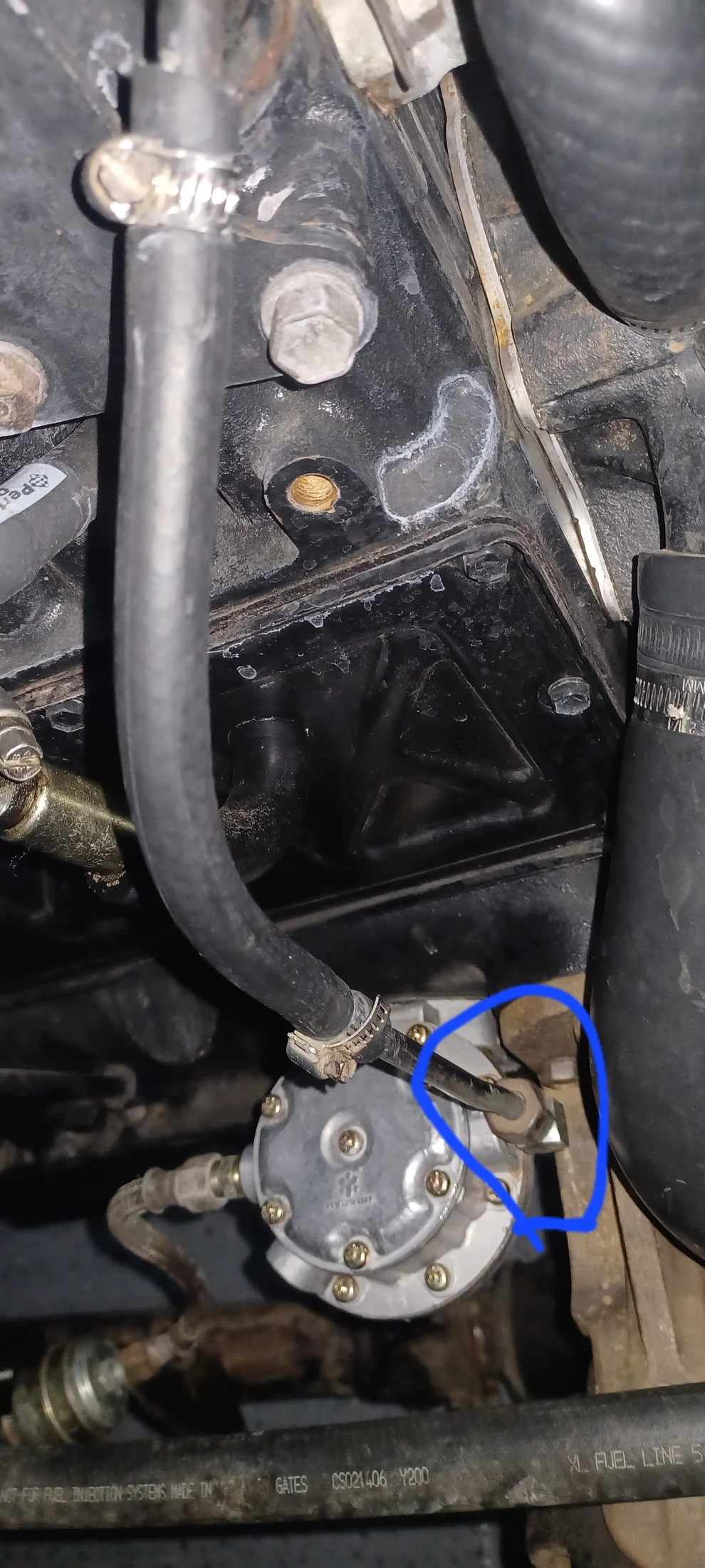

I am having a leak from the fuel line pictured. Coming out of the top of the nut. Does anyone have any idea where I can get a replacement fuel line. Looked all over the internet, but haven't had any luck. Any input would be appreciated.
I'd guess some PO replaced the metal fuel line with fuel hose. You can get a bard fitting or make/buy a metal tube to fix your bad one.
Have you inspected the inside of the nut/flare and the fitting - maybe its just loose or there is crud causing the leak.
Year/market/model helps point at the correct part faster.
I run one of those cheap like $10 electric diode fuel pump - they last me about 10 years (I carry a spare) Really expensive ones last 5. Fuel pump block off plate eliminated the oil leak. Not a purest.
There is supposed to be a ferrule compression fitting under that nut. What does your look like? You can try to loosen tighten, loosent ighten, to get it so seat if the proper ferrule is in there.
The compression fitting is under the nut, I will take a picture of it.
Get the british standard pipe tap barbed nipple that fits pump and carb - eliminate all the extra hose clamps and fittings. Buy a section of fuel hose to go from the carb to the pump. I buy rolls of USA fuel hose off ebay 5/16 x 25' for $32 delivered
Do I need to cut the old olive off the line and install new one? I think spector carries the fitting and nut
For now you could reuse the old .
