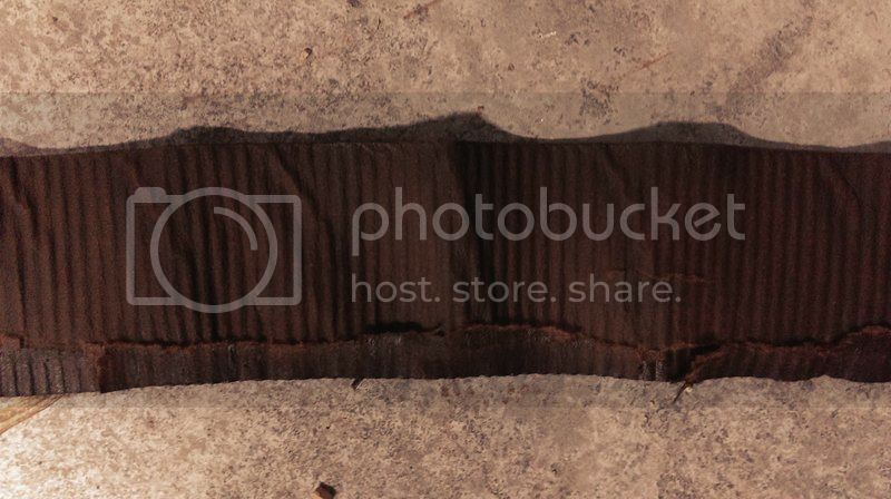

I changed my fuel filter today, Cruiser has 260k miles and it was bought with 245k miles this January. I believe this was the original fuel filter as I could not find evidence of replacement in the service records from the previous (original) owner. Truly the part that took the longest was moving the clip over from the old filter to the new.
I had to take the filter apart to see the filter media. As I was twisting the filter around trying to get it apart, the gasoline running out either end looked like mud. The entire length of the filter looked like this. I was in shock:

My filters (see post #25 page 2) also looked like yours and both had a muddy/sludge like liquid in them. So the filter is definitely doing its job....but surely needs replacing at some point.

I checked the receipts from previous owner, filter was replaced ~80K miles ago (I thought it was 30K miles ago). Thank you and good point. Your post worries me enough, I have the filter ordered and will replace this coming weekend :D I may cut it open if I have time and take pictures.
Photos of the filter media when wet makes it look more dramatic- I let mine dry and took photos of the outside and inside of the media. Notice that inside the folded sections is where the dirt gets trapped. Looks to be doing its job. No idea if the paper starts out white or off color, but it s dark. Probably original at 171,000 miles (2005 model)
