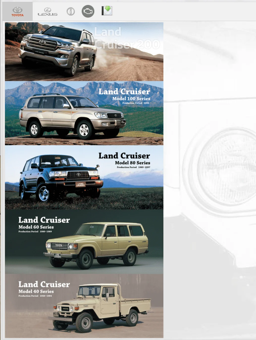

okay. Got the path but this is what I get when I goto 127.0.0.1
I suspect either the ISO isn't mounted, or it is but the path isn't set up in the web server. I don't have a Mac available to test this though.
If you log into the admin interface (http://127.0.0.1:9999) you should be able to view the web server logs and see if there are any errors. Failing that, go back to this post on page 3 and take screenshots of the same screens I did and post them here

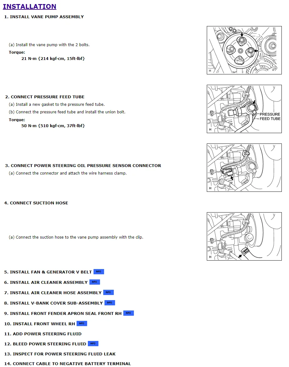

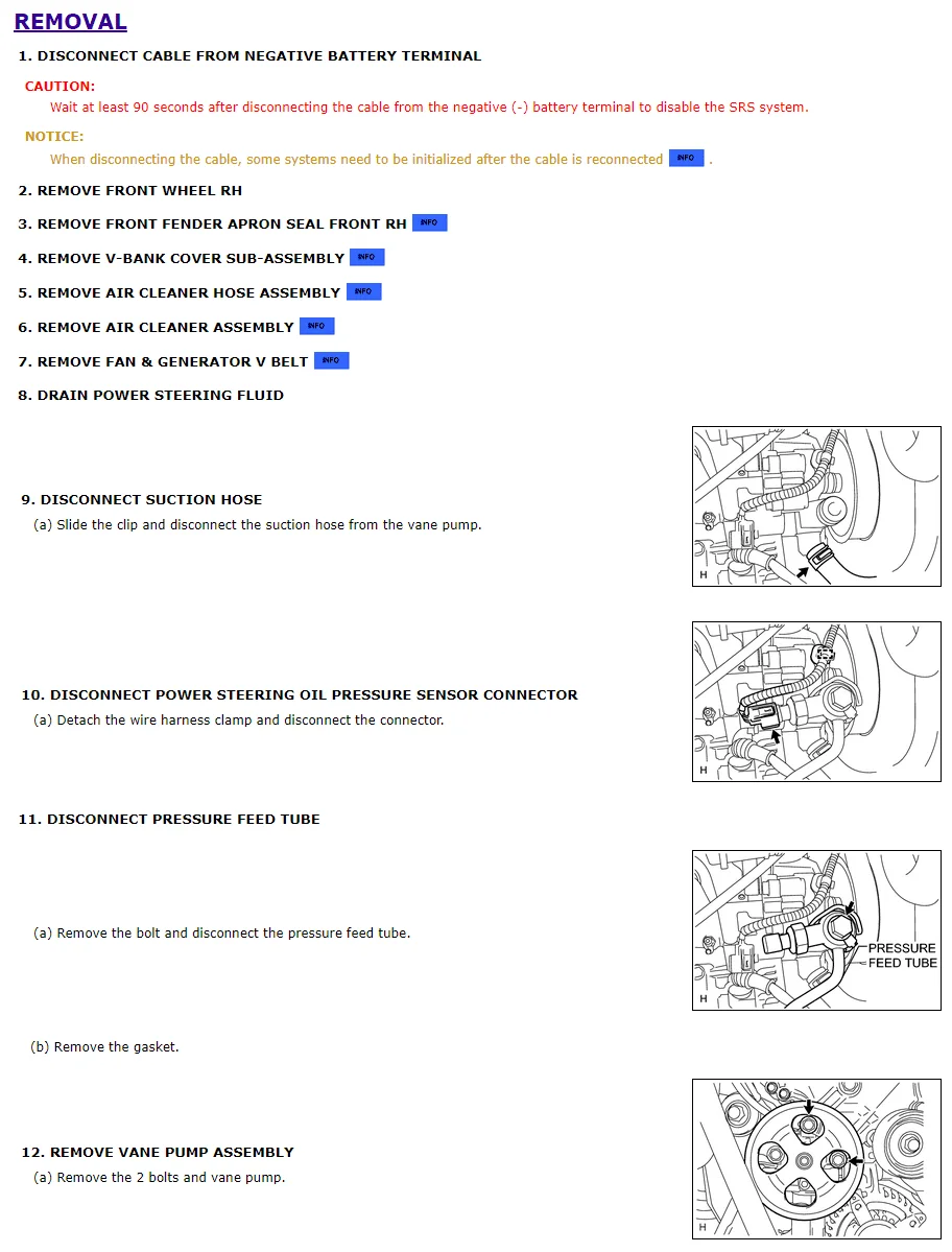

Is there someone who could upload a few FSM screenshots? Looking for directions on replacing the power steering pump on a 2008 LX. TIA
Yes, I PM'ed you. Let me know if you need the disassembly/reassembly instructions too or if just the remove/reinstall is sufficient

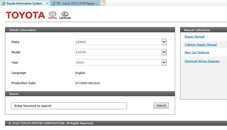

I purchased a 2010 LX570 Toyota factory service manual CD off eBay and ripped it to ISO.
How to use it: Download the ISO, Open the ISO, locate the mounted ISO (appears as a CD Drive) in My Computer and run autorun.exe

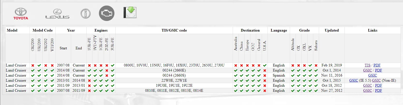

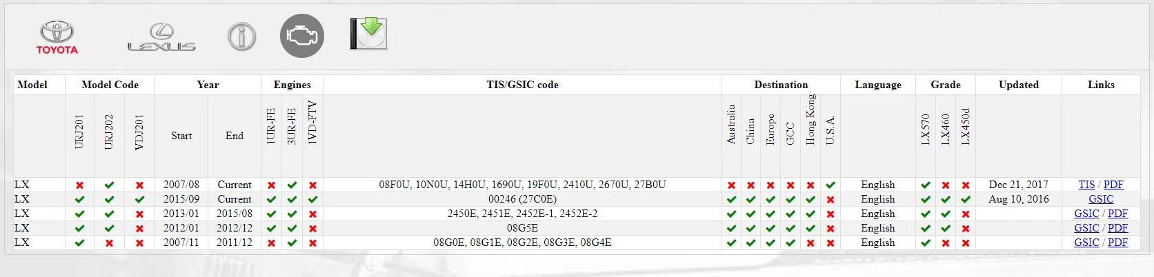

Does that have all the US docs? If it does that's great. A bunch of the early FSMs were the 2008 version (RM0800U) and didn't include the 3UR-FE
I've got a lot but not all of the docs...
