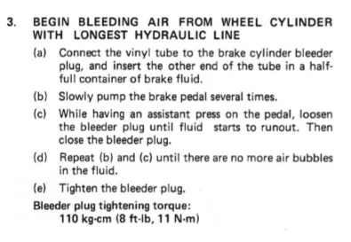

From the FSM in case you do not believe me.

The order i gave you is standard for just about every vehicle.
"BEGIN BLEEDING AIR FROM WHEEL CYLINDER WITH LONGEST HYDRAULIC LINE"
