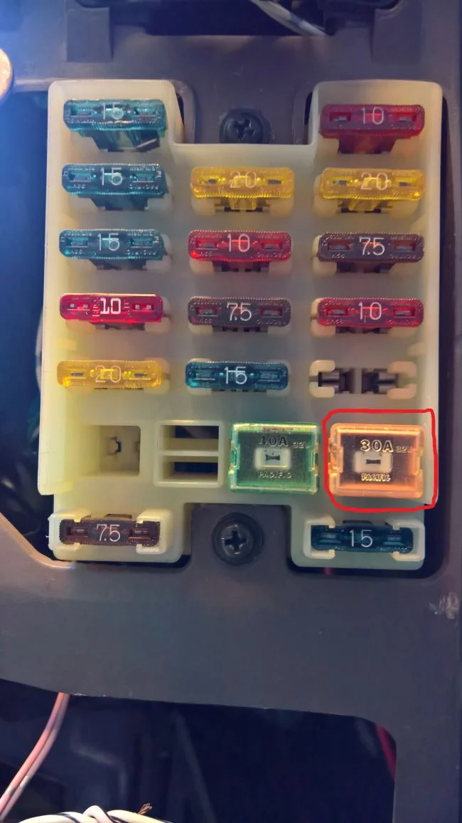

As a test you can lock the CDL (see below) to see if the vehicle drives better (no binding) with the front driveshaft removed.
Procedure to lock the CDL (in models that don't have the Diff Lock button or 7-pin Modification):
First turn the ignition key to ON (or start the vehicle).
Shift the transfer case to LO and leave it there
Turn the vehicle/engine OFF
Remove the large square yellow/orange 30A DIFF LOCK fuse from the dash fuse box, bottom right, and leave it out
Shift the Transfer case back to HI
Start the vehicle
Two indicator/warning lights should come on, ABS and DIFF LOCK, which mean the CDL is locked and ABS has been disabled.
Drive the vehicle to see if it makes a difference when driving/turning
