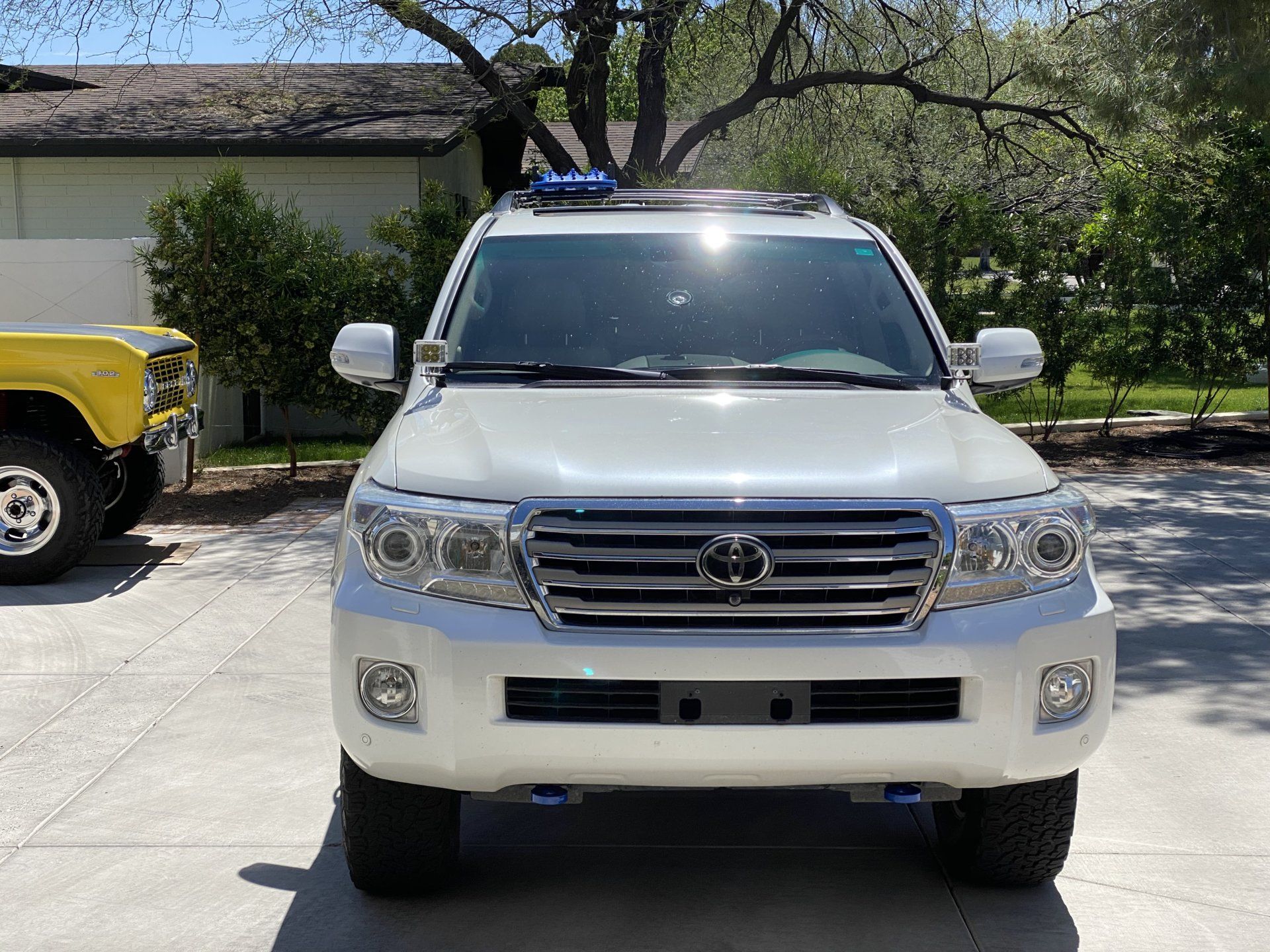

I know blue isn't everyone's color but I think it really brings out the color in my Maxtrax's eyes. Lol
