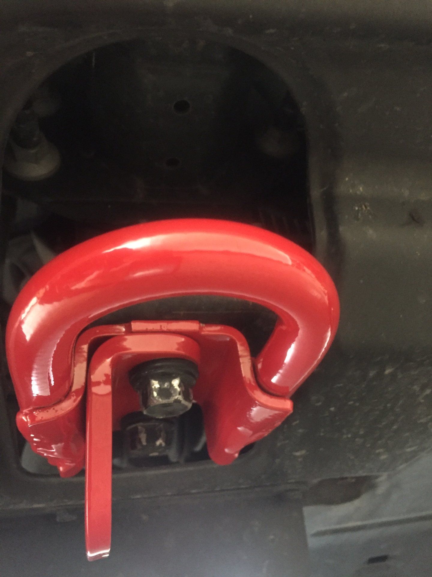

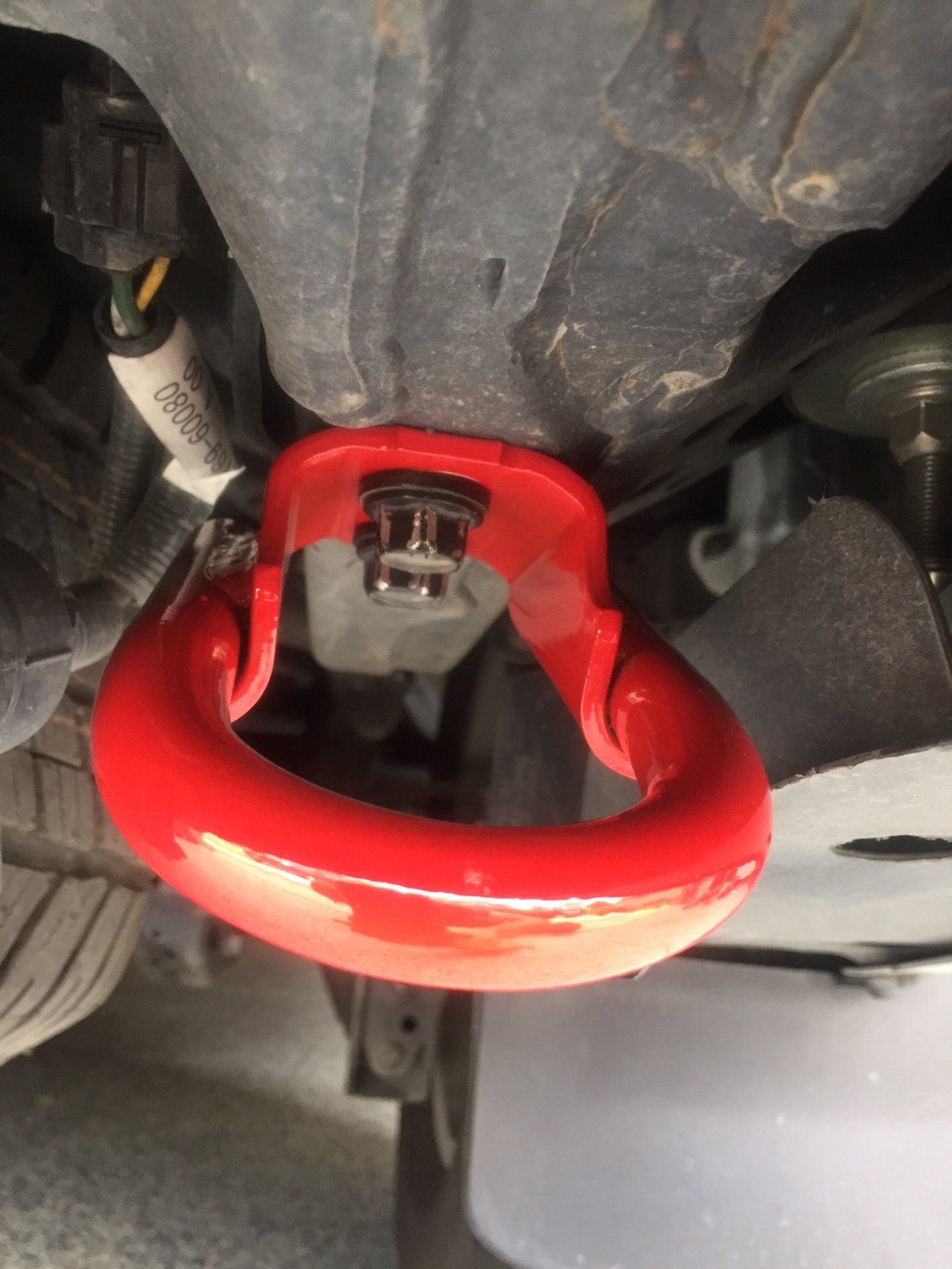

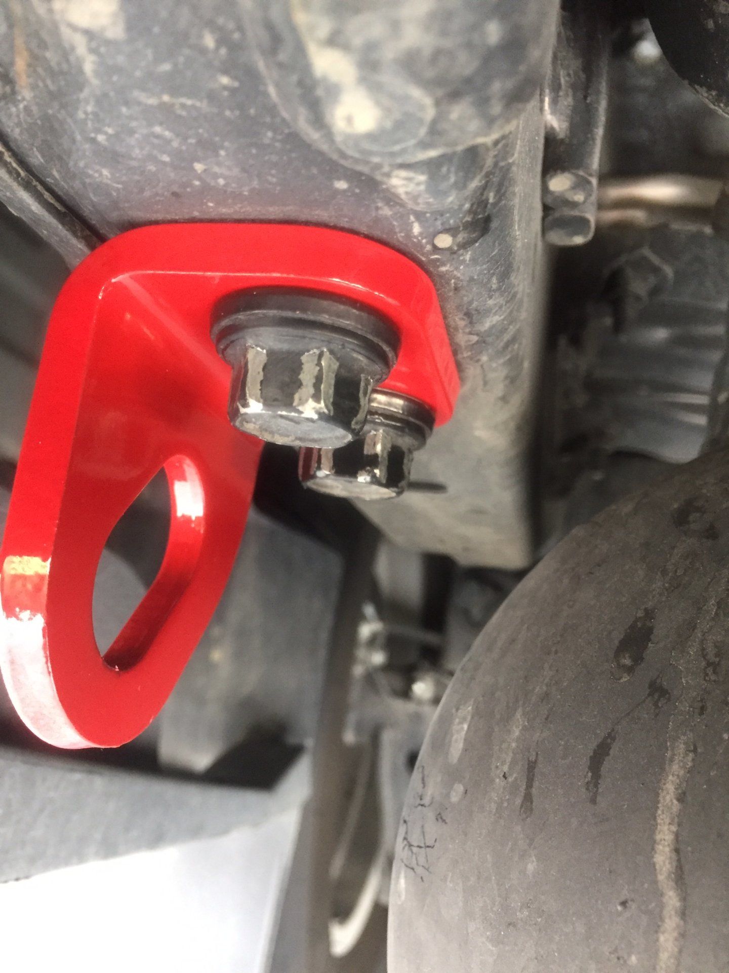

I had some tundra trd tow hooks handy in the shed, and my 200 hooks were begging to be replaced. The tundra bits are hell for stout.
I also have a pair of trail tailor tow points, but since they're bare metal the factory hoops won. Eventually I'll powder coat them and probably swap them out.
Here they are side by side. The tundra (allegedly trd) are a lot beefier.
Is the base plate where the bolts go through any thicker on the tundra parts? If not, between that and the cruiser hooks having the secondary hooks that provide a flatter clamping area, they may actually be weaker.
The difference is negligible. A quick measurement with my calipers shows 4.5 mm for the stock LC base plate versus the tundra at 5mm. They're so close that I couldn't swear by the difference.

Here are the Tundra tow hooks powdercoated red

Do you happen to have a part number for the tundra tow hooks?
Also, the holes for the bolts look smaller. Or is that just an illusion?

Holes are exactly the same size. Sorry, no part number - I bought them used from another forum member.
