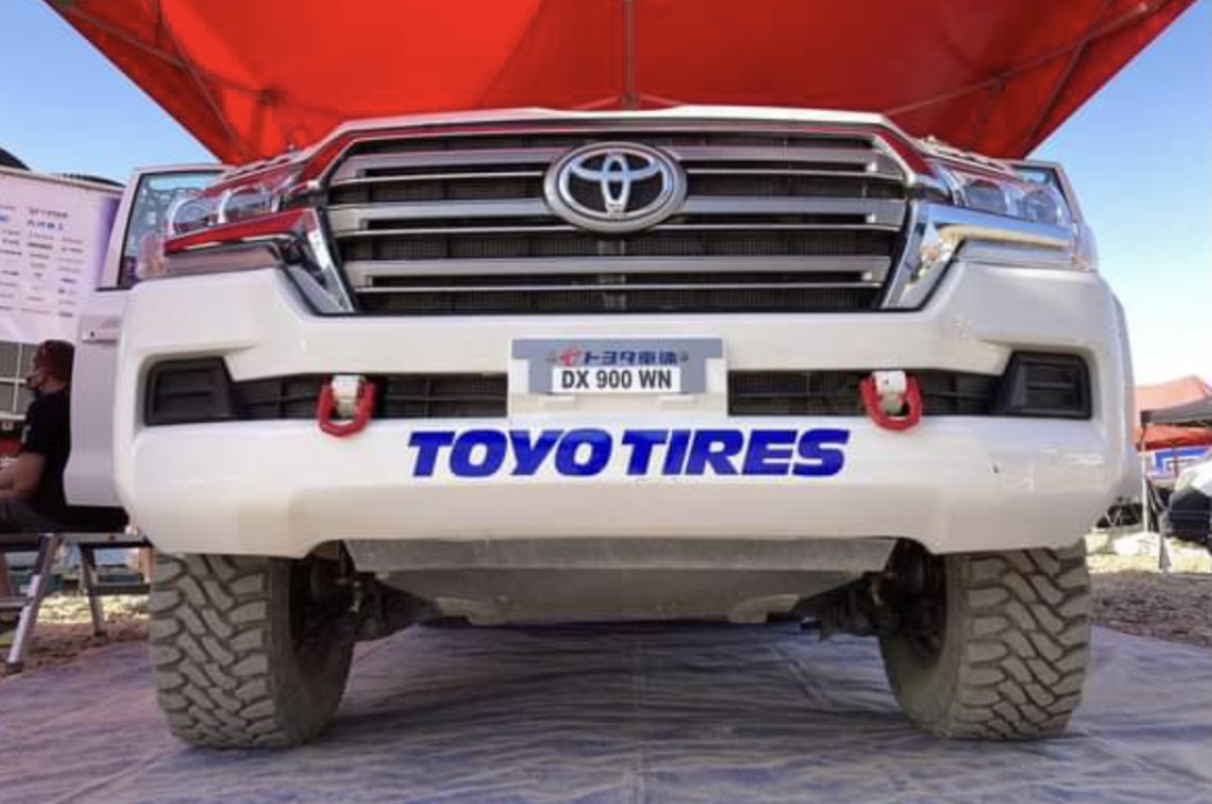

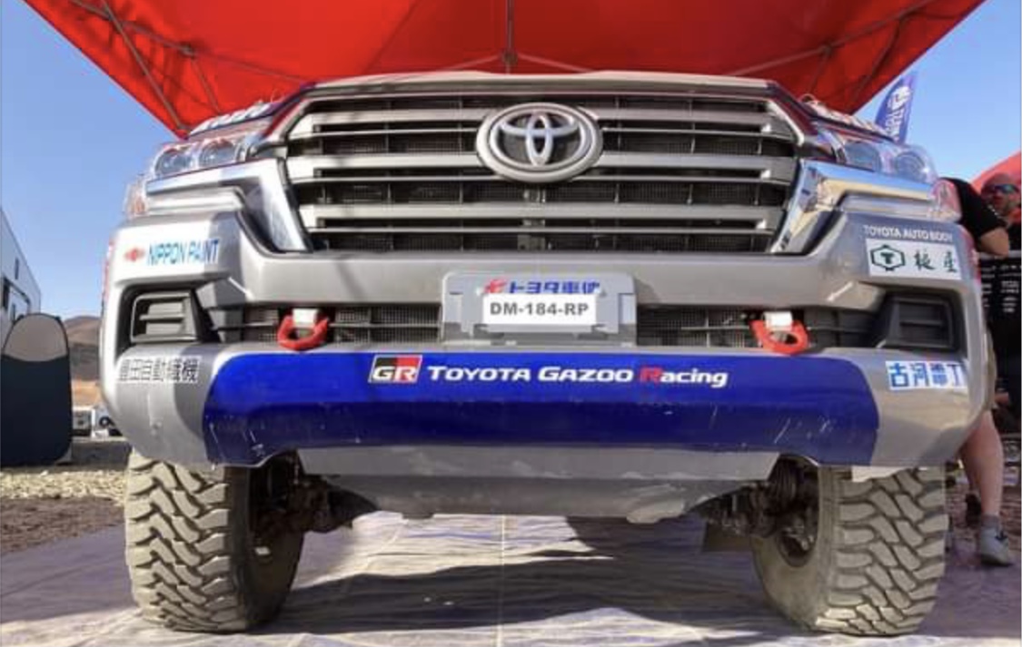

Toyota autobody (factory rally team) seems to have a slightly different approach.
View attachment 2808087Toyota autobody (factory rally team) seems to have a slightly different approach.
They likely don’t have the crash bar in there.. not sure if they are allowed to modify the frame but those hooks seem to line up pretty well with the horns that the crash bar and most bull bars mount from.
Off the top of my head I imagine the stock hooks may not work well when the front is buried in sand at the bottom of the steep side of a dune, for example.
I wonder what Monica is running? @cruiseroutfit ?
This reminds me of the thread where we were looking for close up pics of the Dakar trucks.
I guess my supposition is that the factory parts work perfectly for what they were designed for which (I can only guess) doesn't include offroad recovery. Fit for a purpose, but maybe(?) not designed for the one some of us use them for. Otherwise, why not just use them on the race trucks?
Like I said they are mounted quite low, and this just might not work for the range of recovery situations the Dakar trucks find themselves in.
Plus it’s possible there are regulations on things like recovery points.
Even if toyota wanted to put these hooks on the consumer vehicle they probably can’t due to crash structures and likely pedestrian safety regulations.

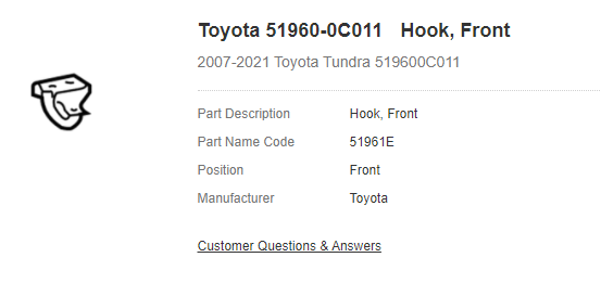

Do you happen to have a part number for the tundra tow hooks?
Also, the holes for the bolts look smaller. Or is that just an illusion?
thx!
Grumvee
Hey @Grumvee here's the part number for that tow hooks -
Toyota 51960-0C011 Hook, Front​
