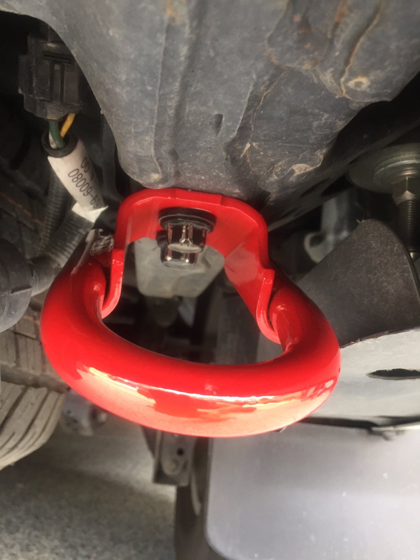

Agreed. I'm powder coating them blue to match the blue shock guards I bought from TT. They'll match my King suspension (and I like blue).
Mine are red and I'm doing all armor red and it is way more slippery when red. You should consider red. I almost never get stuck on speed bumps anymore.

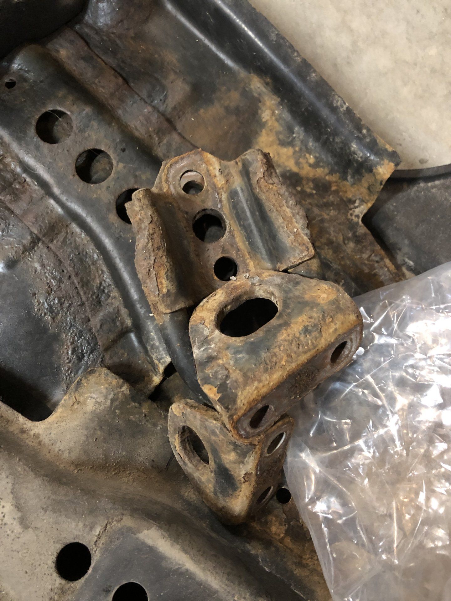

I almost can't believe I'm weighing in again to a three page discussion about the lowly tow hooks, but I'll pretend we're sitting around the campfire, having a drink, and this is worth discussing... my tow hooks were rusted to hell, the bolts badly corroded. After watching ebay for months for an affordable set of tundra hooks to replace them, I realized that the ARB recovery points were about the same money, and seemed pretty highly regarded. So I went for it. I don't like that they're red, I feel like I need a Jeep "trail rated" badge to go with them (I'm joking, of course!). Then again, I don't care enough to bother paining or powder coating them a different color. They just sit there, quietly waiting for a situation where they will come in handy. With any luck, I'll never need them, and they'll remain useless bling. Cheers! Anyone want a beer while I'm up?

Prior PS. The ARBs definitely need rounding. They definitely can cut soft shackles without it. I smoothed mine bc they did damage a soft shackle, and that is bad.
PPS. I would still use the factory points if I had them...so no axe to grind here at all.
That said...
Just a thought on ARB design...since it’s a little weird-
The ARB recovery point’s elongated holes (as opposed to pin-shape round) are specifically because it’s really the *pin* on a shackle that the rope is supposed to wrap (and stay perpendicular to)...not the curve of the shackle... aif the shackle pin is locked at one angle -the shackle is stressed on weird angle pulls in ways it’s not designed for. So the ARB slot-shaped hole allows the wider pin threads into the hole so the whole shackle can pass through to get the pin out and able to move around as needed.
The shackle’s max rated strength also assumes the pin is always perpendicular to the pull direction & that the curved parts are allowed to bear similar pull weights each side.
So... ARB’s slot hole design is maybe at least interesting in that one way.
And no...I am NOT saying you die if you do it backwards... :) but in a super nasty pull, it could matter to your shackle. ;)

That is some serious corrosion. I'll take an O'Doul's please
