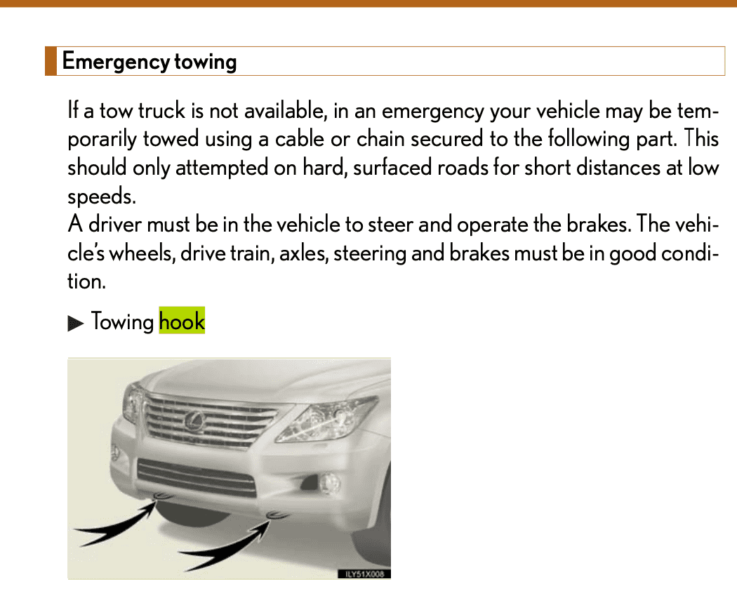

My owner's manual refers to them as towing hooks.

I guess a distinction could be made between “tow” and “recovery” hooks, if we look at the forces involved.
I don’t doubt that the aftermarket stuff is stronger, and personally like that ARB went to the effort of rating theirs. Thing is.. if we are using them properly.. stuff like a snatch strap instead of chain.. the forces should stay low enough to prevent failure.
