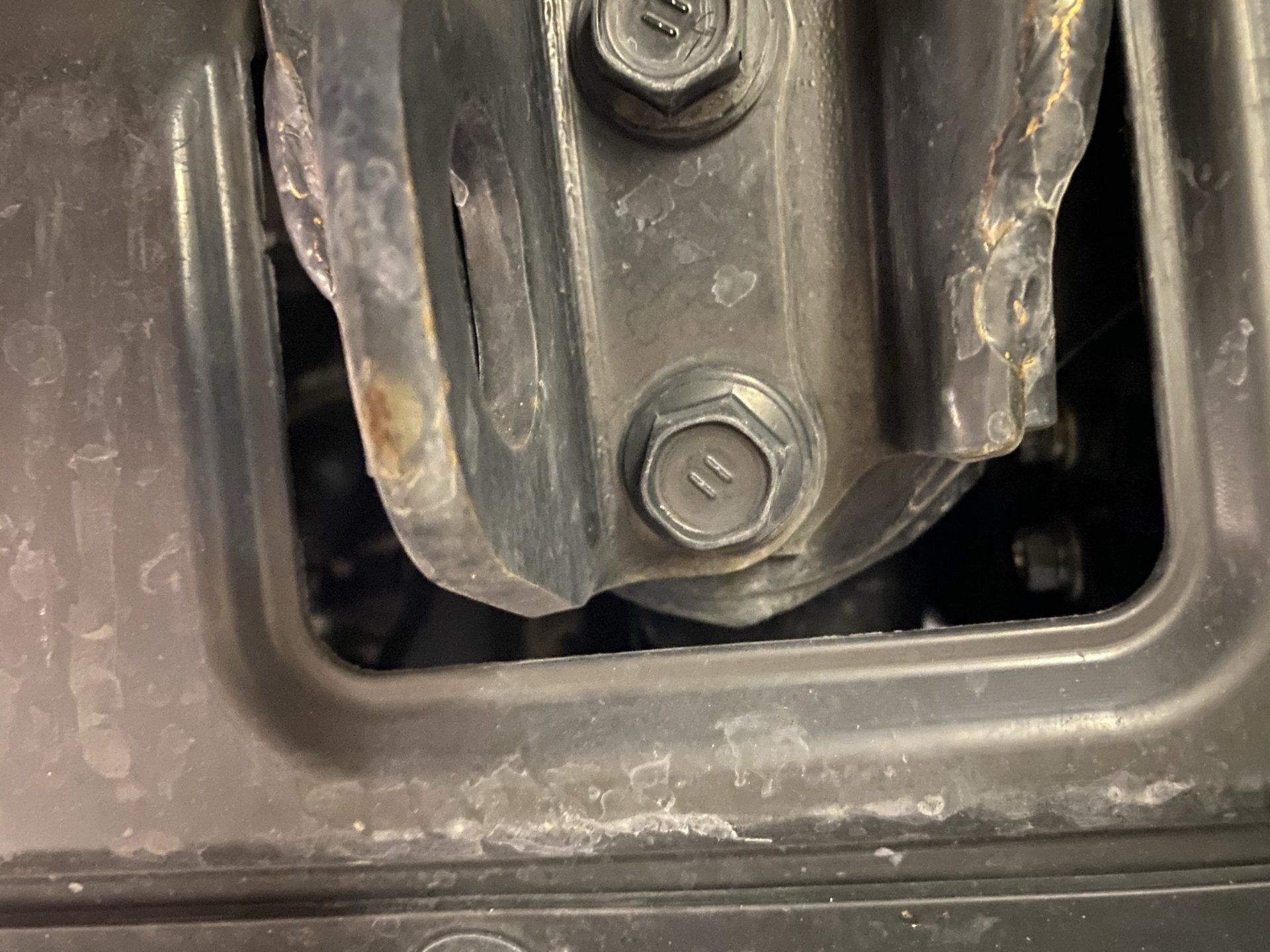

front tow hooks

So, what grade is the factory bolt?? For the life of me, I cannot find what “II” mean.

They rounded up from 10.9?

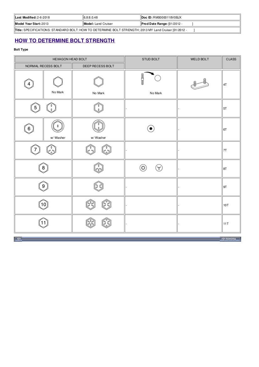

No, this is a marking system toyota has used for decades. I'm trying to find my PDF to decode it. Either way I'm pretty sure it's not a particularly high-grade bolt.
Edit: Appears to be class 11T. Aka strong.

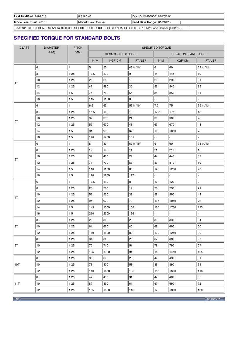

If someone wants to compare toyota's torque chart to the same thing for standard metric fasteners be my guest
For the nuts

Per the tightening torque values 6T is less than metric grade 8, which is less than SAE grade 5. No idea of material properties though.
why do you think it is 6T and not 11?
6T Mark is not same as the picture I posted.
