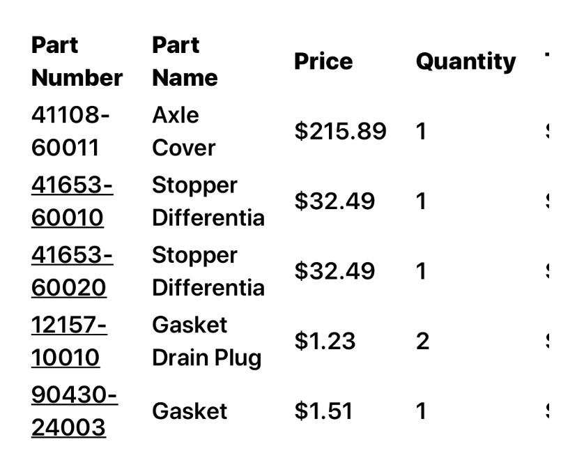

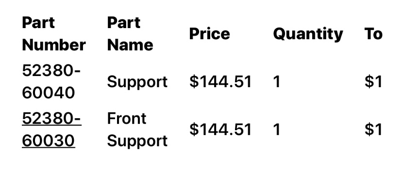

Doing #2 myself. Mcgeorge toyota had the best prices I found on oem replacement parts.
I didn't want to mess around with pressing in new bushings
Note that Partsouq prices for all of those items are about 40-45% less. I ordered most of those items a week ago and most certainly did not pay anything close to that! 😳
You win some, you lose some I suppose. Not sure where part souq is based, but I'd rather support a local US based business.

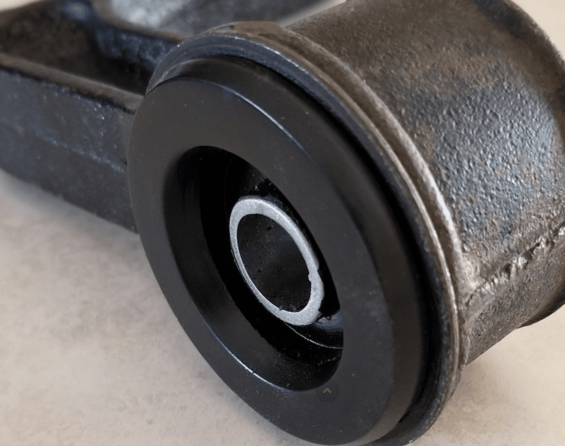

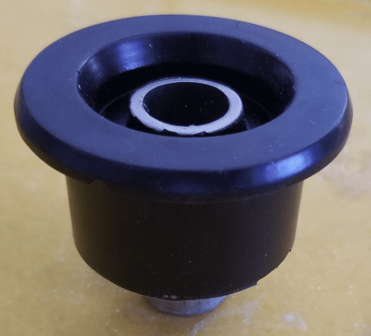

Have you guys seen anyone come up with poly inserts for the support arms? I see these on the Tacoma/4Runner side of the family.
SuperPro does: spf3881k | Front Lower Control Arm Bushing | Lexus LX470 98-07
In my opinion, however, Toyota OEM rubber is better and longer lasting than any other rubber or poly bushings.
I ordered everything OEM from various eBay sellers for $495. Same items with tax and shipping would have run $577. Over the course of year, I buy a LOT of parts from McGeorge.
