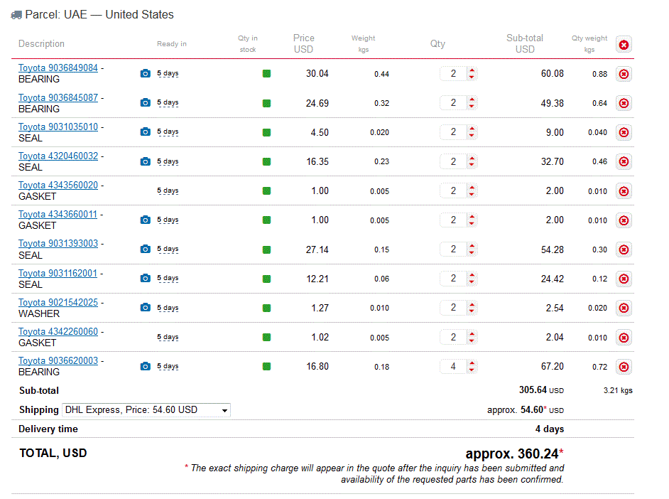

I've seen you post this in a few various places and I'd like to point out a couple of my thoughts.
A. OEM is NOT better than what we offer, it is often the same thing. Our kits come from OEM manufactures i.e. same part, different color box. Koyo, NOK and high quality Japanese such as Joint Fuji. We've examined every part against OE in depth, the same. Read more about that here: Product Spotlight: Cruiser Outfitters Knuckle Rebuild Kits
B. OEM is NOT cheaper. I just added up the parts from your list to match our FA9097KWB ($205, ~$220 shipped anywhere in the US) and Amayama is ~$360 shipped. Perhaps you are buying in super huge volume from them but to get a 40% discount? Fwiw Amayama no longer has the Koyo 30304AJ bearing unless you buy OE, they have NSK & Nachi, both are good bearing suppliers and used OE by Toyota for different applications but not knuckle bearings. Unknown if they have the correct taper as some interchange bearings do not.
What am I missing?

Thanks for the reply and I agree its absolutely great to have choices and be up front about what kits cost, etc. It seems that Amayama has been upping their prices and no longer carrying some items? Not only do the no longer list the correct Koyo 30304AJ (and haven't for a bit as I tried to price it that way when you posted in the other thread a few months back), they don't offer the wheel bearings outside of OEM Toyota boxes either?
So in order to replicate our kit (you ordered a few other items), this is what I'm coming up with:
It's important to note that some DHL shipments from Amayama particularly out of UAE also get hit with duties/brokerage on top of the 14-21 day prep/transit period. That said if you've got some other parts coming from them it may be a non-issue and we use them for misc. stuff too, great guys to work with.

Now we are in total agreement with your list above : if you subtract the bearings you end up paying 129.06 USD
Indeed amayama prices varies...so it seems you took the most expensive variant...for example for the 90313-93003 I paid 14.27; in your order above you chose the most expensive at 27.14 instead of selecting the 15.88 from Japan, for the 90311-62001 you could have chosen 7.53 from Japan instead of 12.21 .....and so on.....Also, for the bearings (all Koyo) I paid 5.5 for the 30304AJ, 11.64 for the JLM104948-N/JLM104910-N and 8.60 for the LM102949/LM102910 all from amayama at the time....(indeed they don't offer alternates Koyos for some reason at the moment )....
