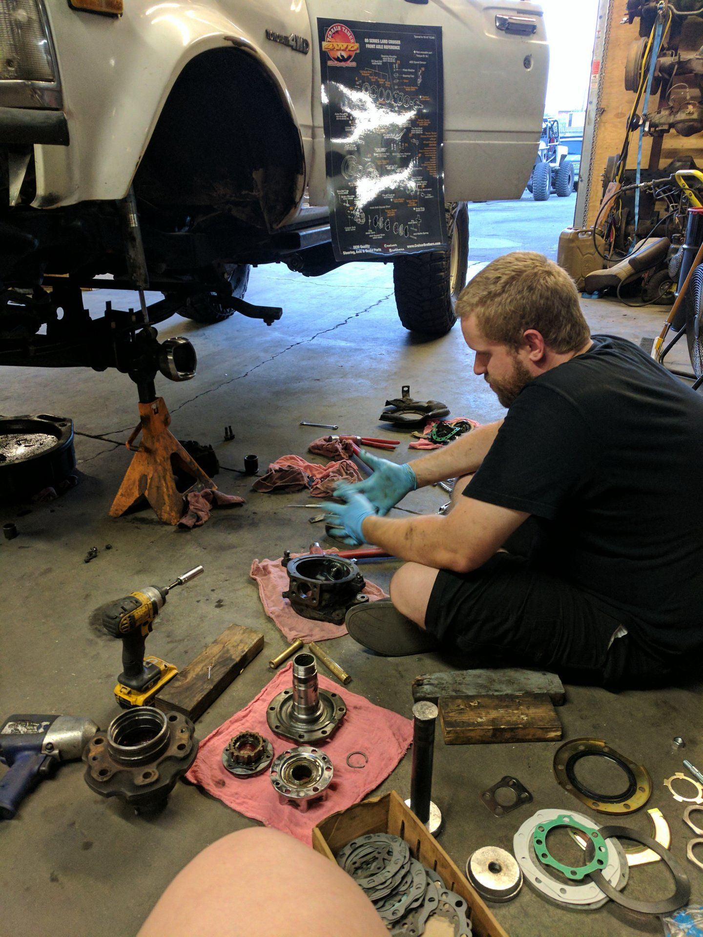

Welp, I finished up my rebuild today with the uhmw wipers. I will report back with my results.
As far as lubricating the balls, the wipers do not wipe 100% of the grease off. The surface isn't completely polished, therefore the imperfections leave some grease behind and not all of the gunk like the felt did.
The only bad thing is that I don't think you will be able to tell when your axle seal is leaking. But I guess only time will tell.

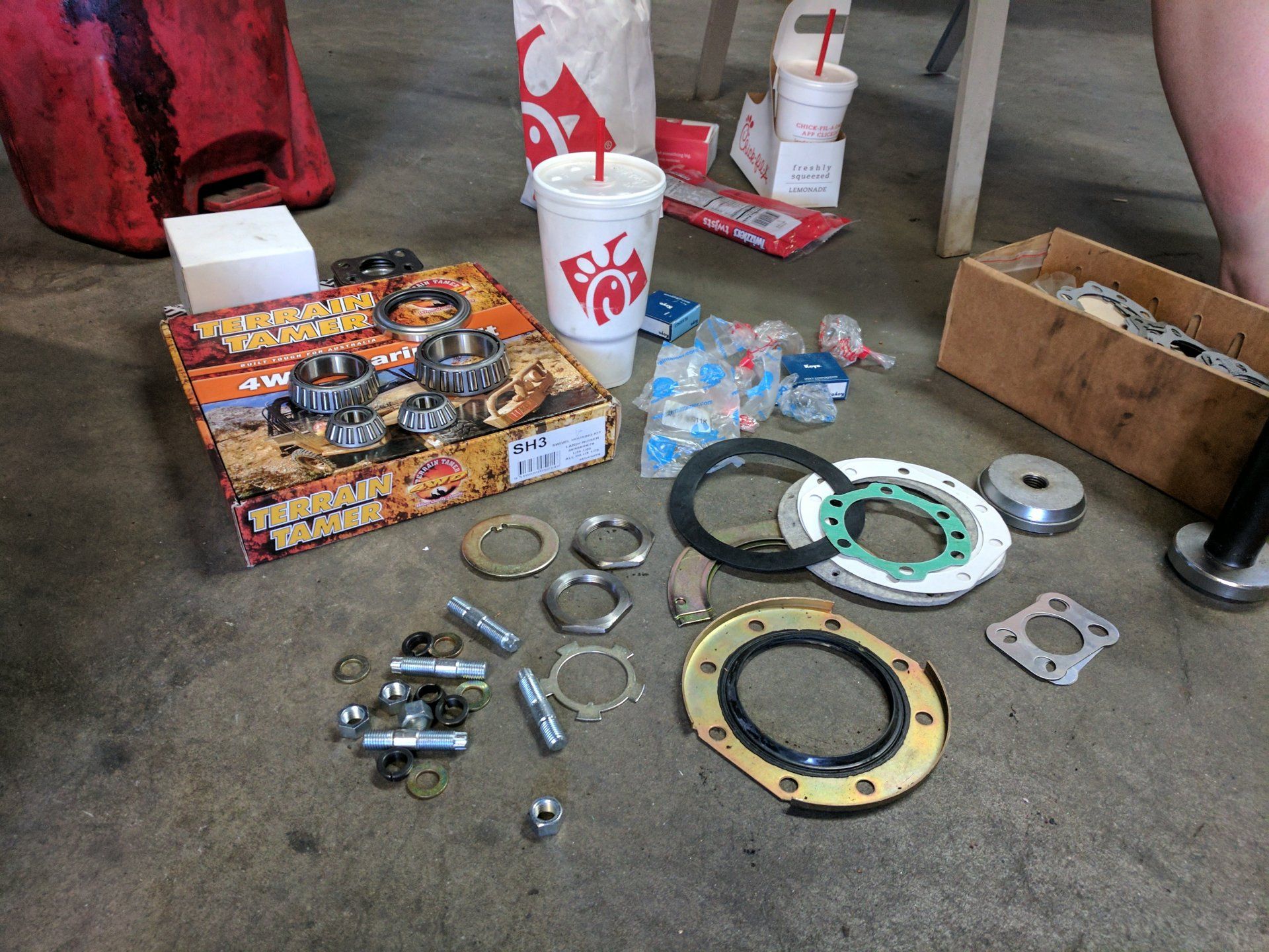

If this is your first time rebuilding the front axle budget a lot more time than expected. It is not a tough job, just messy and time consuming. Make sure you have a good supply of nitrile gloves, paper towels and brake cleaner on hand.

Does anyone know what type the Terrain Tamer kit includes? Felt or rubber?

Also, thanks for helping us bring our 80 Series axle poster to the community.
Joey designed a version of his axle poster for us - a great resource when doing a knuckle rebuild, CV replacement or other service procedure or repair. The poster is a blow-up of the knuckle with all parts, torque specs and locations. 18" x 27" the poster is attractive, laminated and ready for years of service in your shop. Also suitable for framing as a loverly Land Cruiser home decor addition. Available through Terrain Tamer shops and resellers and online at the Cruiser Brothers web store for $25 plus shipping at www.CruiserBrothers.com and here.

Cruiser Outfitters is a great shop, Kurt is a great guy to do business with, and I highly recommend supporting great vendors like them. I am a notorious penny pincher, and the Interwebs allow weasels like me to squeak every penny of value out of our purchases. Having said that, I bought my front axle rebuild kit from Kurt and Cruiser Outfitters because they enjoy an Excellent Reputation for customer service, and they provide excellent, well-vetted products at very competitive prices. While their prices may not be the absolute cheapest solution (and in fact, they might be, if we're comparing apples to apples), their quick shipping, expertise and responsiveness are good as gold.
When I got my front axle kit one of the paper seals was folded in half. It might have worked, but I shot them an email and I got an immediate reply with an apology and a replacement seal within a couple days, free of charge. (Try that with Amayama and LMK how it goes.) That is how one builds and maintains a business for years. They have earned my support and respect, along with that of many others in the Toyota off roading community.

I spent like three half-days doing one side. I was ridiculously careful and it was the craziest mechanical job I've ever done. I'm sickishly looking forward to the other side now. Planning on two days, but also planning on surprises because s*** happens.
