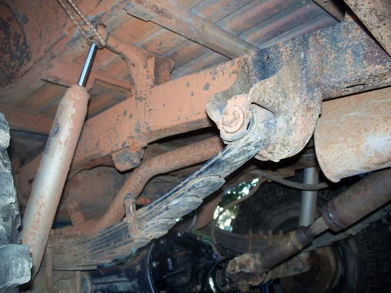

Nay is right on the money. My trail rig is a 72' Bronco, coil front leaf rear. All is good on these rigs until people 4 link the rear then the flopping party begins, happens all the time. The rear leaves keep the front stable. once the rear is linked and the flexing starts the rear follows the front and it rolls over like a dog...:)

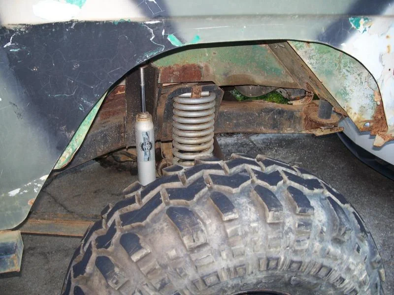

I wheel sometimes with a guy in my neighborhood who has a full size Bronco, rear leaf and front coil, with Duff radius arms I believe and coils like the FOR Gen II (progressive with the stacked dead winds).
That thing out-flexes my 80 big time and is very stable from what I have seen - he just needs a front locker and some 37's or bigger.
Just like this (not bad for 8" of lift - that's what you get with a good rear leaf system):
to sound like a broken record, it's all about balance and control - you can have very little travel, very little articulation, and still have a sloppy floppy rig. Or alot of travel, alot of articulation, and a solid balanced rig.
