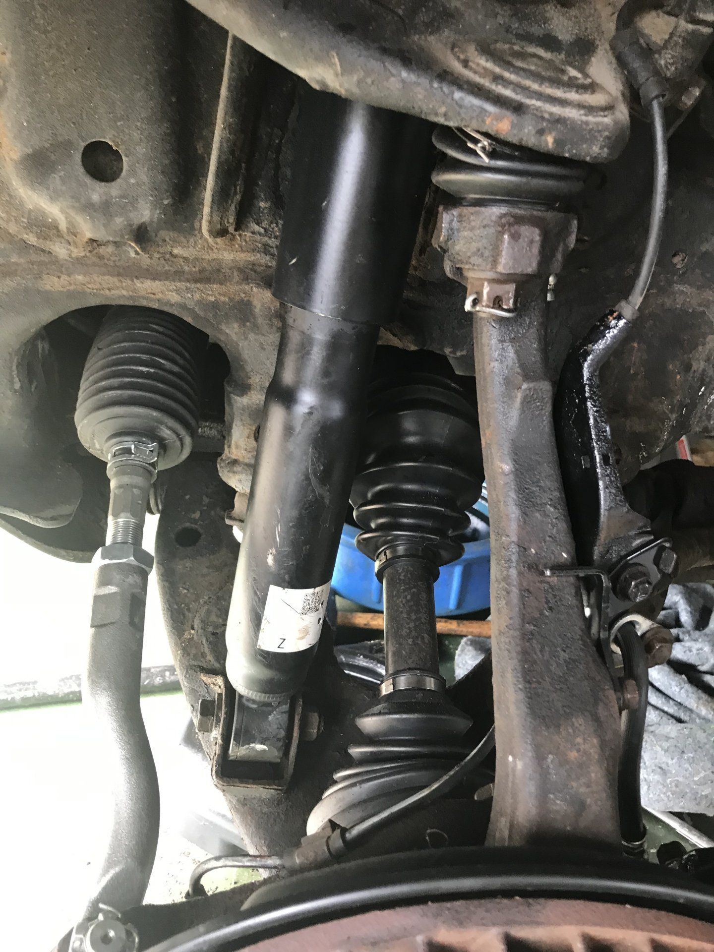

I refilled the diff and took it for a ride. everything seems like it was before. There is actually some back and forth play in the passenger CV as well (more than the driver side I swapped) so maybe it's down to aftermarket CVs.
No leaks yet, we'll see what happens
The aftermarket CV - is it moving in and out or is it torsional?
in and out slightly. if I grab the axle I can pull it out further by about 2mm with the clip in.
passenger side, that I haven't touched is the same. actually less movement on the driver side with the new C clip with the tire on. I can barely shift that one at all now
You'll want to address that. The "sawing" action back and forth on the splines is going to cause premature wear. If you NEED to, put another c-clip on there. I'd recommend replacing the axle. Check out your local forum and see if you can find a factory CV that you can get a rebuild kit for - or pick up a CVJ axle.

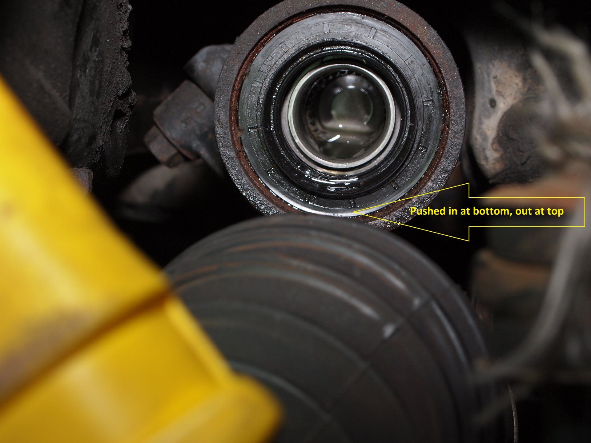

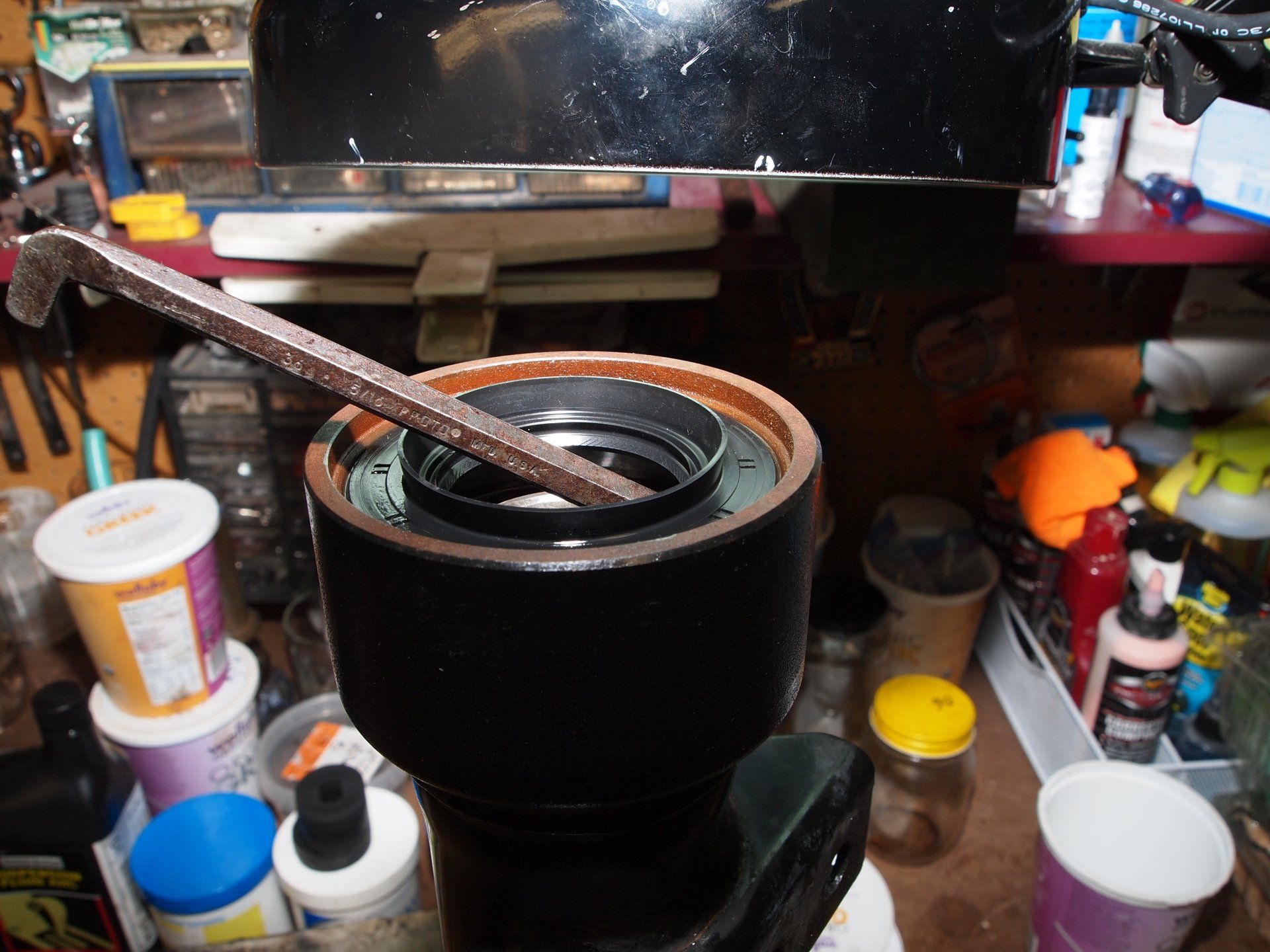

Often times while installing the front drive shaft (FDS) the seal gets knock in on one side or the other. It will than leak. If seal cavity of diff, not lube during replacement or seal not greased before FDS install, they may leaks.

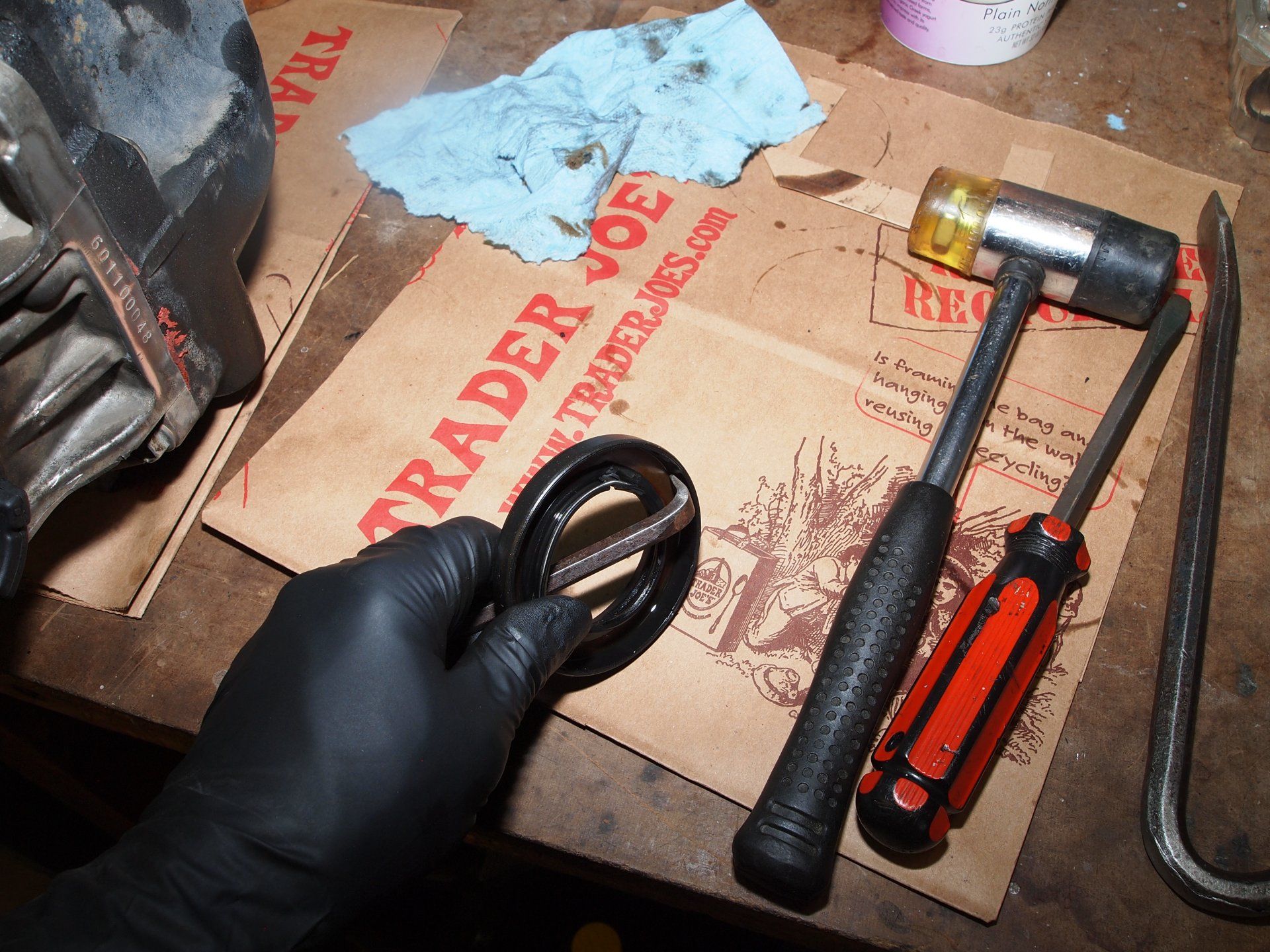

If you must re-due the seal. You can do short cut way.
You can level or pull the seal to get square. Here I'm levering off the inner shaft of diff pushing on steel plate on back side of DS seal.

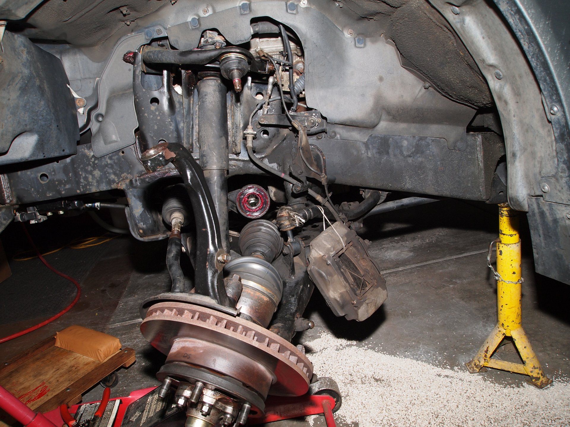

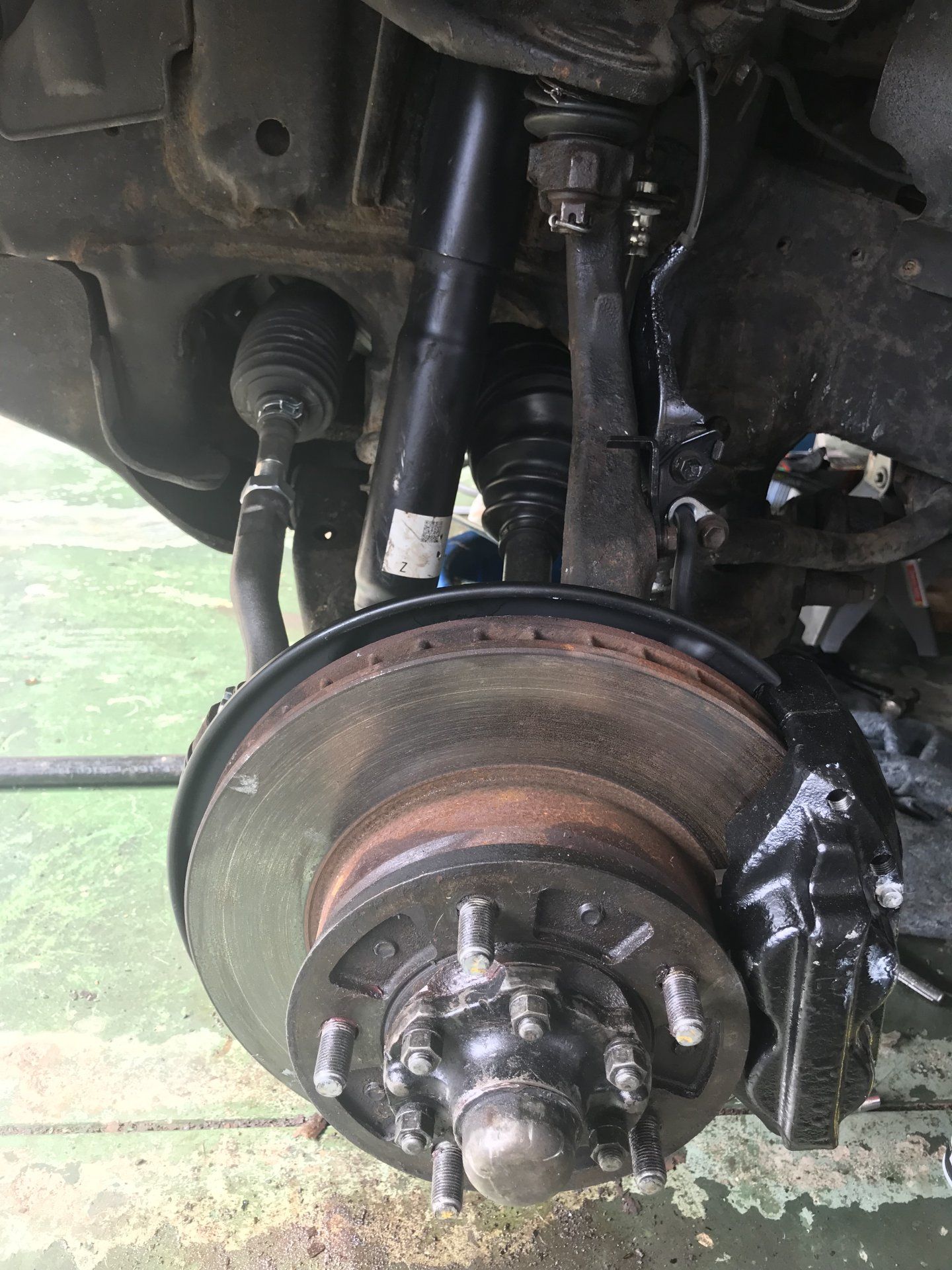

Geeze, maybe all is not lost. Thought for sure I had popped the cv in all the way... guess not.
So, any clever tricks to pop her in without unnecessary disassembly if things. If I just drop upper ball joint maybe I can pivot it in all the way?
I was able to pop it in with the upper ball joint loose. I'm really surprised it didnt click in when you lifted the knuckle and reattached it.
You may have to undo the c clip to get it to click in, then lift the knuckle back up, attach that and then reinstall the C clip

Often times while installing the front drive shaft (FDS) the seal gets knock in on one side or the other. It will than leak. It seal cavity not lube during replacement or seal greased before FDS install, leaks are common.
