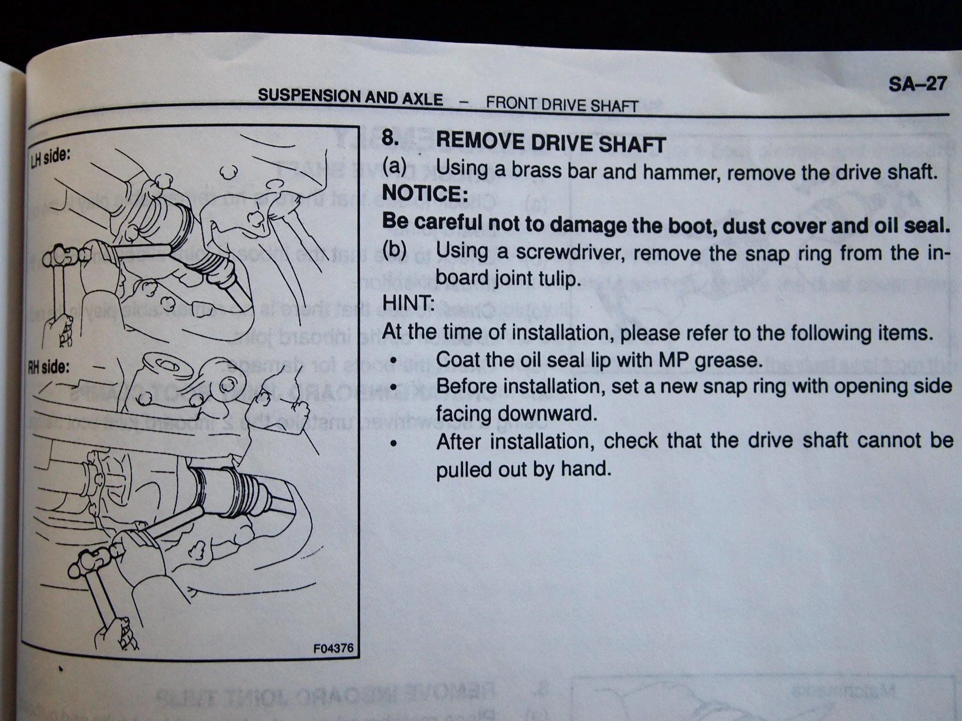

I've use a brass drift. Same as FMS shows to pound out, but pound in instead. Just make sure press in as far as you can first getting splines aligned and meshed and shaft in line.
I hope you used a new inner snap ring during install as required by proper procedure.

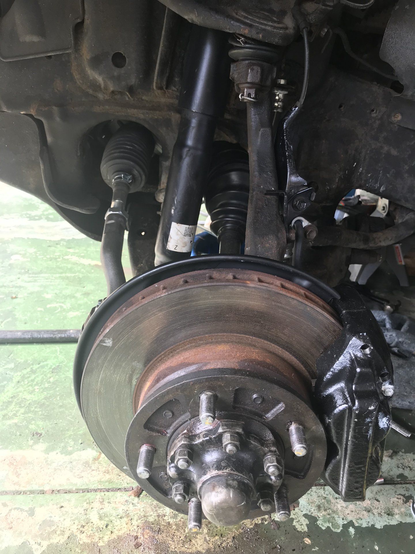

So I raised lower control arm with a bottle jack to position cv parallel to the floor, then used long pry bar and brass drift to tap it in. Much success! Just need to top off diff fluid now to verify much success. As always, thanks everyone.

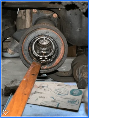

I'd not use any RTV, FIPG or such glue. Procedure is to lube the outer lip of seal/or area seal fits in diff, with gear lube, then tap in seal. I use a piece of 3/4" X 1/2" X 3' oak stick. This allows me to tap gently around the seal until oak hits the solid surface of the diff, while comfortable sitting 3 feet away. I then eyeball and feel seal with finger, to make sure seal is flush/square with diff.

Wood handle of mallet is to large. The 1/2"X3/4" long piece of oak fit between seals lip that protrudes from seal and the outer part of diff. This way you'll not damage lip of seal. Also as oak hits inner recess of diff, it seat seal flush.
Here's one I'll be replacing later today. See how my oak stick fit between lip of seal and into recess of diff. I've no idea what the reddish around seal is. Possible transfer case FIPG or may be a red grease. But the FSM is clear use gear lube, works!

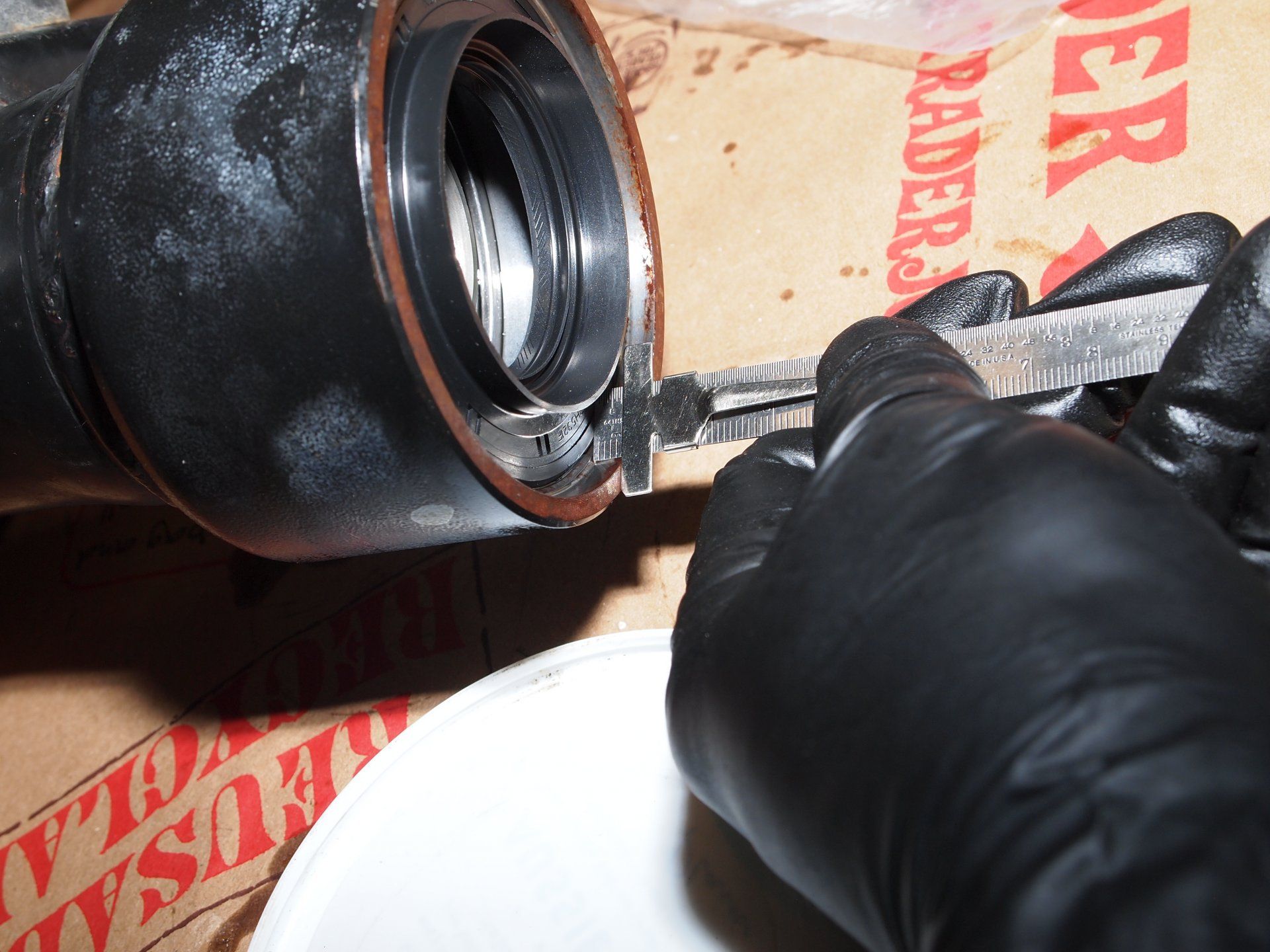

Check the CV shaft - there are 2 parts of the sealing system. If the differential casing is gouged where the seal sits, that is a third item to check (outside of seal).
A new seal set to the correct depth will not fix this:

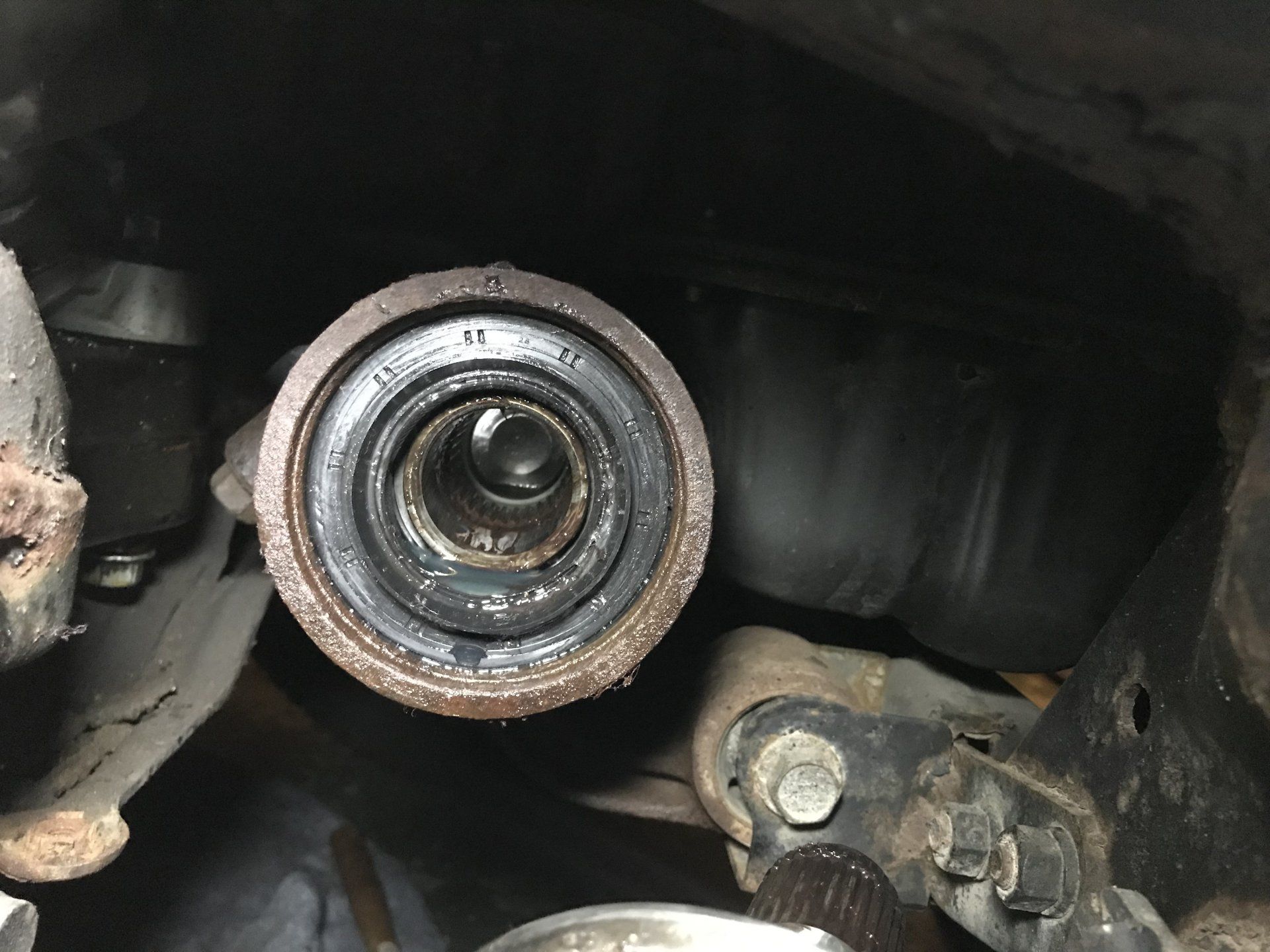

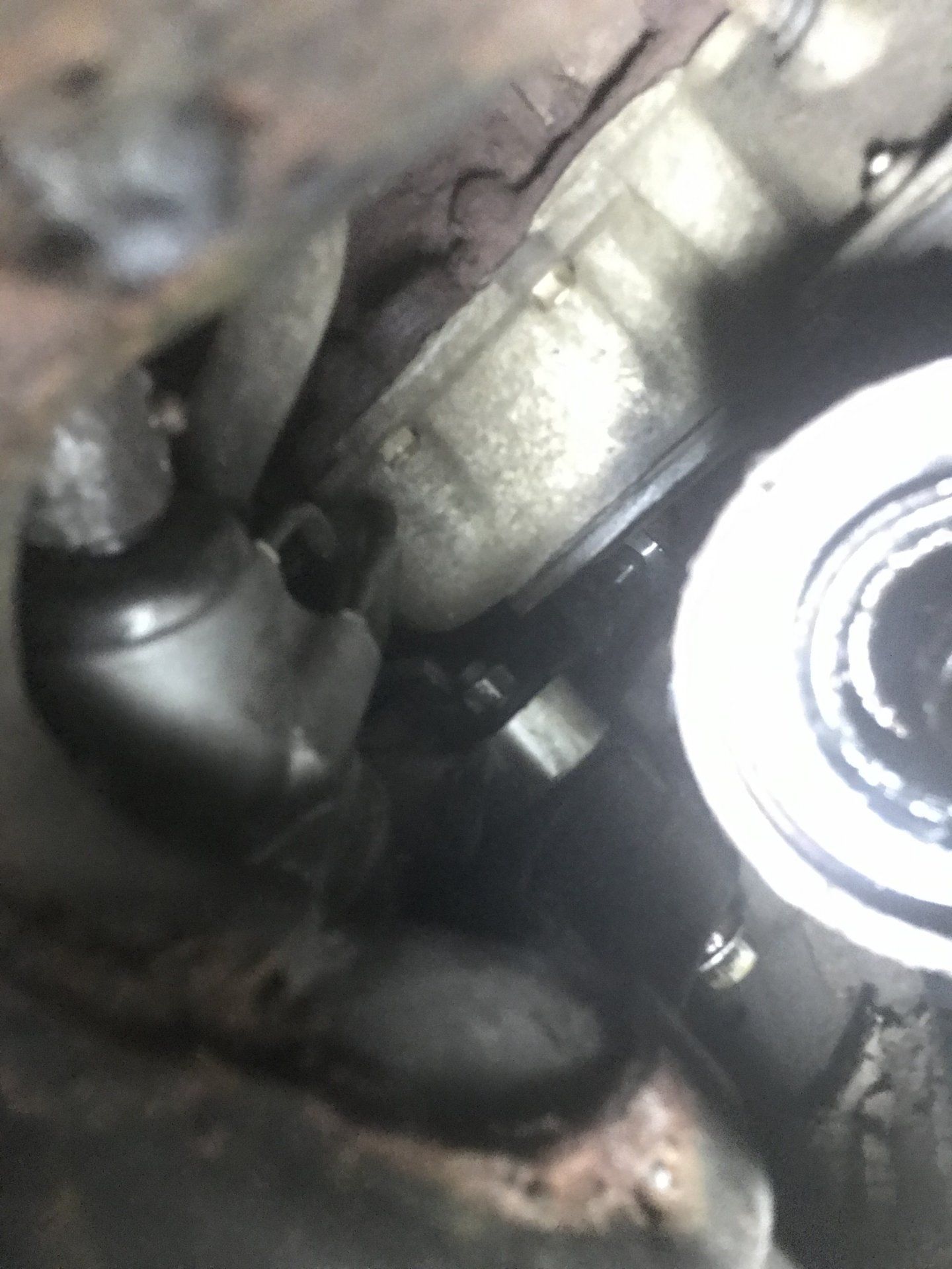

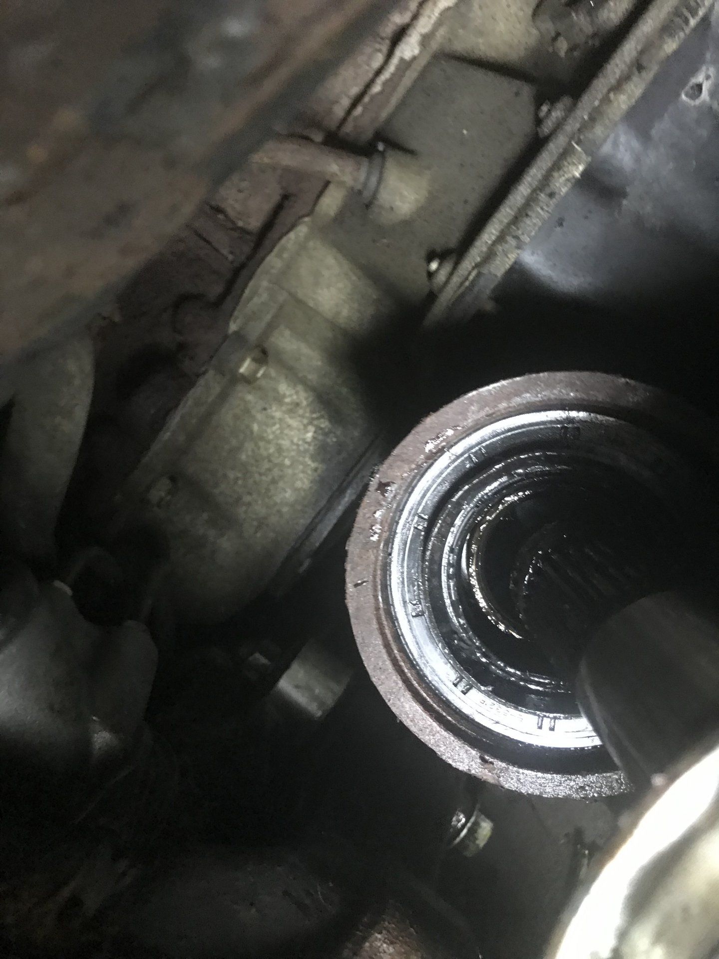

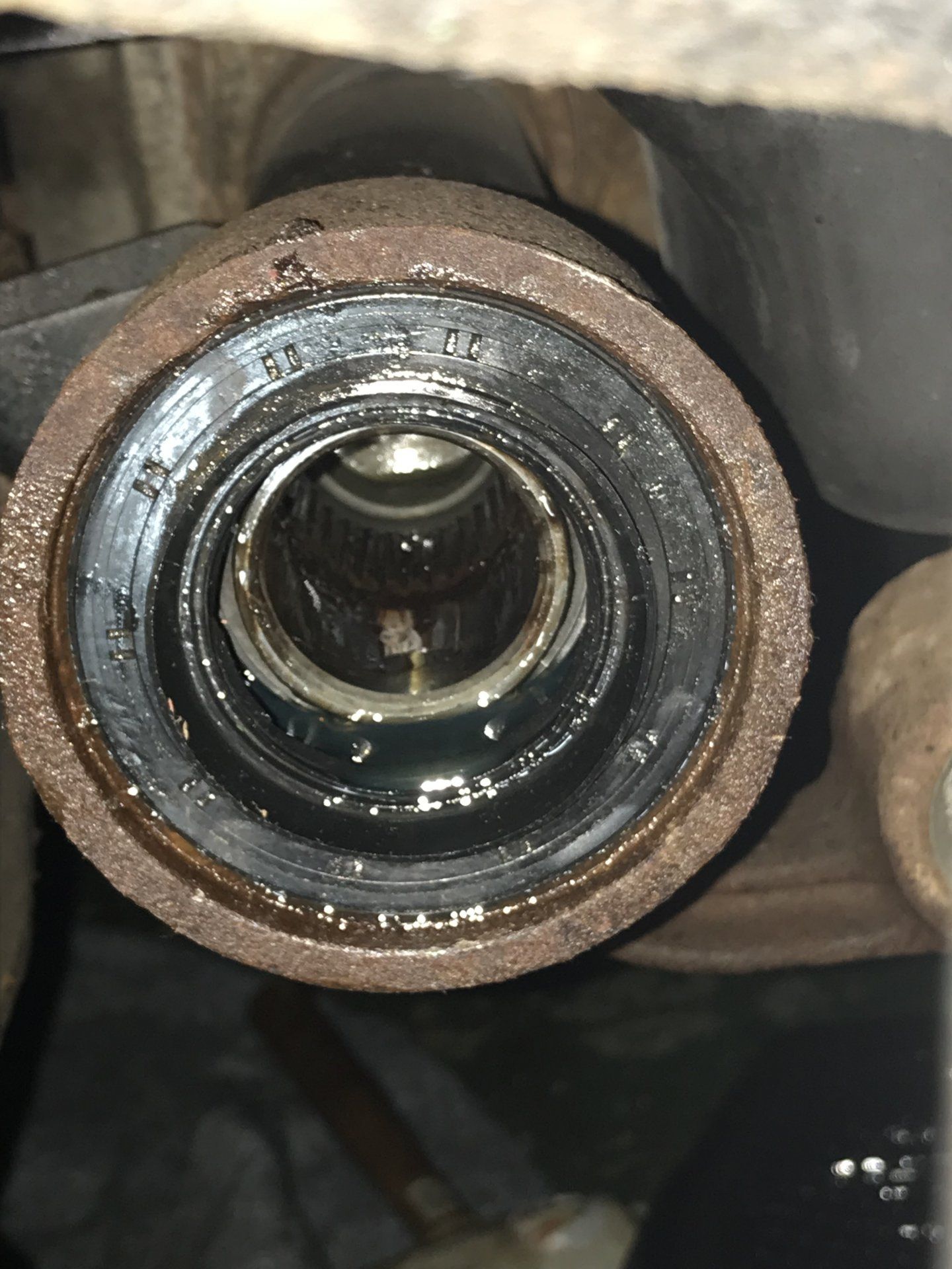

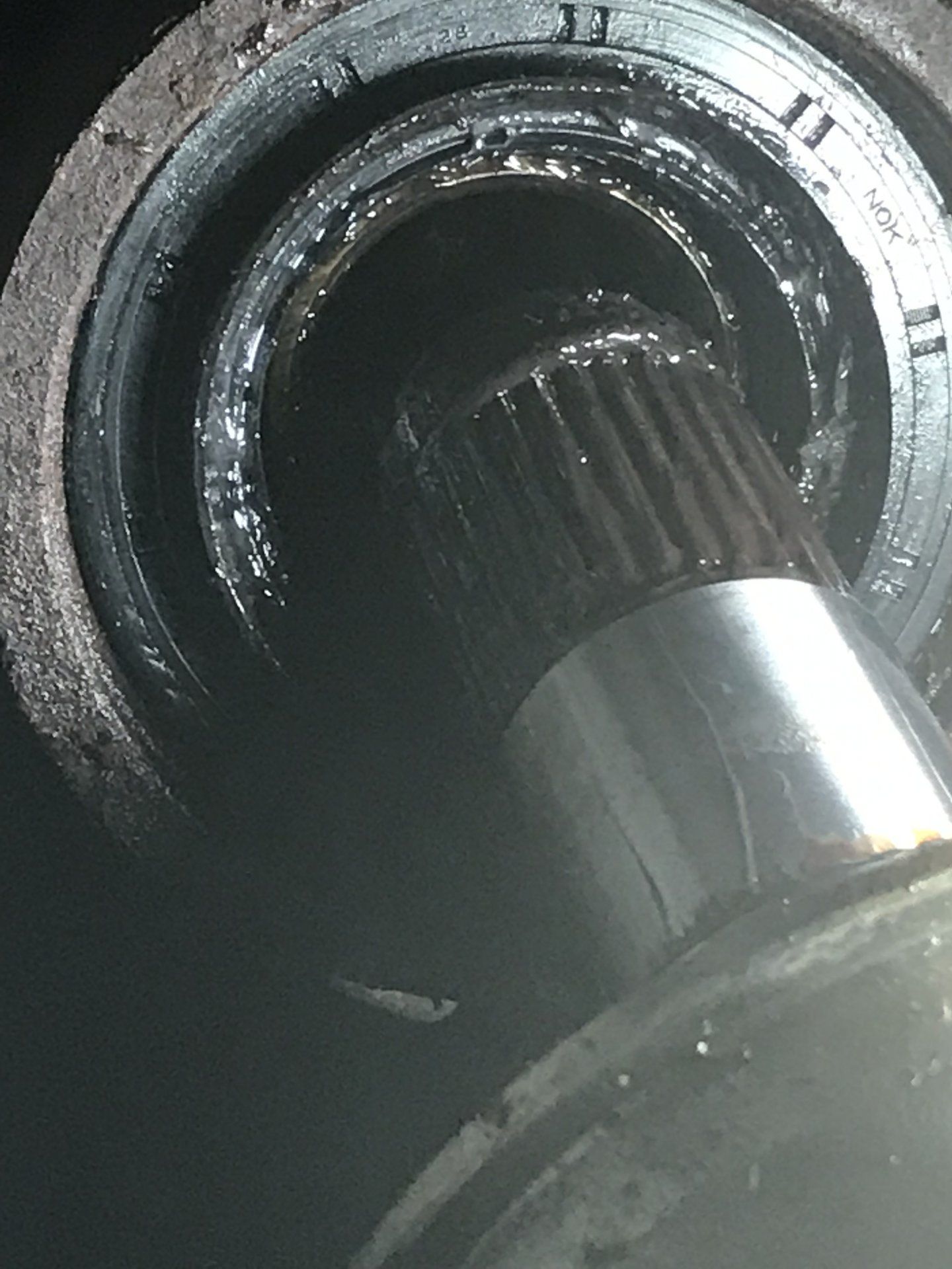

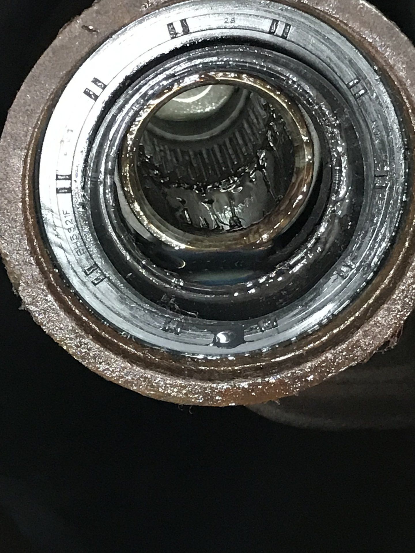

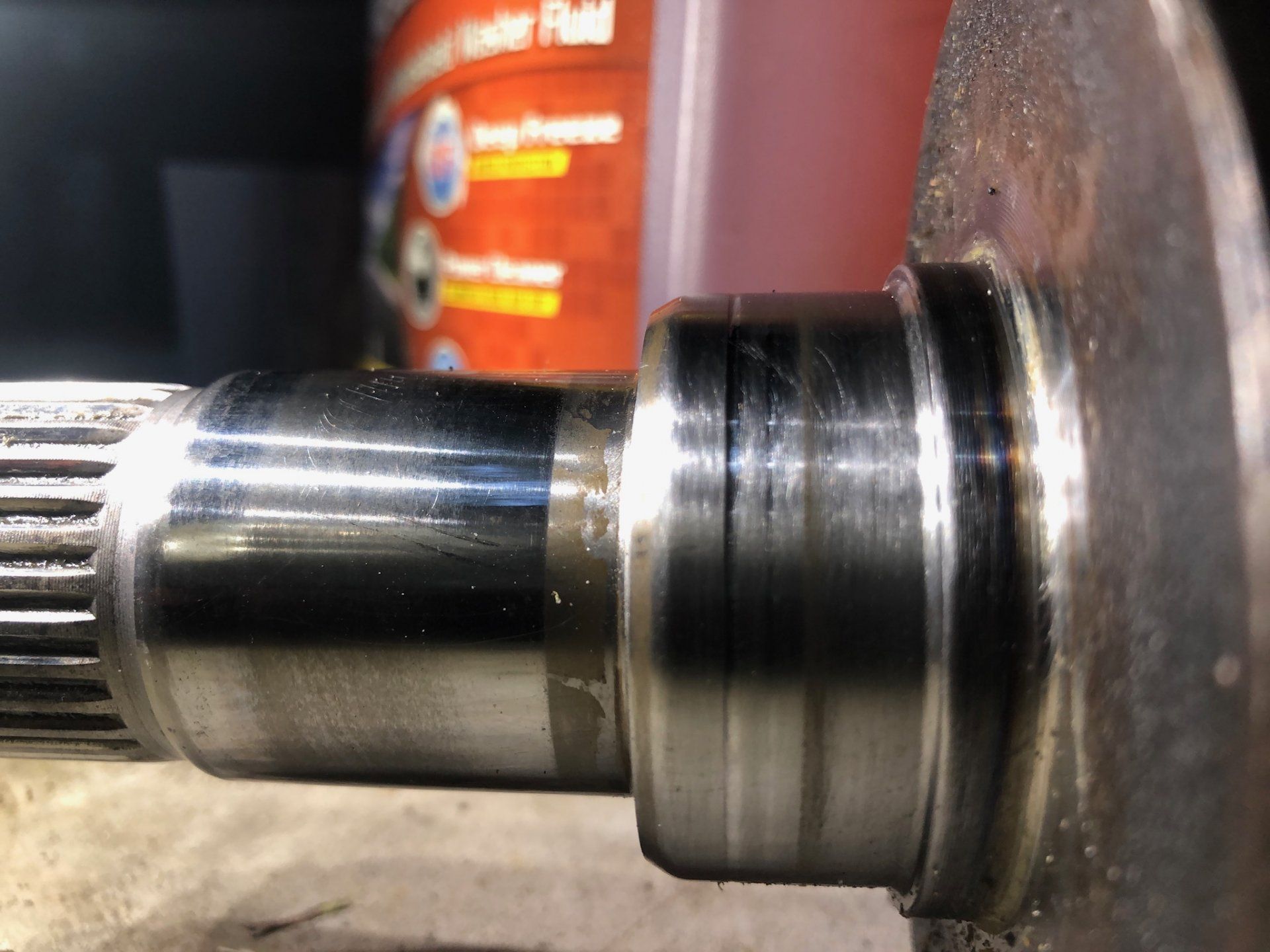

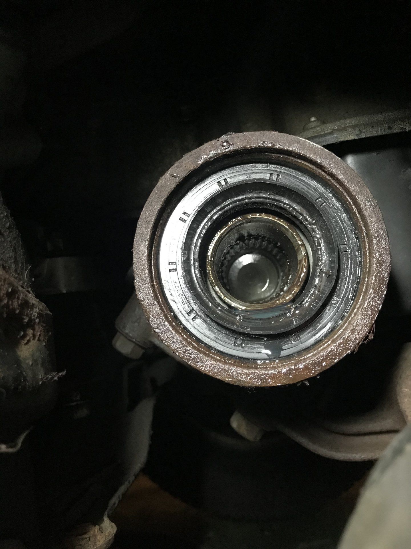

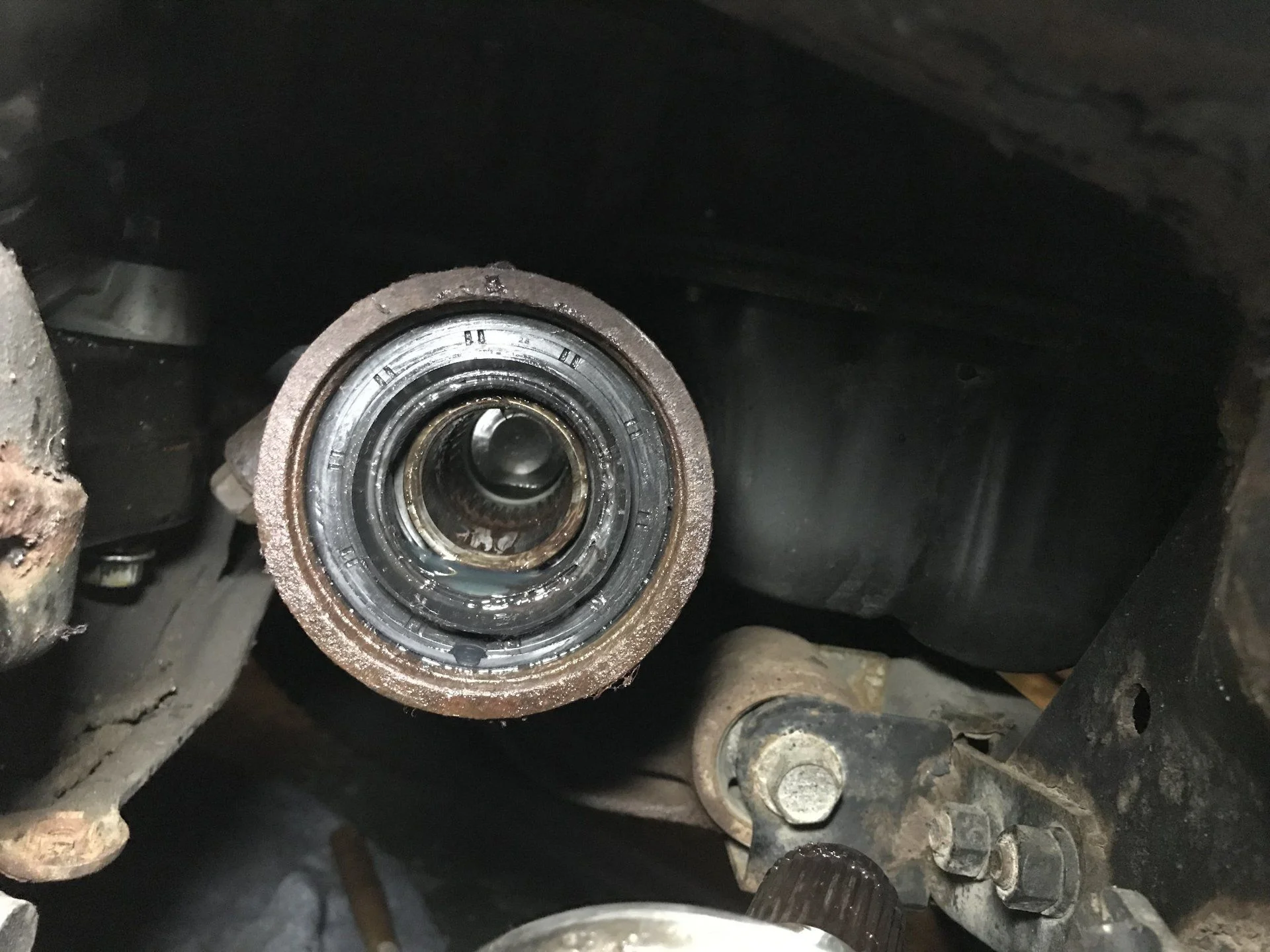

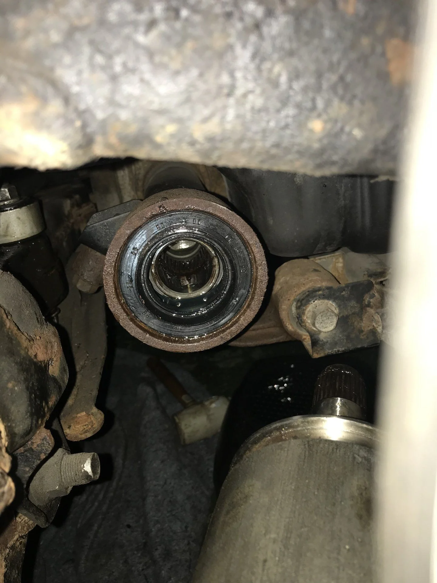

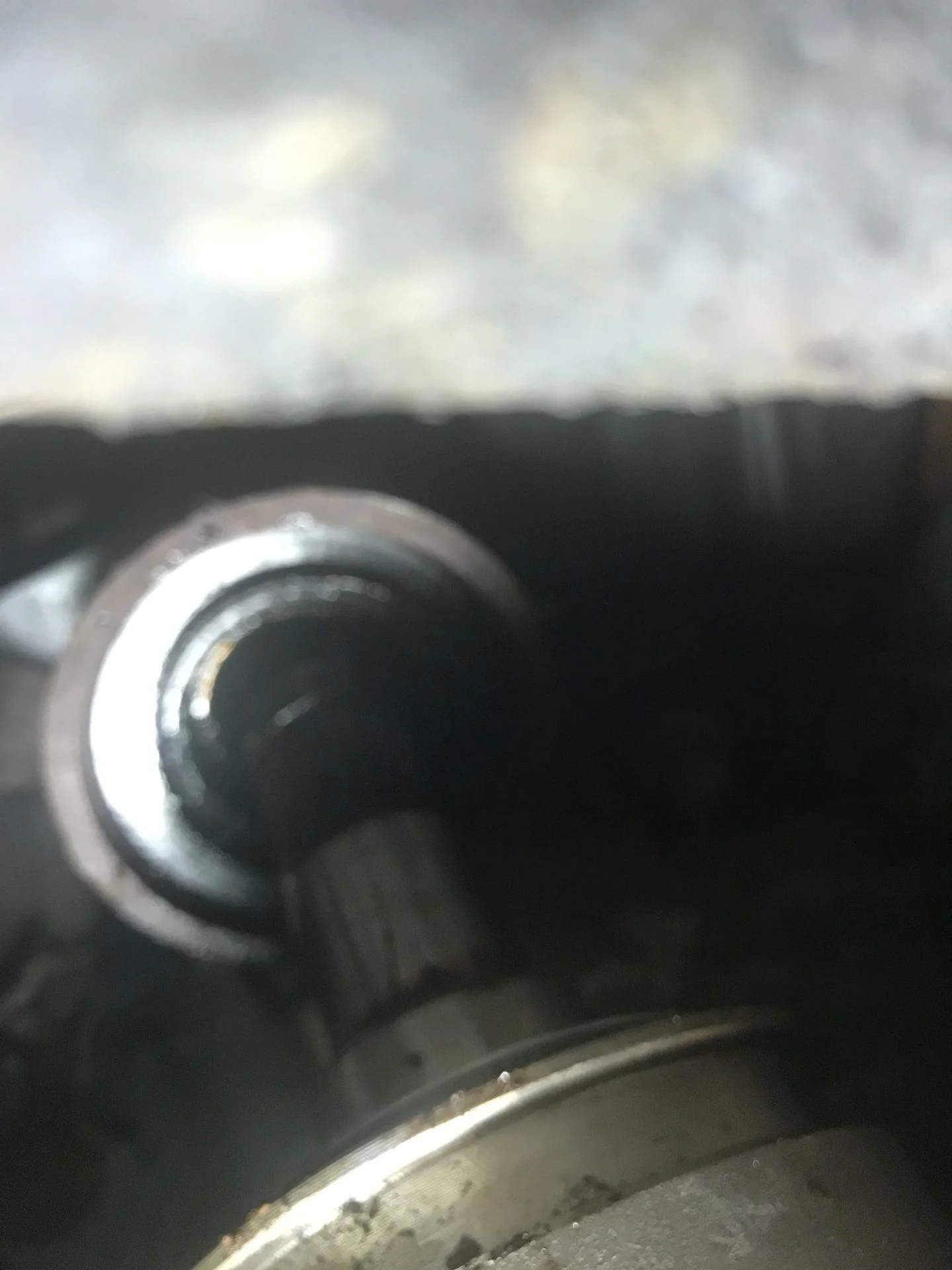

take some close up pictures of the seal before you remove it and post it. let's see if we can't identify the problem. especially how deep you installed it and the condition of the inner sealing surface to the axle shaft. should probably take a picture of the axle shaft itself too. maybe we can identify something

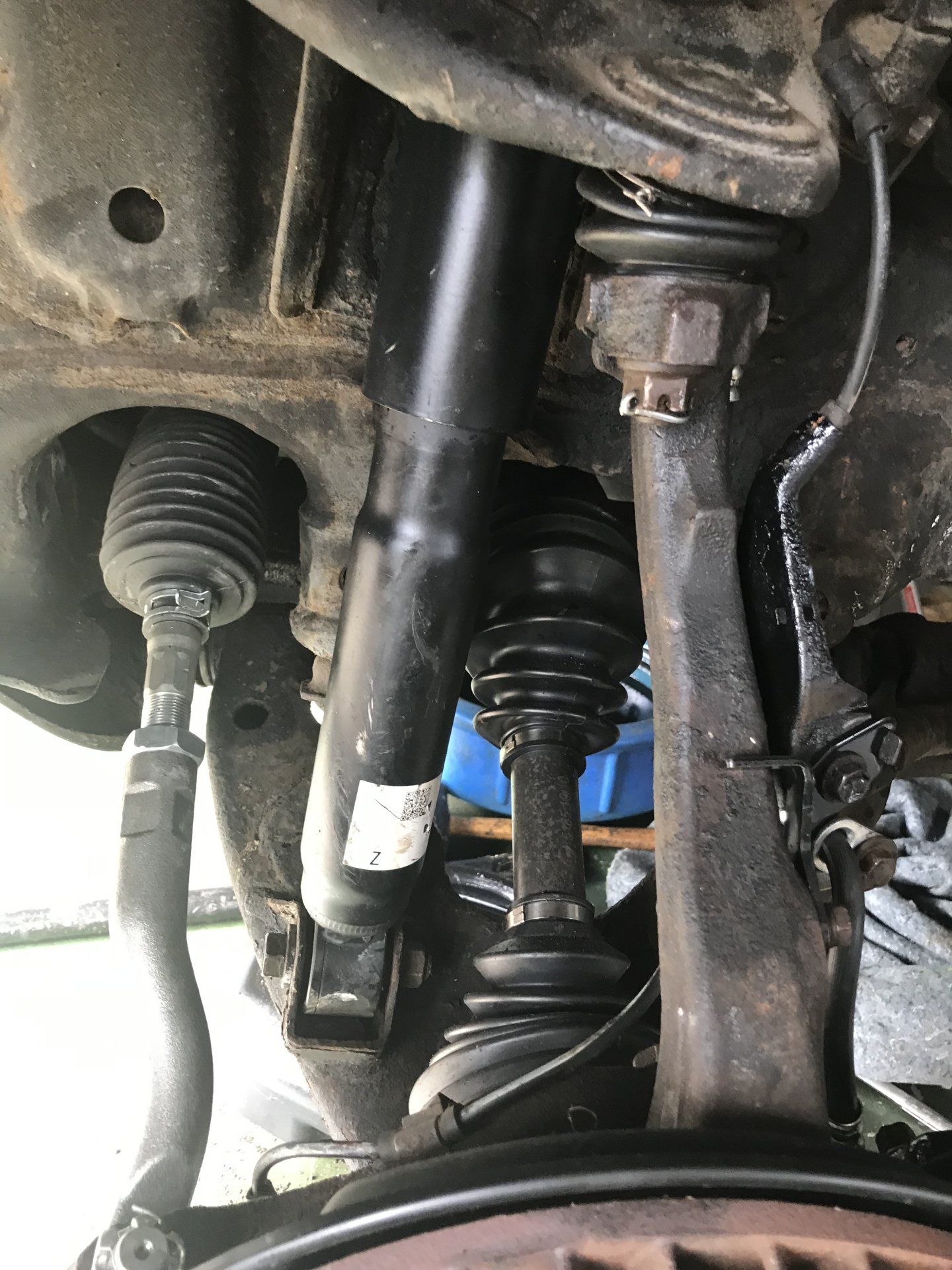

Need to disconnect lower shock bolt to free the cv fully. Looks like the bottom of the seal is pushed in a bit. Sorry for bad pics.
So after some gentle prying I have the seal flush with inner lip. Just how finicky are these seals? I am having a beer and will go out and check to see if there is any diff oil seeping at the bottom of the seal. The replacement seal is from NAPA, and I’m hoping I don’t need to try it. Thebseal in there now is a new oem seal, I think it just got bumped out of place on original install.
I'm sorry if i missed it earlier, do you have oem CVs?
i don't see anything wrong from the detail of the photos. the camera flash washes out a lot of detail though. i can't really see the sealing surface if there is any damage. your previous pics seem to indicate you were using the quick method to remove shaft which is possible to damage seal as you try to remove and install axle. but i don't see anything obviously wrong.
again. take a pic of the CVs especially the sealing surface where the seal rides.
aftermarket CVs may cause leaking and there's nothing you can do because they're the wrong size on the sealing surface.
