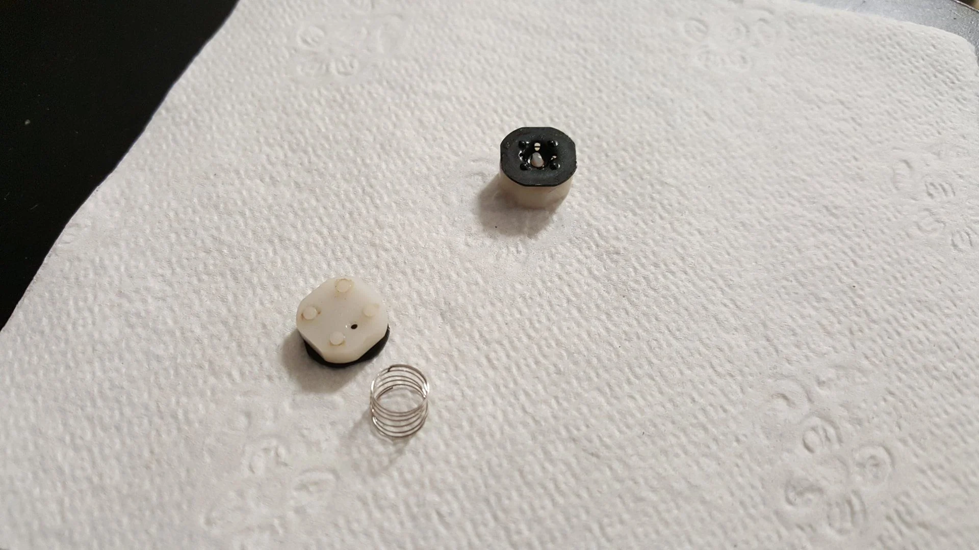

I have 2 of these although they don't look like valves. They have holes and pegs all over them that seem like they would not seal against the master or the nut that holds them in. The one from under the front line had a tangled up spring which I will fix and re-install.

On the residual valves they're designed to not seal up the port, rather they slowly allow the fluid back into the reservoir(s) at a metered pace as the calipers/pistons retract. It does sound like you might've accidentally swapped em during the rebuild, but I'd also check the booster rod while you're at it. I wish I could tell you which of those is the front disc valve but I'm sure someone on here can.
I ran out of time to bleed them and test. I ended up swapping the valves. I pushed them together to try to figure out which had the most spring pressure and put that one in the rear line. It was hard to tell but I will see if it helps tonight.
