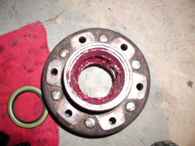

Pack the inside of the axle hub with grease (Should have been cleaned prior to this).
Pack the inner and outer bearings with Grease per the instructions used for the Trunnion bearings. These bearings are typically re-used unless after they are clean you notice damage.
Install the inner bearing into the hub and then install a new oil seal onto the hub. Coat the oil seal with grease

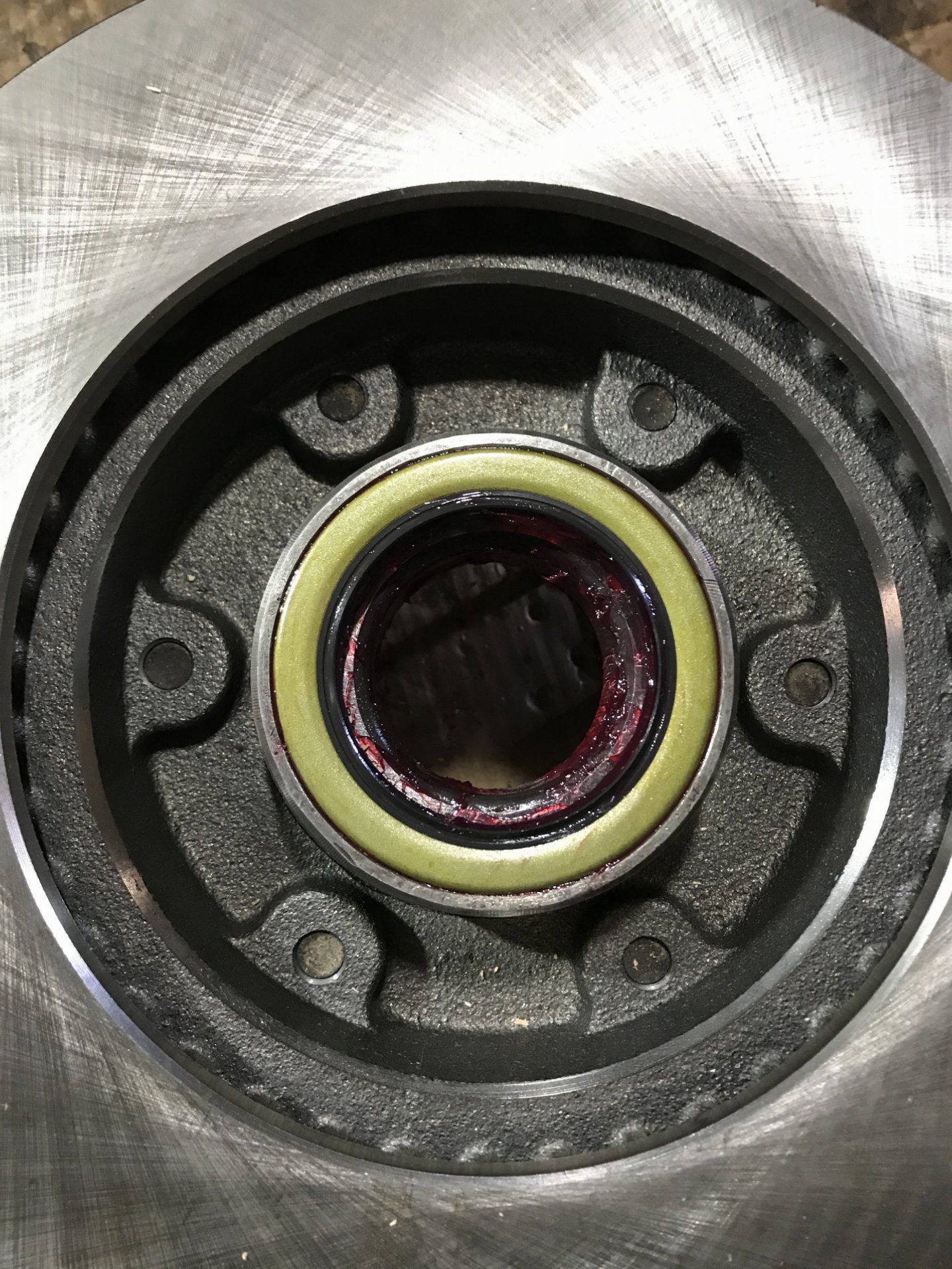

First time doing this...How far in should the new oil seal be driven? Flush with the top of the hub (as pictured) or in so it is flush with the surface of the rear bearing?
How much further back to the bearing? My uneducated guess is to the lip of the hub, but most everything is designed to seat against the bearings in most instances. I don't recall what I did, so basically this is just a bump to your question :banana:

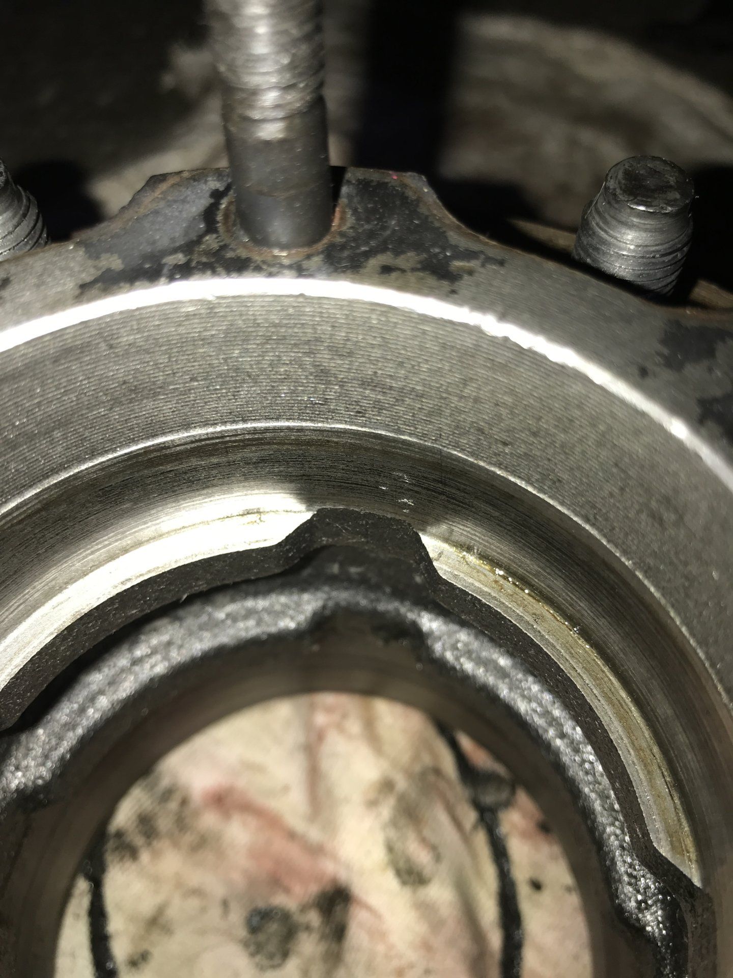

I made a rookie mistake and used an overly aggressive angle with my drift while removing the wheel bearings and managed to knick the bearing seat a few times. I can feel dings and a slight mushroom around them. I was more careful on the rotor side and didn’t have any damage.
My question is, can I still seat the bearing or will it deform around these dimples and cause me issues? I had considered using either 400 grit sandpaper on a wooden dowel or a fine grit honing stone to try to smooth out the high spots but want to check with people more experienced before I cause more damage.
